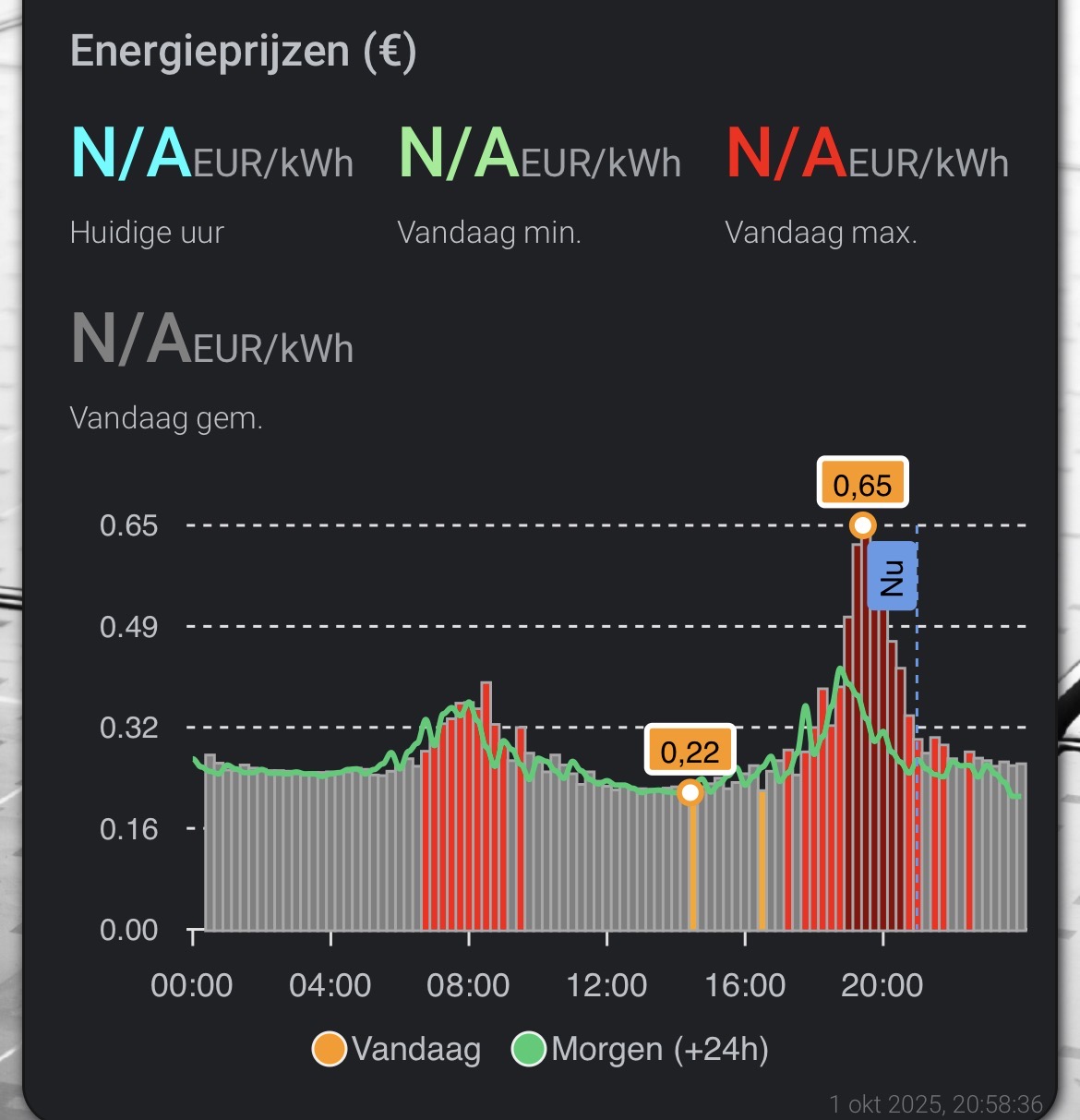

I using this version of Apexchart in combination with nordpol. Since the last 15 min data update the top values are on N/A dispite that the attribute current_price exists.
        - entity: sensor.nordpool_kwh_nl_eur_3_10_0
          attribute: current_price
          color: cyan
          group_by:
            duration: 1d
          show:
            in_chart: false
            legend_value: false
          yaxis_id: labels
Any idea?
Sensor issue. Look at your Nord Pool integration issues for further information.
Funny thing, today it is working again :wink:
nordpool connectivity has been quite spotty for me as of late. In frustration I have removed using current price (+high and low) sensors and others from nordpool that get updated hourly, etc and have gone instead to extrapolating it from the daily data dump.

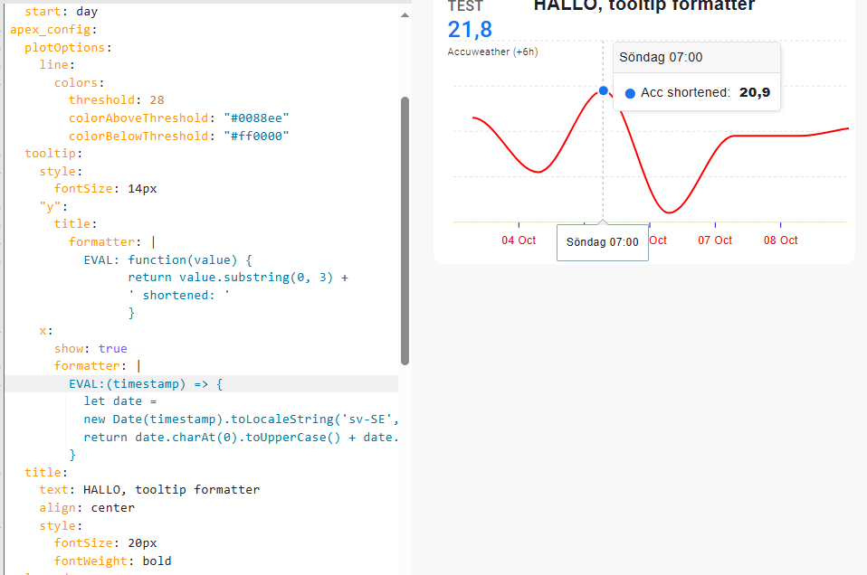

is it possible to make the entity name shown on mouse hover to be shorter or even not shown:
Long entity names render this window pretty unusable in mobile devices especially.
  tooltip:
    y:
      title:
        formatter: |
          EVAL: function(value) {
                return value.substring(0, 8) + ': '
tooltip – ApexCharts.js

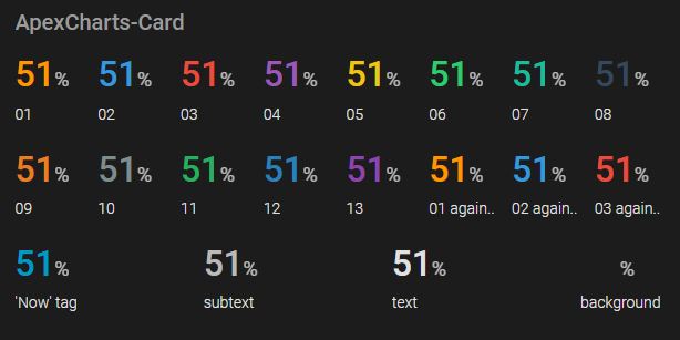

so I typically use the standard / default colors and made a table of them to access quickly which I thought someone else may have use of, so I am posting it here as i have never found this list and using text names of colors (eg “blue” or “green” ) will not give you any of the blues below but some other color palette :S – anyway :
ID Color Hex RGB
01 Light Orange #FF9800 rgb(255,152,0)
02 Light Blue #3498DB rgb(52,152,219)
03 Red #E74C3C rgb(231,76,60)
04 Light Purple #9B59B6 rgb(155,89,182)
05 Yellow #F1C40F rgb(241,196,15)
06 Green yellow #2ECC71 rgb(46,204,113)
07 Green blue #1ABC9C rgb(26,188,156)
08 Dark Gray #34495E rgb(52,73,94)
09 Orange #E67E22 rgb(230,126,34)
10 Gray #7F8C8D rgb(127,140,141)
11 Green #27AE60 rgb(39,174,96)
12 Blue #2980B9 rgb(41,128,185)
13 Purple #8E44AD rgb(142,68,173)
“Now” tag lighter blue #009AC7 rgb(0,154,199)
subtext light gray #BABABA rgb(186,186,186)
text lighter gray #E1E1E1 rgb(225,225,225)
background darker gray #1C1C1C rgb(28,28,28)
** ## in order of entities added - 01 is the 1st entity added, 13 is the 13th @14 the colors repeat.
I use this as I like that the colors are standard as it is easy but as I have progressed I find they sometimes they are in the wrong order (eg different colors between charts for the same values on the same page) and a pain to move as things go screwy or I have some colors I have decided always mean a certain thing (eg historical data to be a light gray (10) or similarly sma’s are the same color but dashed width depending on sma span and transparent lighter version #opacity, etc, etc…).

This does not seem to do anything, apexcharts-card doesn’t include tooltip in it’s documentation but apexcharts.js has…maybe there is no support in card?
I sent the code to have a substring of the name … and you deviate…

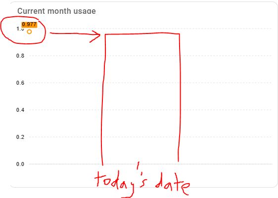

anyone knows how to solve apexchart with 1d span? my entity is a daily increasing utility meter, and based on my code below, i should expect a column to appear center, but instead i get a dotted value appearing on far left. what is wrong with my code?

sorry. here is what i meant:
sensor.aircond_today_s_consumption is type total_increasing and my graph_span is a growing dynamic value. Result is not what i expect if graph_span is <= 3d.

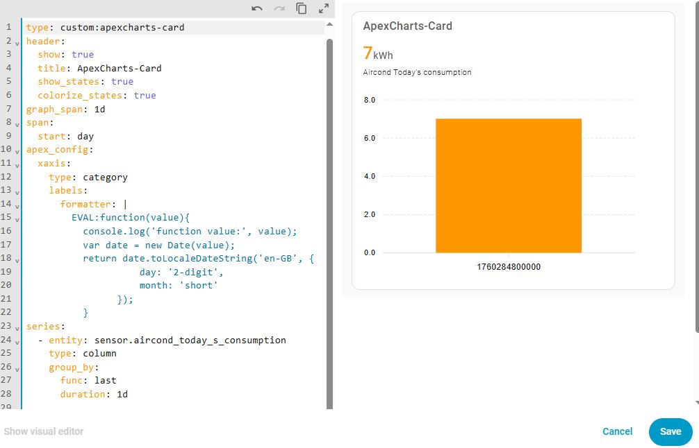

xaxis type: category works but the formatter doesnt. In my browser’s console, i can only see value = 0.
type: custom:apexcharts-card
header:
  show: true
  title: ApexCharts-Card
  show_states: true
  colorize_states: true
graph_span: 1d
span:
  start: day
apex_config:
  xaxis:
    type: category
    labels:
      formatter:
        EVAL:function(value){
          console.log('function value:', value);
          var date = new Date(Number(value) * 1000);
          return date.toLocaleDateString('en-GB', {
                    day: '2-digit',
                    month: 'short'
series:
  - entity: sensor.aircond_today_s_consumption
    type: column
    group_by:
      func: last
      duration: 1d

please advise how can i get xaxis to work correctly?
tbh, I am quite surprised myself, have not seen this before. Without even setting any x-axis config, it displays 15 oct (also with me on various sensors). It is so basic in its setup so it should work. I can only get the 13th back in the picture by changing span stuff but one should be able to show only today. I even checked if this was related to recent releases of HA (almost never related but this is so weird).
I would raise an issue here; Issues · RomRider/apexcharts-card
