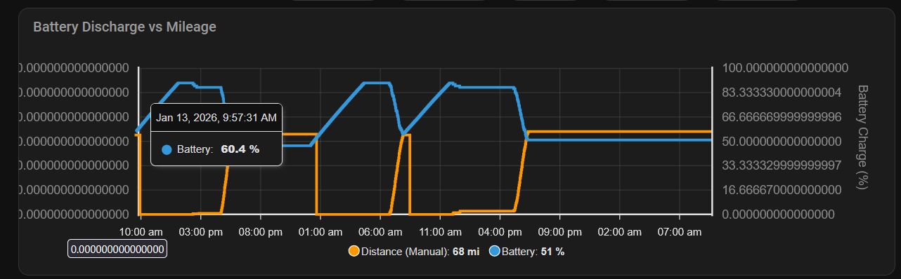

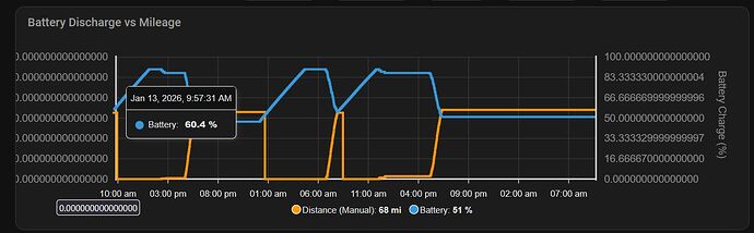

Is there a way to make the y-axis label integers (or at least limit all these decimal places)?
layout_options:
  grid_columns: 10
experimental:
  disable_config_validation: true
type: custom:apexcharts-card
header:
  show: true
  title: Battery Discharge vs Mileage
apex_config:
  chart:
    height: 250
  stroke:
    width: 3
    curve: stepline
  grid:
    strokeDashArray: 0
    borderColor: rgba(150, 150, 150, 0.2)
    xaxis:
      lines:
        show: true
    yaxis:
      lines:
        show: true
  yaxis:
    - id: left-axis
      opposite: false
      min: 0
      max: 120
      title:
        text: Distance (miles)
        style:
          fontSize: 14px
          fontWeight: normal
          fontFamily: Arial
          color: "#888"
      labels:
        style:
          colors: "#888"
          fontSize: 14px
          fontFamily: Arial
          fontWeight: normal
      axisBorder:
        show: true
        color: "#e0e0e0"
        width: 2
    - id: right-axis
      opposite: true
      min: 0
      max: 100
      title:
        text: Battery Charge (%)
        style:
          fontSize: 14px
          fontWeight: normal
          fontFamily: Arial
          color: "#888"
      labels:
        style:
          colors: "#888"
          fontSize: 14px
          fontFamily: Arial
          fontWeight: normal
      axisBorder:
        show: true
        color: "#e0e0e0"
        width: 2
  xaxis:
    axisBorder:
      show: true
      color: "#e0e0e0"
      height: 2
update_interval: 30s
graph_span: 48h
series:
  - entity: sensor.volvo_ex30_trip_meter_automatic
    yaxis_id: left-axis
  - entity: sensor.volvo_ex30_battery_charge_level
    transform: "return (x === '0.0') ? null : x;"

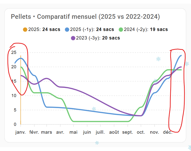

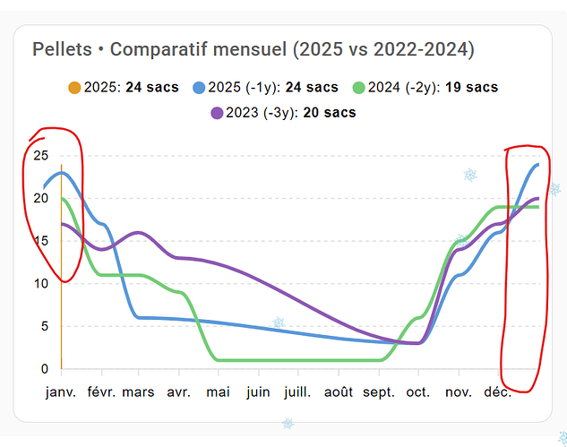

Hi everyone
I’m having some issues using ApexCharts.
I’m trying to make a charts over the last 4 years of wood consumption
As you can see on the picture the date for january is hidden behind y axis
And there is such strange data from a thirteenth month
graph_span: 1y
span:
  start: year
I just started to use ApexChart so if someone can just let me know what i’m doing wrong.
Alos do you think it’s possible to start the year on september instead of January ?
Thanks for your help
Here is the full code of my card
header:
  show: true
  title: Pellets • Comparatif mensuel (2026 vs 2023-2024)
graph_span: 1y
span:
  start: year
now:
  show: false
series:
  - entity: sensor.pellets_sacs_total
    type: column
    color: "#F39C12"
    statistics:
      type: change
      period: month
      align: start
    type: line
    color: "#3498DB"
    stroke_width: 3
    offset: "-1y"
    statistics:
      type: change
      period: month
      align: start
    type: line
    color: "#2ECC71"
    stroke_width: 3
    offset: "-2y"
    statistics:
      type: change
      period: month
      align: start
    type: line
    color: "#9B59B6"
    stroke_width: 3
    offset: "-3y"
    statistics:
      type: change
      period: month
      align: start
apex_config:
  legend:
    show: true
    position: top
    onItemClick:
      toggleDataSeries: true
    onItemHover:
      highlightDataSeries: true
  tooltip:
    shared: true
    intersect: false
  xaxis:
    tickAmount: 12
    labels:
      format: MMM
      rotate: -30
      hideOverlappingLabels: false
      showDuplicates: false
  plotOptions:
    bar:
      columnWidth: 100%

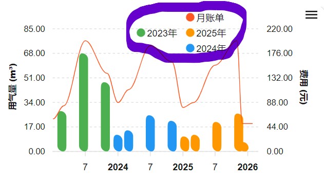

How can I display the legend in a single line?

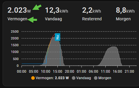

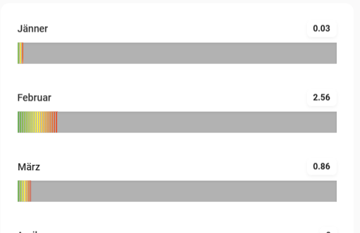

I would like my headers to have the same size as all my other text on the dashboard. Now it looks very out of sync.
I tried the card mod below, and I can see it has impact op the font size for the state value and state name. However, they are still different in size and larger than all the other text on my dashboard.
Can someone point me to what is additionally scaling these boxes?
card_mod:
  style: |
    #state__value {
      font-size: var(--ha-font-size-m) !important;
      font-weight: var(--ha-font-weight-m) !important;
    #state__name {
The upper tekst is state__value, the lower is state__name

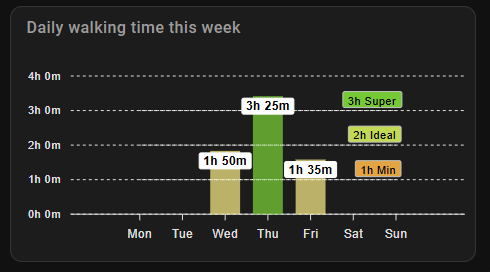

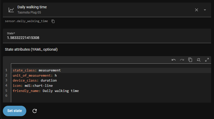

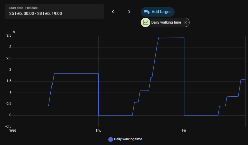

Hi all, I’d love some help with a data_generator, I’ve spent hours on this and either I’m not getting it, or what I want to achieve is impossible!
I have a sensor that logs the daily incremental power consumption of a smart plug, resetting every day, which I use it to keep track of my walking pad usage. It’s a template Statistics sensor that looks like this:
I’ve managed to create an ApexChartsCard showing the daily max (so total daily time) as a bar chart:
Bar chart YAML code
`type: custom:apexcharts-card
grid_options:
columns: 12
apex_config:
xaxis:
type: datetime
labels:
format: ddd
chart:
height: 200px
dataLabels:
enabled: true
style:
colors:
- “#FFF
background:
borderWidth: 1
opacity: 1
foreColor: “#000
borderColor: “#FFF
formatter: |
EVAL: (x) => {
if (x>0)
return Math.floor(x) + "h " + Math.round((x-Math.floor(x))*60) + "m ";
annotations:
yaxis:
- “y”: 1
borderColor: “#fff
label:
text: 1h Min
borderWidth: 1
style:
color: “#000
background: “#f2a134
- “y”: 2
borderColor: “#fff
label:
text: 2h Ideal
borderWidth: 1
style:
color: “#000
background: “#bbdb44
- “y”: 3
borderColor: “#fff
label:
text: 3h Super
borderWidth: 1
style:
color: “#000
background: “#44ce1b
experimental:
color_threshold: true
graph_span: 1w
span:
start: isoWeek
header:
show: true
title: Daily walking time this week
series:
  • entity: sensor.daily_walking_time
    type: column
    opacity: 0.75
    group_by:
    func: max
    duration: 1d
    fill: zero
    show:
    datalabels: true
    header_color_threshold: true
    as_duration: hour
    color_threshold:
    • value: 2.5
      color: “#44ce1b
    • value: 2
      color: “#bbdb44
    • value: 1.5
      color: “#f7e379
    • value: 1
      color: “#f2a134
    • value: 0.5
      color: “#e51f1f
      yaxis:
  • min: 0.001
    max: 4
    decimals: 0
    apex_config:
    tickAmount: 4
    stepSize: 1
    forceNiceScale: true
    labels:
    formatter: |
    EVAL: (x) => {
What I’d like to do is to show the same data but on a weekly bases, so I need to aggregate the daily max by week. I thought it wouldn’t be too hard using data_generator, but I can’t for the life of me figure out how to access the sensor data as a series (timestamp, state) so I can do the aggregation in Javascript and then rebuild the series to be used by the chart.
Every example and documentation I found for data_generator seems to imply the historical data is in one of the attributes, but as you can see above this is not the case here. I’ve tried with a simple console.log(entity) in the generator and all I can see is the current state (along with last changed and updated) and the static attributes above. No “data” or anything like that. Have I completely misunderstood the implementation?
BTW, I know I could create another sensor to store the daily max and aggregate that, as I could create one already aggregated per week. I could also (done that a bunch) create a SQL sensor to extract the aggregated data. I was looking for (if possible) a solution that could be implemented in the card and reused, without having to create other sensors. I have a whole bunch of use cases for many different sensors and I’d like to avoid creating many, many additional sensors.
Thank you!

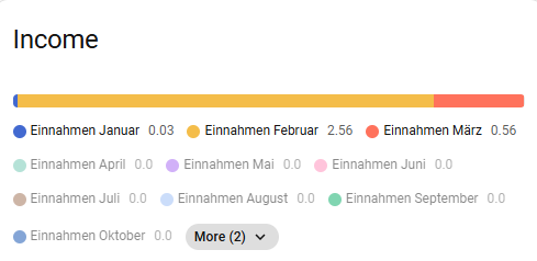

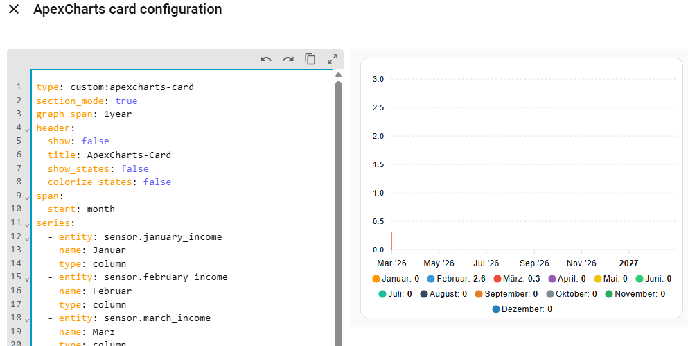

I am trying to implement the apexchart card for my solar income per monthn. I have a sensor for each month. Is it possible to have only one entity per column/bar?
Now if i use all my 12 sensors in series, it seems every month gets a bar for each sensor.
Also the columns/bars are very thin.
Sugges to have a look at data_generator option. You can get all your sensor values from hass.states object available in the javascript generator function. So roughly you would code up to match the date with the month’s sensor. You might be able to make this easier by creating a template helper to have your monthly sensor values as attributes, then you that as your entity in the series, making the data_generator a bit simpler as it would be mapping the attributes to datetime data points of the generator, if that makes sense.
oh, didn’t thought about goning so complex. Thought apex card could solve my task in heaving a graph with a bar for each month and assign a sensor to each bar.
Maybe there is another card which fits better for my task?
If you want just a distribution then perhaps the new stock distrubition card would be the simplest.
Sounds interessting. Is this card implemented in core version, because i do not have this card in my current version 2025.12.4
Frontend: 20251203.3
New in 2026.2
In general it does what i want. But i want to display this information as bars for each month in current year. A bar for each sensor. It could also be a card with one bar for each sensor and i give them a label.
I found a bar-card but this seems to have a bug when edit the yaml. This card would do what i want.
It is strange that so many complex cards exist but not such a simple vertical bar card. Saddly my skills are not high enought to build one of my own. Maybe some day.
Update
I could solve it with the linear-gauge-card
