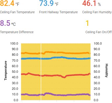

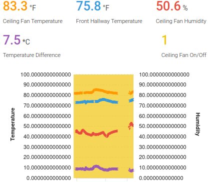

ApexCharts suddenly displays more than 10 significant digits crowding out graph
Been using ApexCharts for months. Suddenly (maybe after an upgrade) one of the charts displays axis values with about 16 digits past the decimal point. These long values are this way on both the left and right side of the chart. The chart is so crowed that it is difficult to see trends (only occupies about 30% of the card space). The number at the top of the card are display as expected. A value (temperature, humidity, ect) followed by 1 significant digit past the decimal point.

You have seen the image above where too many significant digits crowd out the graph. Here’s the same ApexChart after the code change:
Ah, I should add that I also had to make the same exact code change for the Humidity side of the chart so that the numbers on the right also contained a reasonable number of significant digits.

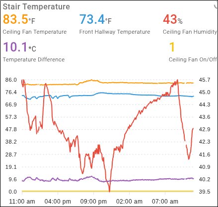

I looked at the examples in the link and think I have cleaned up the YAML. But in doing so, I’ve lost the labels on the left and right side of the graph. Which makes it hard to read. Also, I need to rethink how to display the state of the fan. I can’t believe I’m the only one who would like to over lay sensor data like temperature with the states of, say, the HVAC system.
YAML:
type: custom:apexcharts-card
header:
  show: true
  title: Stair Temperature
  show_states: true
  colorize_states: true
apex_config:
  legend:
    show: false
#   yaxis:
#     - id: first
#       title:
#         text: Temperature
#       decimalsInFloat: 1
#     - id: second
#       title:
#         text: Humidity
#       opposite: true
yaxis:
  - id: first
    decimals: 1
  - id: second
    decimals: 1
    opposite: true
all_series_config:
  stroke_width: 2
series:
  - entity: sensor.stairs_temperature
    name: Ceiling Fan Temperature
    yaxis_id: first
  - entity: sensor.nspanel1_temperature
    name: Front Hallway Temperature
    yaxis_id: first
  - entity: sensor.stairs_humidity
    name: Ceiling Fan Humidity
    yaxis_id: second
  - entity: sensor.stair_temp_diff
    name: Temperature Difference
    yaxis_id: first
  - entity: fan.stairs
    name: Ceiling Fan On/Off
    transform: "return x == 'on' ? 1 : 0;"
    type: area
    curve: stepline
    stroke_width: 0
    yaxis_id: first
This results in this HAOS panel:

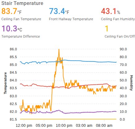

If I comment out the second “yaxis:” YAML code and uncomment the first, then I get this HAOS panel:
I get my left and right of the graph labels back. But the data is messed up. Near as I can tell, everything is now using the scale on the left (was expecting all temperature data and fan state to use the scale on the left) and the Ceiling Fan Temperature is using the scale on the right (was expecting it to use the scale on the left)
So I’m still looking for a solution for both the labels and for laying events over the plots of data.
