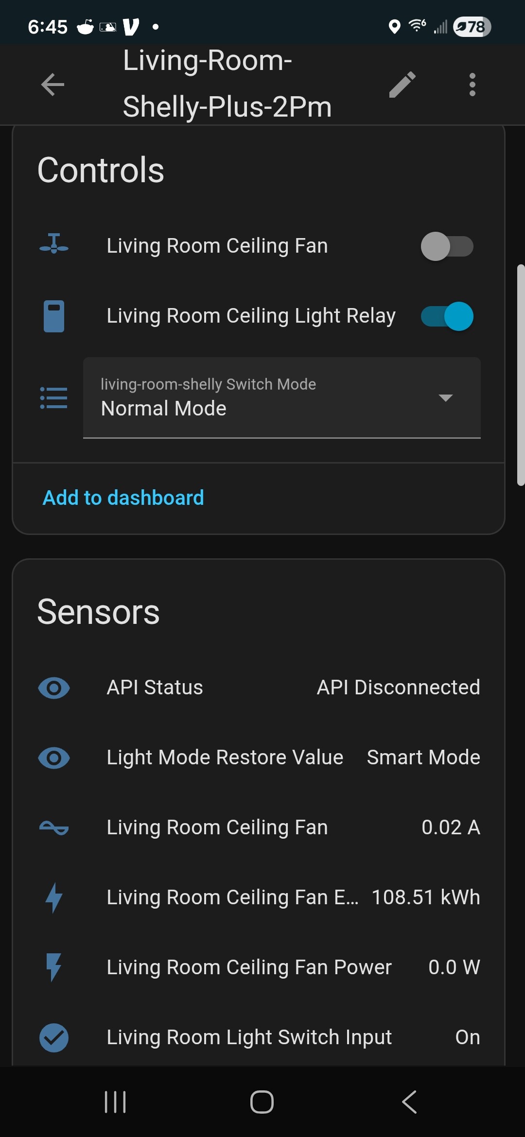

I have a shelly I want to switch to normal mode (aka switch directly controls the relay instead of the bulbs) when it’s disconnected from the API. The on_client_connected actions all work when the device first boots, but afterward, if the API disconnects, it does not run the on_client_connected actions again.
I am using this yaml:

I can still control the device with HA so I’m pretty sure the device isn’t still disconnected.

It’s not switching back to smart mode once the api connects again, so instead of the switch controlling the bulbs, it turns the relay on/off

I believe what is happening in the on_client_connected/disconnected is that when I go into, say the logs, it’s a connect/ disconnect, so when the log disconnects, it’s triggering the disconnect.
