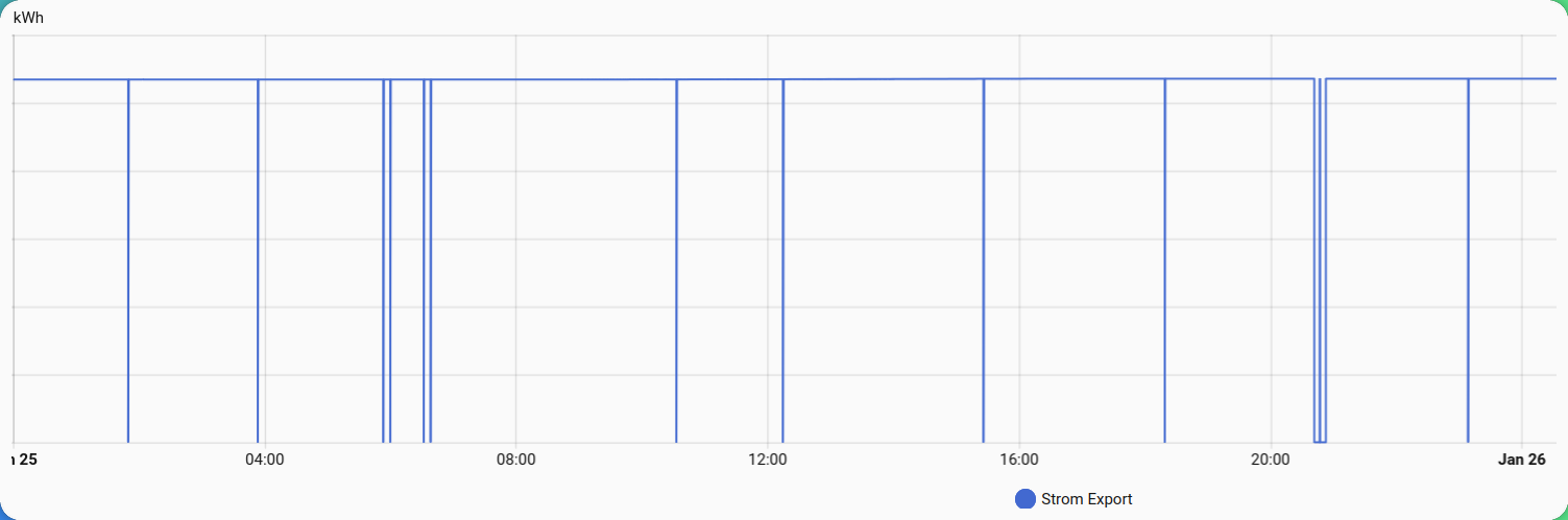

I have an issue with the reported solar export value in kWh. This value sometimes drops to ZERO. This results in heavy jumps in export values, when it is used in a helper defined as a utility meter for daily export values.
Is there an easy way to prevent this?
Or can the daily export value calculated by the add-on itself?
Maybe I am just doing stupit things.

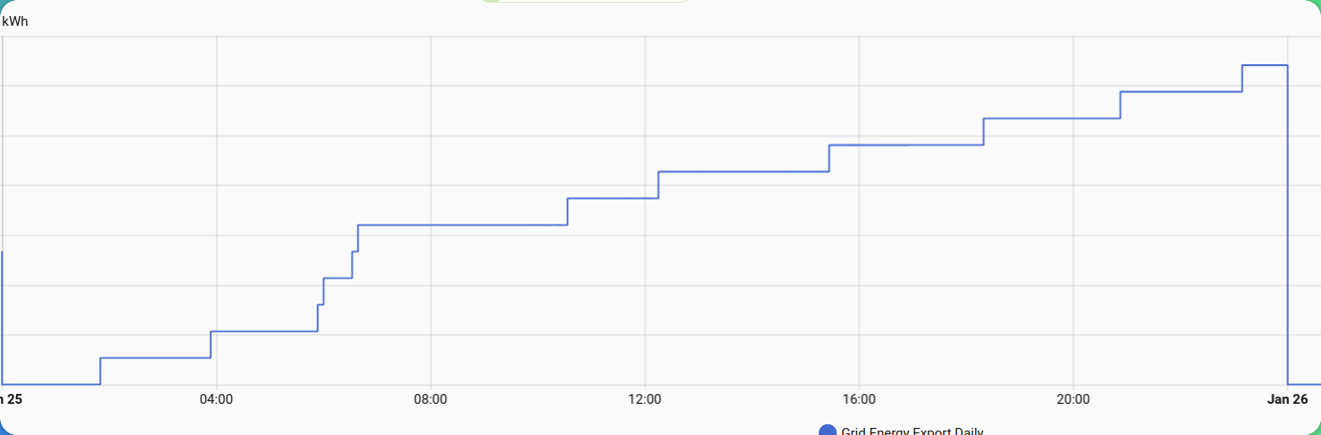

Here you see the frequent drops to ZERO.
Each time it seems the helper sees the restored value as a new happened export leading to absurd values for the daily export.

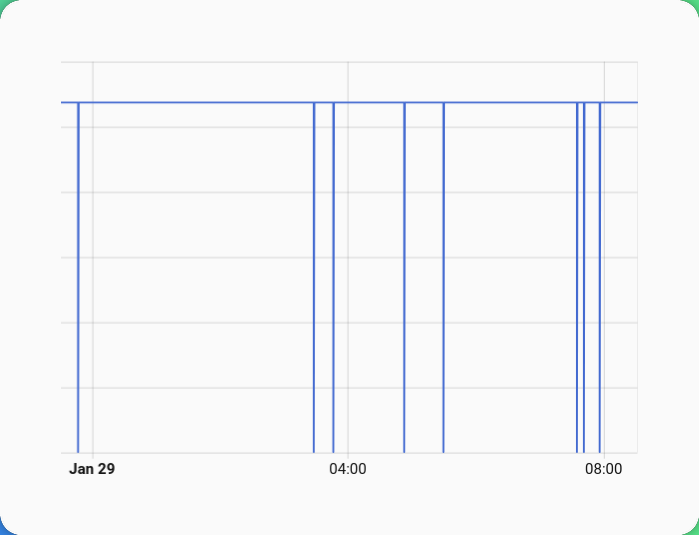

It has happened again overnight. Unfortunately the logs do not go all the way back to the time (e.g. 4 am) so how could I capture the log the best way?
The log in HA just covers the last minutes it seems to me.
Loglevel is set to DEBUG.
I have no means to trigger the error nor can I set next to the machine and wait for the error to happen.
So as of now, I can not provide the requested logs, or I just do not know how.
Can you tell me the register involved?
[Is it 37119?]
As stated above from other incidents, I have not seen any reported errors in the log and such.
It happens during the day randomly it seems.

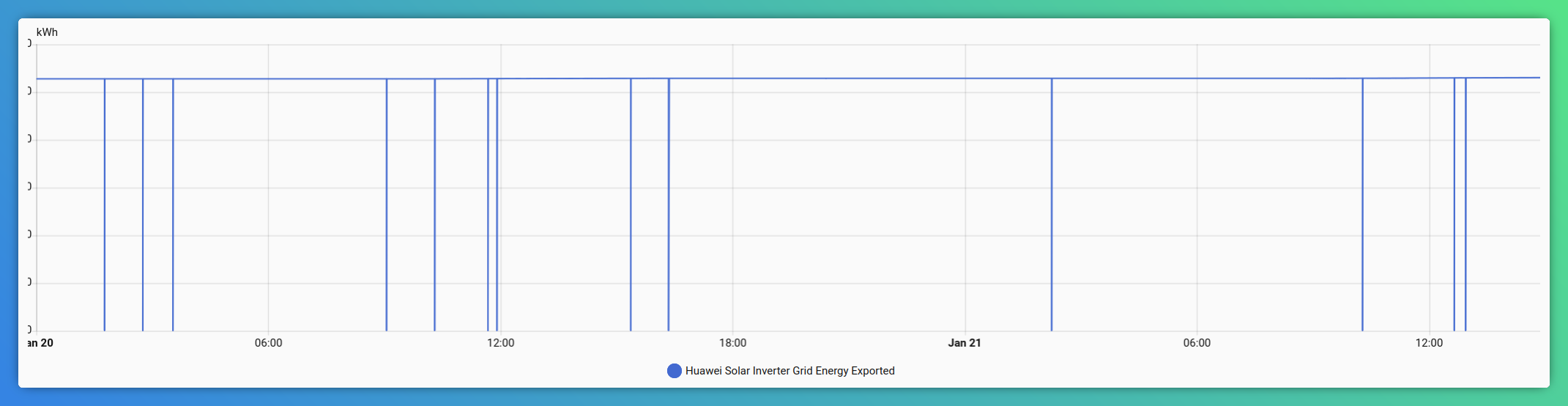

The only thing (today e.g), there was no such thing as a firmware update or any other event I am aware of. No meter change, no nothing, nor does it reset at night w/ no production (currently it still gives the reasonable number and not zero). At least the add-on does not give a zero here.
It happens randomly during the day. Today about three times.
From your knowledge, what other registers show that behavior as well?
Shouldn’t they show the same thing and ZERO out at such an event?
I could then go and double-check.
Maybe a pattern will emerge.

Cool. I did not expect the update so fast.
Tiptop.
I did not come around to fiddle with my setting more this weekend, so I went ahead and installed just the update.
Now, I am curious what will happen with the counter.
Yesterday was no good day for counting the export as it had many jumps:
Due tothe export parameter visiting the ZERO mark quite frequently yesterday:
But I hope these jumps become a thing of the past.
Too bad that I have caught yet the right log of such incident as I am curios what’s really at work.
Cheers,
HANT

Issue is still there
Back to the issue here w/ the ZERO drops [sensor.huawei_solar_inverter_grid_energy_exported].
Unfortunately, they still happen quite frequently for me:
Running the latest 1.6.1 version currently.
Thanks,
HANT
