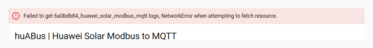

But this still happens to me when I stay in the log tab of the add-on for a little while:
Reloading is fine though.

Regarding the “Failed to get /addons/…” error: This is a known Home Assistant frontend issue that occurs when you stay on the log page for an extended period. The Supervisor API times out. This is not related to the add-on itself – as you’ve already noticed, everything works fine after a reload.

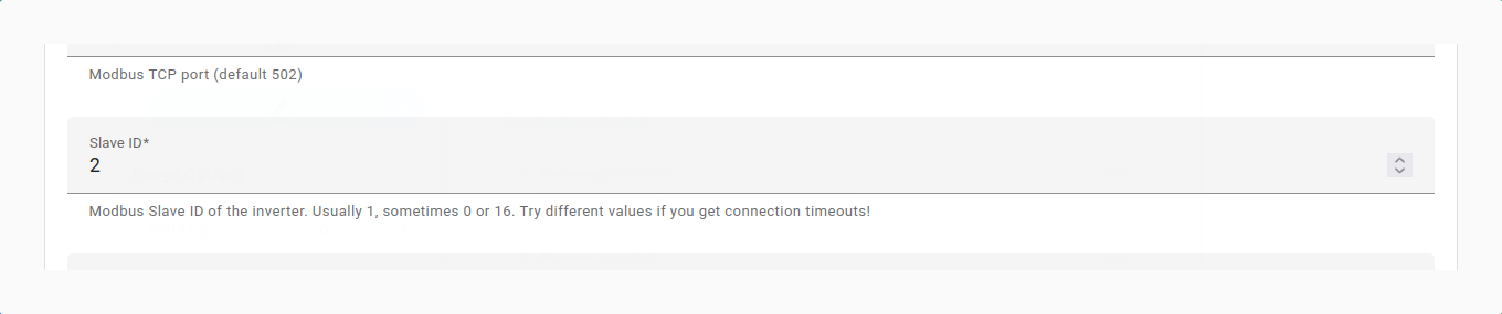

Running confing vs. config tab
I noticed one thing. Not sure if it relates to this add-on specifically.
I was playing around w/ the config and I found the discrepancy between the config value shown, and the value actually used.
Or is it standard HA behaviour?
e.g. I set the slave ID =16 which in invalid (I know that one is not working for me, but it was meant as test a few things).
It does accept this value when the add-on restarts, but the config page flips back to original value, and it does not show an active save button and so on.
So one can come to the conclusion that these the actual config values the add-on runs with, which it is not.

PS. Edit - now the running values are shown in the config page.
A weird caching issue at last?
Hey @HANT.
Yes, I’ve noticed that too, and it happens with every app – formerly known as an Add-on. :slight_smile: It’s due to a problem with reloading the page after saving and retrieving the configuration data. If you leave a specific app’s page and reopen it, the configuration values ​​are displayed correctly. Unfortunately, there’s nothing I can do about it.
Ok. I thought so. I have never fiddled around w/add-ons aeh apps yet, so I did not notice it until now.
So, no worries here.

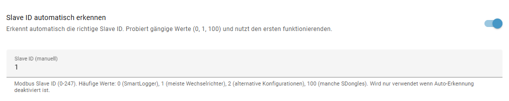

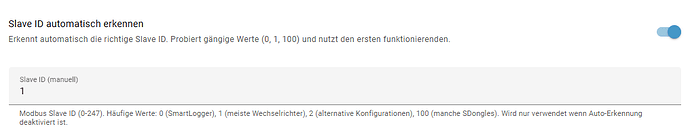

:sun_with_face: Coming Soon: huABus v1.8.0 - Auto Slave ID Detection
Tired of guessing your inverter’s Slave ID? v1.8.0 fixes that!
What’s New
Automatic Slave ID Detection :sparkles:
No more trial-and-error. The add-on now automatically detects the correct Slave ID (tries 0, 1, 2, 100).
Before: :tired_face:

Now:
New toggle in the UI - just enable and forget!
Setup in Seconds
🔍 Auto-detecting Slave ID for 192.168.1.100:502...
✅ Auto-detected Slave ID: 1
Key Features
  • :white_check_mark: Zero configuration - works out of the box
  • :white_check_mark: 100% backward compatible - existing setups unchanged
  • :white_check_mark: Manual mode available - for advanced users
Release Status
Currently in final testing. Release: Very soon!
Want to beta test? Please contact me directly!
Links
Very interesting as I ended up with my set-up to have to use ID: 2 a rather unusual setting.
An automatism would have been helpful to me
Good idea! Looking forward to V1.8.0.
HANT
huABus v1.8.0 Released - Automatic Slave ID Detection & Enhanced MQTT Auto-Config :tada:
Hi everyone! :wave:
I’m excited to announce huABus v1.8.0 - a major usability update that makes installation significantly easier!
:rocket: What’s New
No more guessing! The addon now automatically tries common Slave IDs (0, 1, 2, 100) on startup. Just configure your inverter IP and you’re good to go:
modbus_host: "192.168.1.100"
modbus_auto_detect_slave_id: true  # Default
log_level: "INFO"
Startup logs now show:
INFO - Inverter: 192.168.1.100:502 (Slave ID: auto-detect)
INFO - Trying Slave ID 0... ⏸️
INFO - Trying Slave ID 1... ✅
INFO - Connected (Slave ID: 1)
