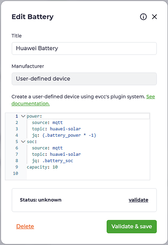

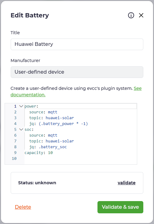

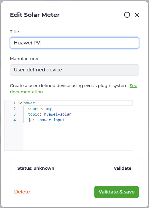

@arboeh hi! Do you have an evcc setup? Is it possible to run both huABus and evcc without a Modbus proxy?
Hey @altrdev,
thanks a lot for your question – this is exactly the kind of use case I had in mind when I started developing huABus.
One of my main goals was to have a single Modbus TCP client with high code quality and extensive test coverage that talks to the Huawei inverter and exposes everything via MQTT (with HA Auto Discovery on top). This enables both Home Assistant and EVCC to consume the data without needing any Modbus proxy or fragile workarounds.
With this example, you can see how simple the EVCC side becomes: you just subscribe to the huawei-solar topic and map the JSON fields to the grid, PV and battery meters.
Requirement: Of course MQTT must be enabled in the EVCC add-on…
EVCC configuration:
# Grid Meter
power:
  source: mqtt
  topic: huawei-solar
  jq: (.meter_power_active * -1)
# Solar Meter
power:
  source: mqtt
  topic: huawei-solar
  jq: .power_input
# Battery (Optional)
power:
  source: mqtt
  topic: huawei-solar
  jq: (.battery_power * -1)
soc:
  source: mqtt
  topic: huawei-solar
  jq: .battery_soc
capacity: 10
I’ve been using this configuration for months and it simply works. No need for all the Modbus proxy fiddling and no outages whatsoever.
I added this configuration as an example in the huABus README so others can easily integrate their Huawei PV system with EVCC in the same way: GitHub - arboeh/huABus: MQTT bridge for Huawei solar inverters (SUN2000/3000/5000) → Home Assistant · GitHub
Happy monitoring and EV charging! :slight_smile: :sun_with_face:
@arboeh | GitHub - huABus
Omg, @arboeh thanks for the info! Now everything is very clear. I was just missing the evcc configuration to subscribe to an MQTT topic. Thanks again – I’m already using your huABus successfully in Home Assistant and now I’m working on the evcc side.
Does it work for you? If you have problems, feel free to ask.
