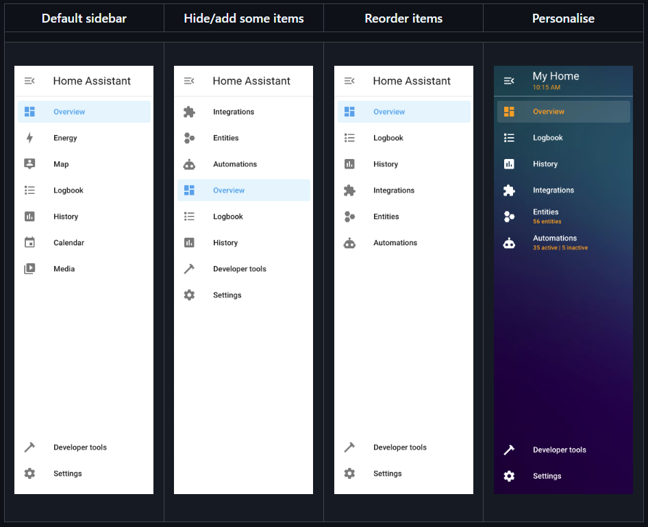

Morning All,

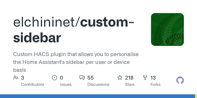

The below solution is not out of the box but I am pretty sure it will give you the ultimate control you need. No matter what device or user profile you are using.
There is a very comprehensive set of options, most optional. Thanks to @elchininet
