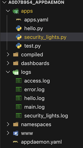

Which gives me this:
The main log does get written to when restarting appdaemon, for example, and I can see all of the configured logs in the web ui dropdown.
