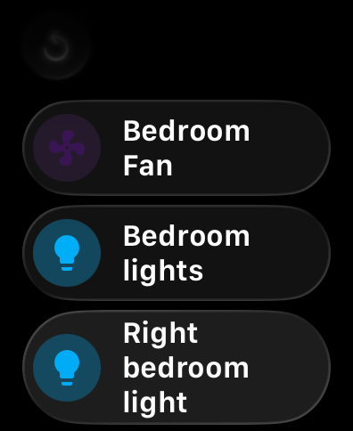

Here’s a screenshot of what mine looks like, you can see the refresh icon at the top is cut off and you can’t scroll up to see it, and you also can’t tap on the icon.
