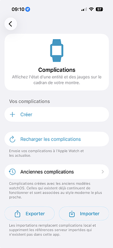

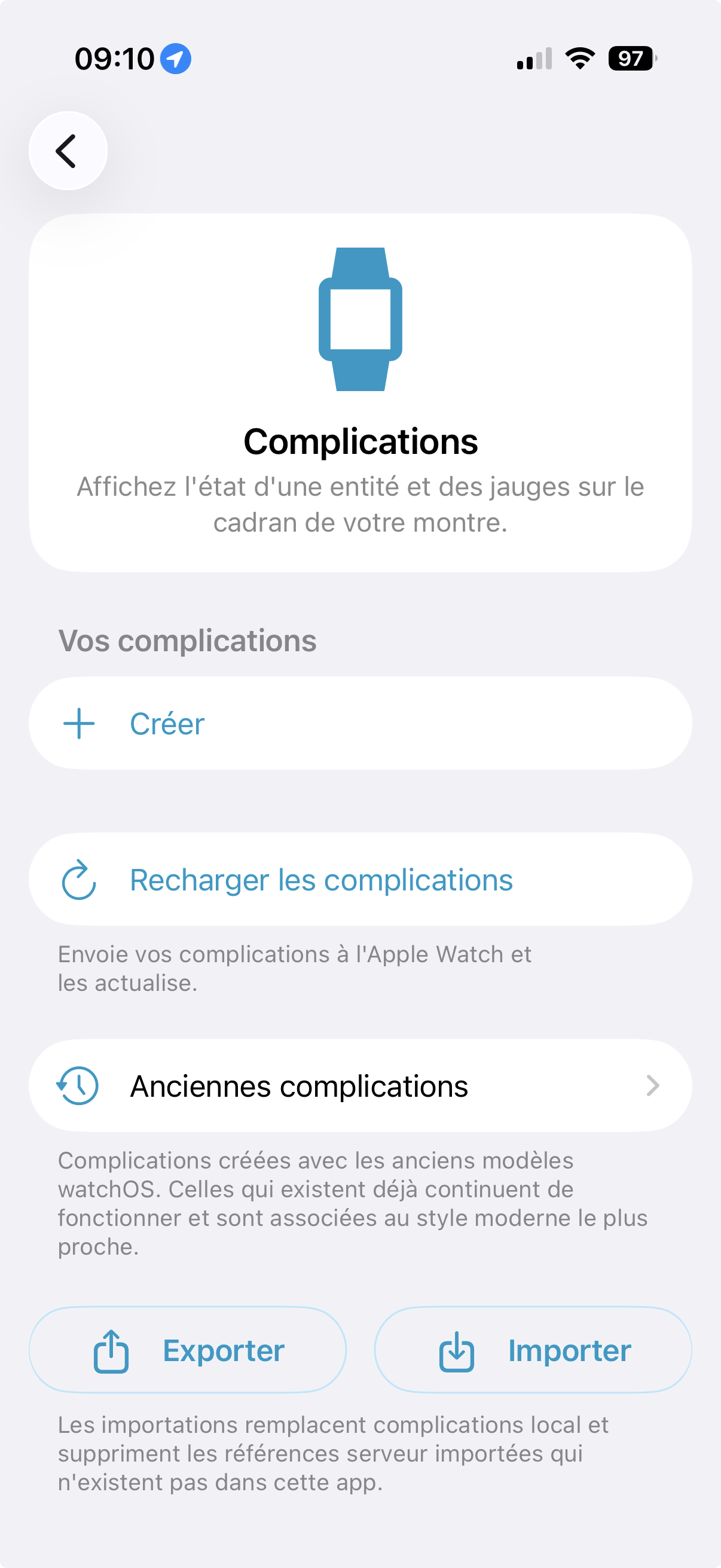

I don’t really understand this page :

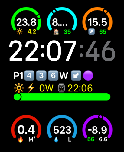

In my situation, there are no duplicates of my complications. I have built more than 10 complications and all show dashes.

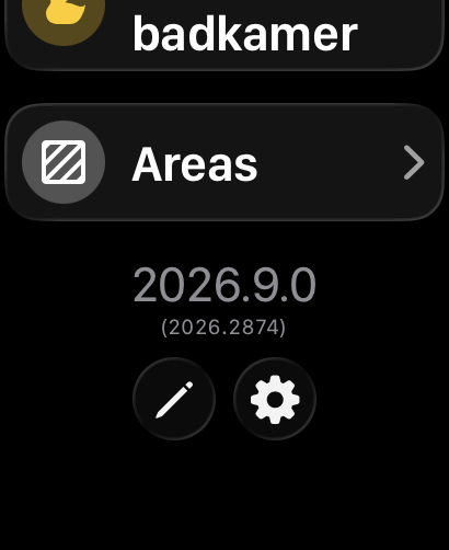

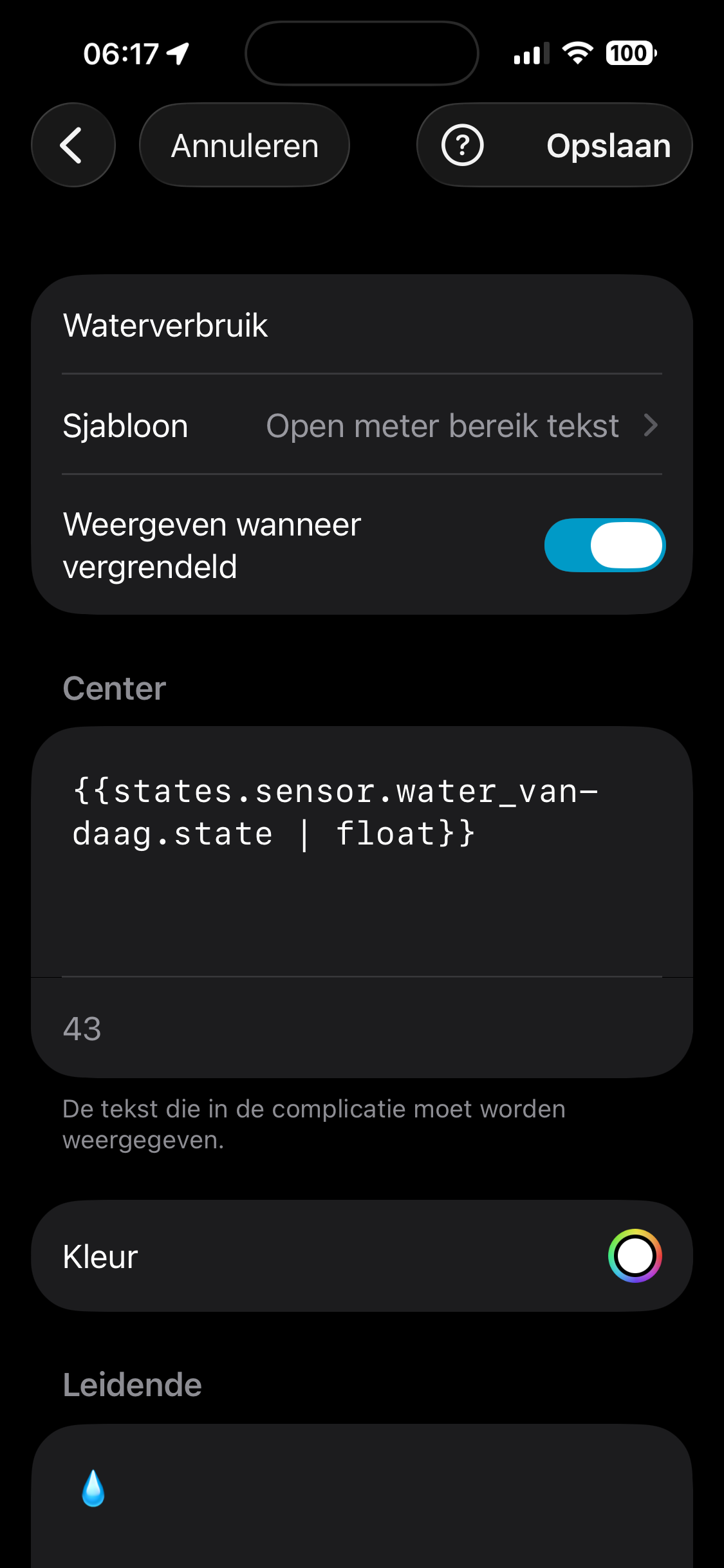

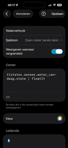

I just installed another newer update which was presented in the AppStore. The app on Apple Watch shows a newer version number but still not solved! See screenshots.
Here is a list of my complications on my iPhone with some other above. You can also see that the code is processed correctly. But on my Apple Watch only dashes are shown. I hope the developers are aware of this problem.

I’ve deleted and reinstalled the app on the watch several times, but the Home Assistant complications no longer appear at all in the Apple Watch app.

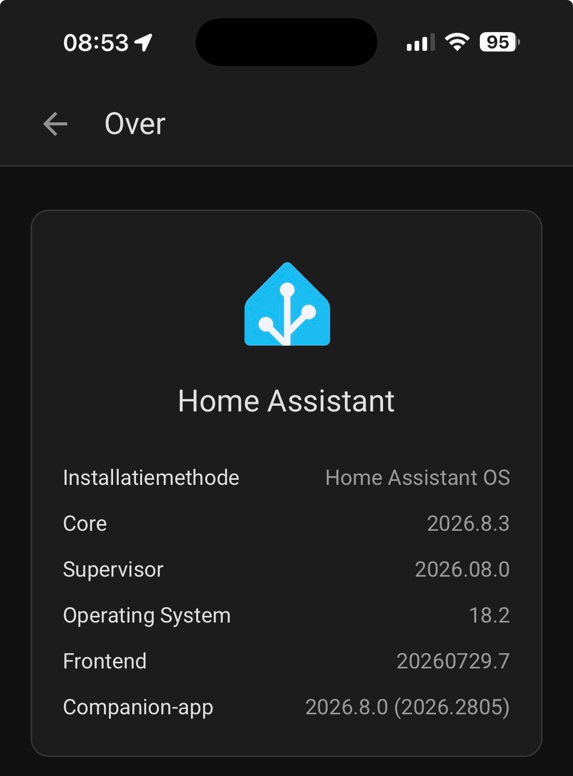

My app auto updated tonight and since then, the Apple Watch complication is stuck on what it showed just before the update. Version is now 2026.9.0.

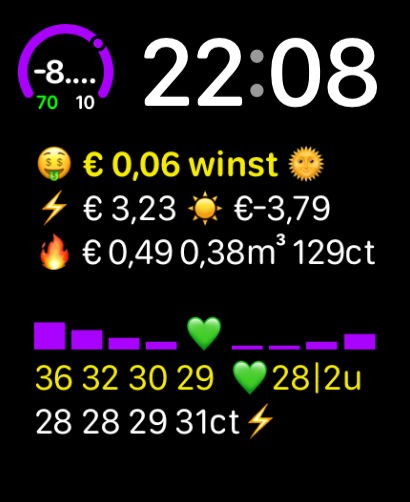

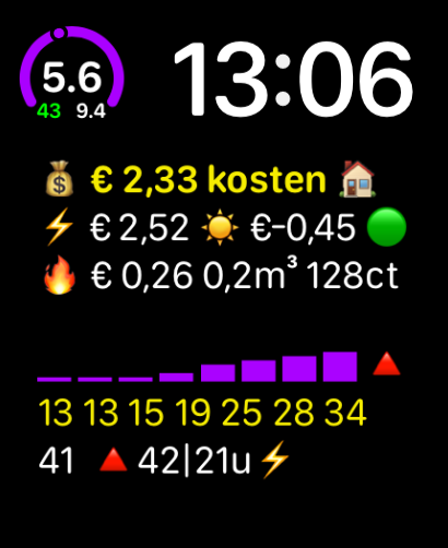

Yes, same problems here. I have a lot of “legacy” complications with very smart YAML code to display 3 lines of information on large Rectangular Apple Watch complications. Those complications are totally gone on the Apple Watch self, but still visible in the Companion HA app on my iPhone. Also the YAML code of each line is processed and shown correctly in the Companion HA app on my iPhone.
On my Apple Watch, I now see some alternative Rectangular complications but they suck and only show 2 lines of distorted information!
I have invested a lot of time to create those complications in the past and they totally screwed up with these “new style of complications”. And the high class complications I have built, they now call them “legacy”?! Unbelievable!

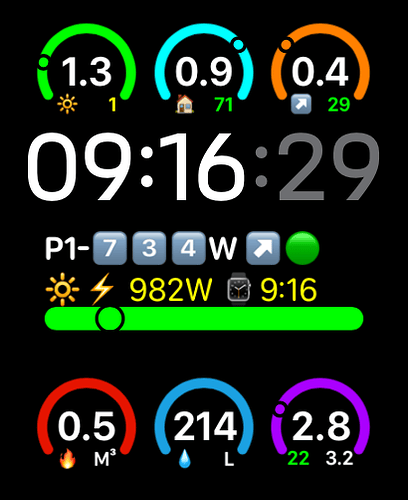

To give you an idea: those attached complications I made aren’t visible anymore on my Apple Watch. They show the Zonneplan energy tariffs for the current and next 8 hours with highest or lowest tariff. Also a complication with my solar meter, gas meter, water meter, etcetera.

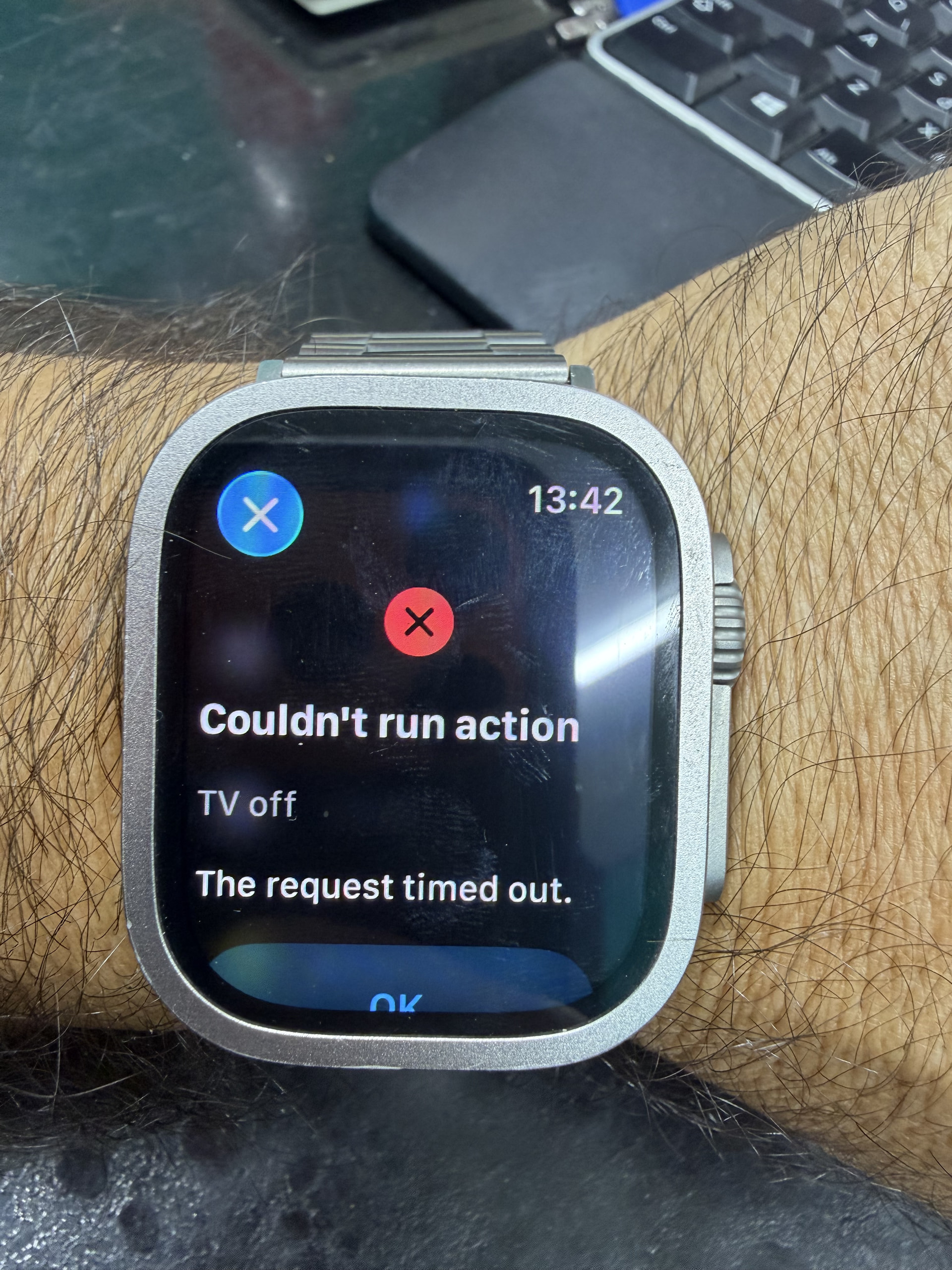

I have similar problem, buttons wont work after last app update.
