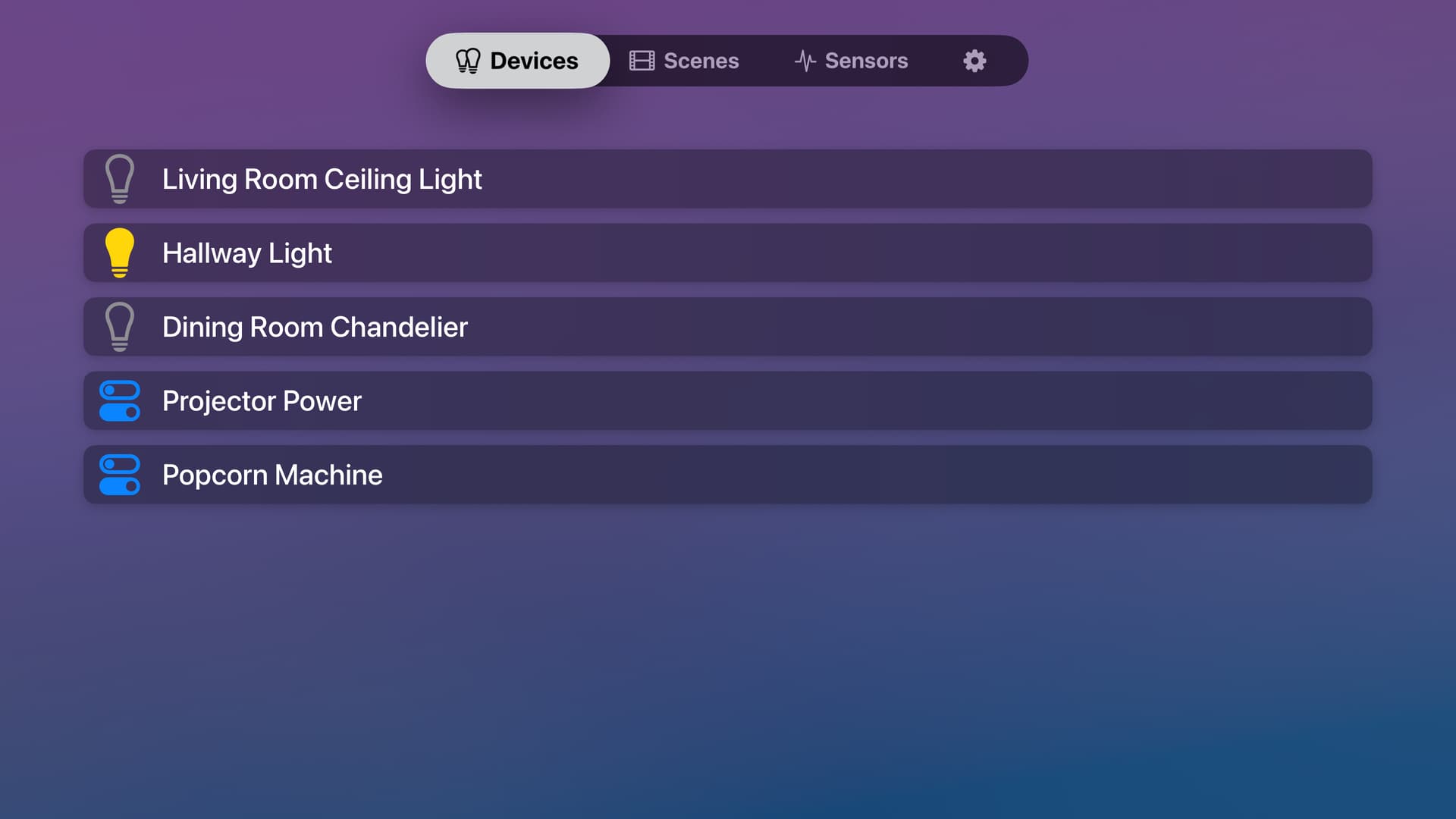

I’m currently working on an Apple TV app that lets you control devices, scenes, and sensors in Home Assistant. It’s still in development, but here’s the basic idea:
The design is not finished, just more like a PoC - Proof of Concep.
One column for devices, one for scenes, and one for sensors.
• The app automatically pulls content from Home Assistant groups:
• group.hatv_control_devices (Devices)
• group.hatv_control_scene (Scenes)
• group.hatv_control_sensors (Sensors).

In the app settings, you can see the three groups used to define the entities.

The names can also be changed if you already have an existing group. The URL and access token obviously need to be entered; this works conveniently via Handoff copy-paste with an iPhone. I’m currently working on a solution to make this accessible via Home Assistant.
