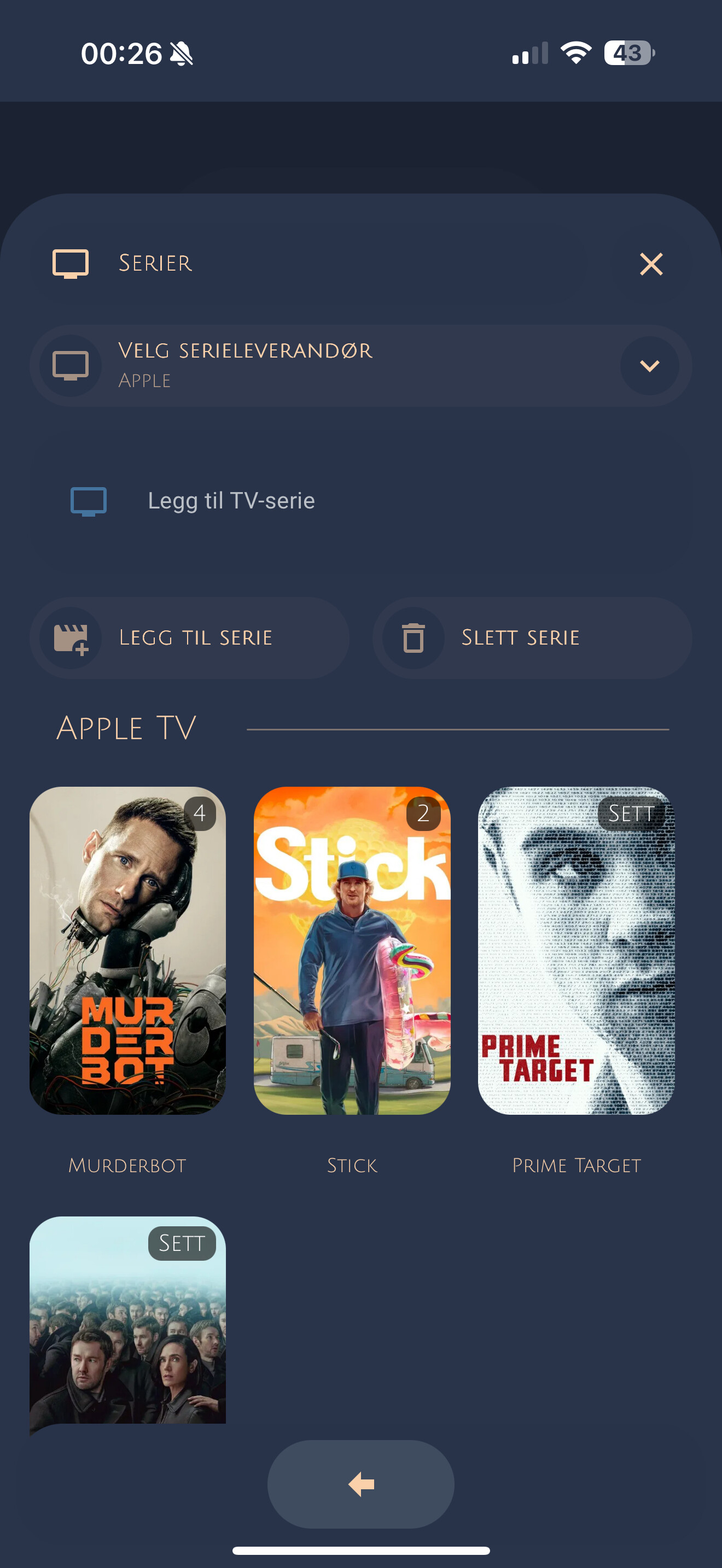

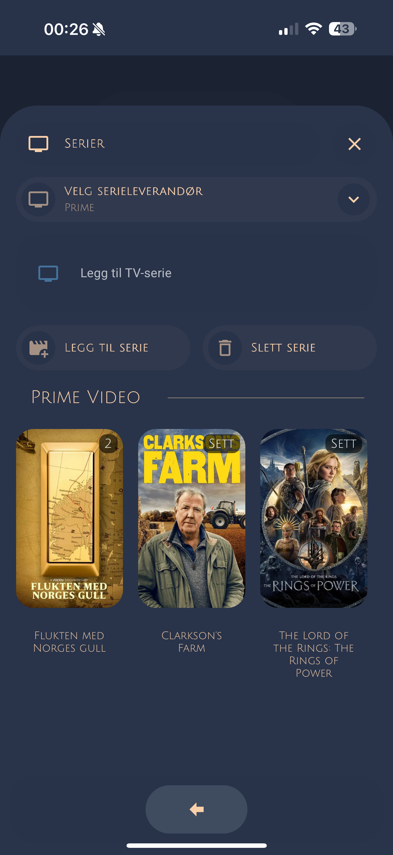

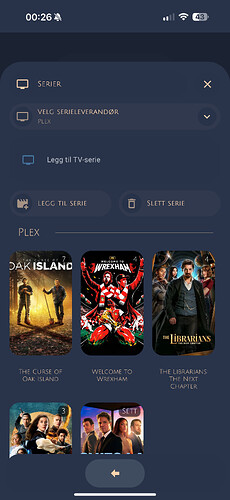

Thanks to this post I’ve now finally managed to get my show watching automated.
I can add shows manually, or I get notified if something I’ve been watching in one of the aps are not allready in the list. Node red handles the automation - gets posters, search the web for url to the show, checks how many unwatched episodes I have using trakt tv.
Everything gets populated into a sensor per streaming service - like sensor.apple_poster.
With attributes like:
serie_1: Murderbot
serie_1_poster: https://image.tmdb.org/t/p/w500/mIKfKo2uDk3itzAPYIcSeYr4KtF.jpg
serie_1_link: https://tv.apple.com/us/show/murderbot/umc.cmc.5owrzntj9v1gpg31wshflud03
serie_1_usett: 4
serie_2: Stick
serie_2_poster: https://image.tmdb.org/t/p/w500/y8EWrf5Ry1WmYksWT7MOPWexvr5.jpg
serie_2_link: https://tv.apple.com/us/show/stick/umc.cmc.52w04zy67tiv11p8xvbc57wmc
serie_2_usett: 2
Just thought I would share if someone wants ideas on how to take advantage of deep links.
