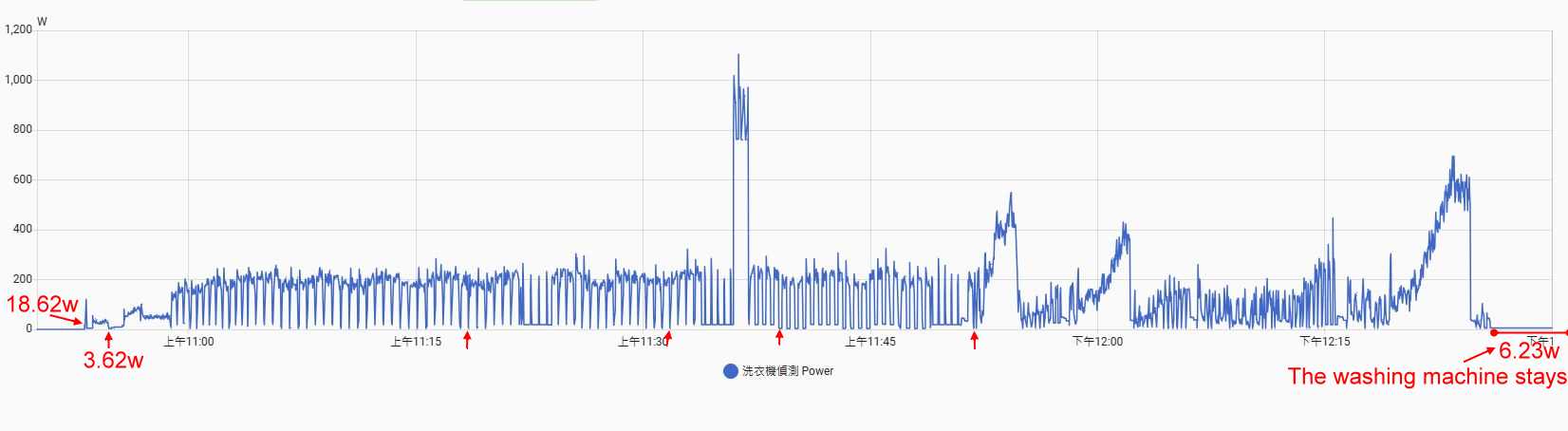

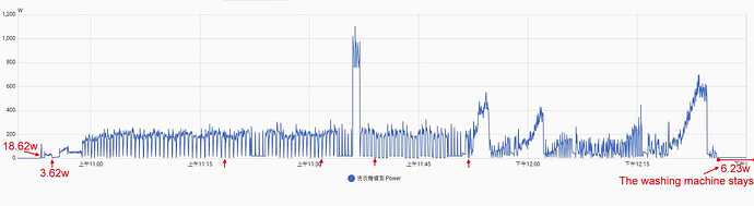

My washing machine brand is Maytag, and I’m not sure how to set it up. When the washing machine first starts, it consumes 18.62W. However, throughout the cycle until it stops, 3.62W appears dozens of times. After the cycle is complete, it stays at 6.23W due to the Fresh Spin setting. How should I configure this blueprint? Thank you!

Thanks for your power graph… it makes it a lot easier to help.
First, check the start power… refer to the green line. You noted it reaching 18.2. The key question is: when it reaches 18.62, is that turning the machine ON or actually starting the washing cycle? Determine this, then set the Start - Appliance Power Setpoint and Start - Power Time Delay.
The Start - Power Time Delay is in minutes, but you may need seconds (e.g., 0.5 = 30 sec, 0.25 = 15 sec). You may need to enter this value manually, or use the next stable, longer section as your start reference.
For example, if 18.62 watts is the initial spike but lasts only 1 minute, you could look at the green line and identify a more stable section… say at 10 watts is the green line. Setting Start - Appliance Power Setpoint at 10 watts for 0.5 minutes (30 sec) could work. If the next stable section lasts 4 minutes, you might set it to 10 watts for 1 minute instead.
Using the green line as a reference ensures reliability; if the first 18.62-watt spike is missed, the automation will still detect the next stable section.
Now, let’s set the End - Appliance Power Setpoint. Throughout your graph, you can see the power drops below 6.23 watts but then rises again. Your end power setting might be 7 to 8 watts, but the End - Power Time Delay is the key factor.
Review your cycle and identify when the power drops below 7 watts, noting how long it stays below this point. Then, set the End - Power Time Delay to be longer than this duration.
For example, if the power drops below 7 watts but only for 30 seconds, setting an End - Power Time Delay of 1 minute ensures the power must remain below 7 watts for a full minute before ending the automation. If the power rises above 7 watts before this delay is met, the automation will remain active.
At the end of the cycle, the power reaches 6.23 watts and stays there for a long time. If it remains below 7 watts for 1 minute, the automation will end. This is why the threshold could be set between 7 and 8 watts… 7 watts might be too close to 6.23 watts. Review your graph carefully to determine the best setting.
Hope this helps you… let us know how you go.
Blacky :grinning:

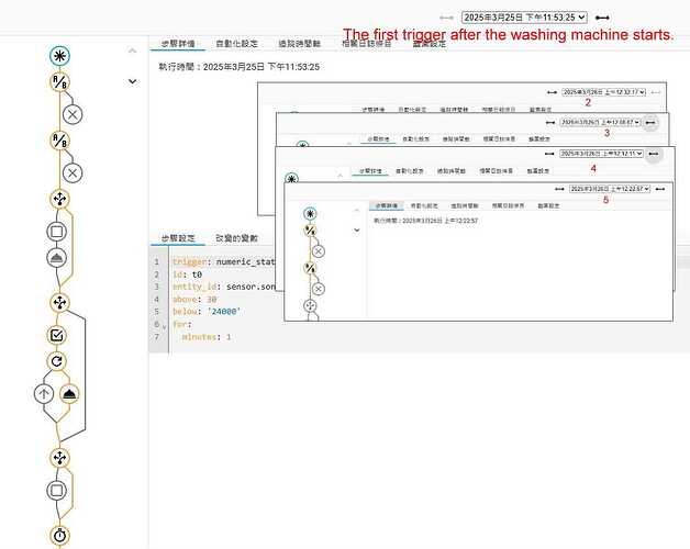

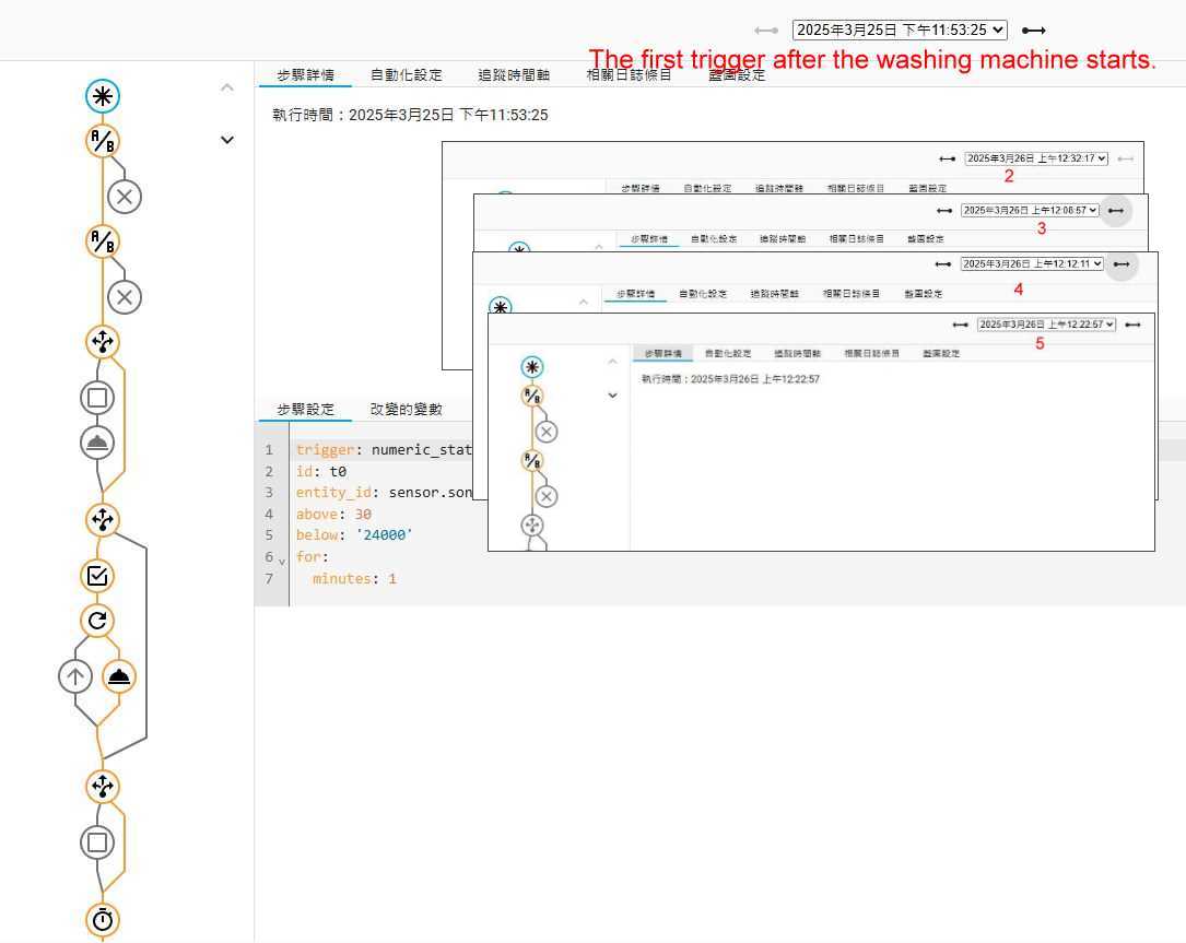

I checked the logs, and after the initial start trigger, the washing machine continues to trigger multiple times during operation, as seen in images 2, 3, 4, and 5. Is this normal? (However, these triggers stop immediately.)
If I only need a notification when the washing machine completes its cycle, I plan to set End - Appliance Power Setpoint to 8W and End - Power Time Delay to 1.5 minutes to ensure that the washing process does not trigger the end condition prematurely.
In this case, do I still need to configure Running - Dead Zone and End - Repeat Count, or can I leave them unset?
