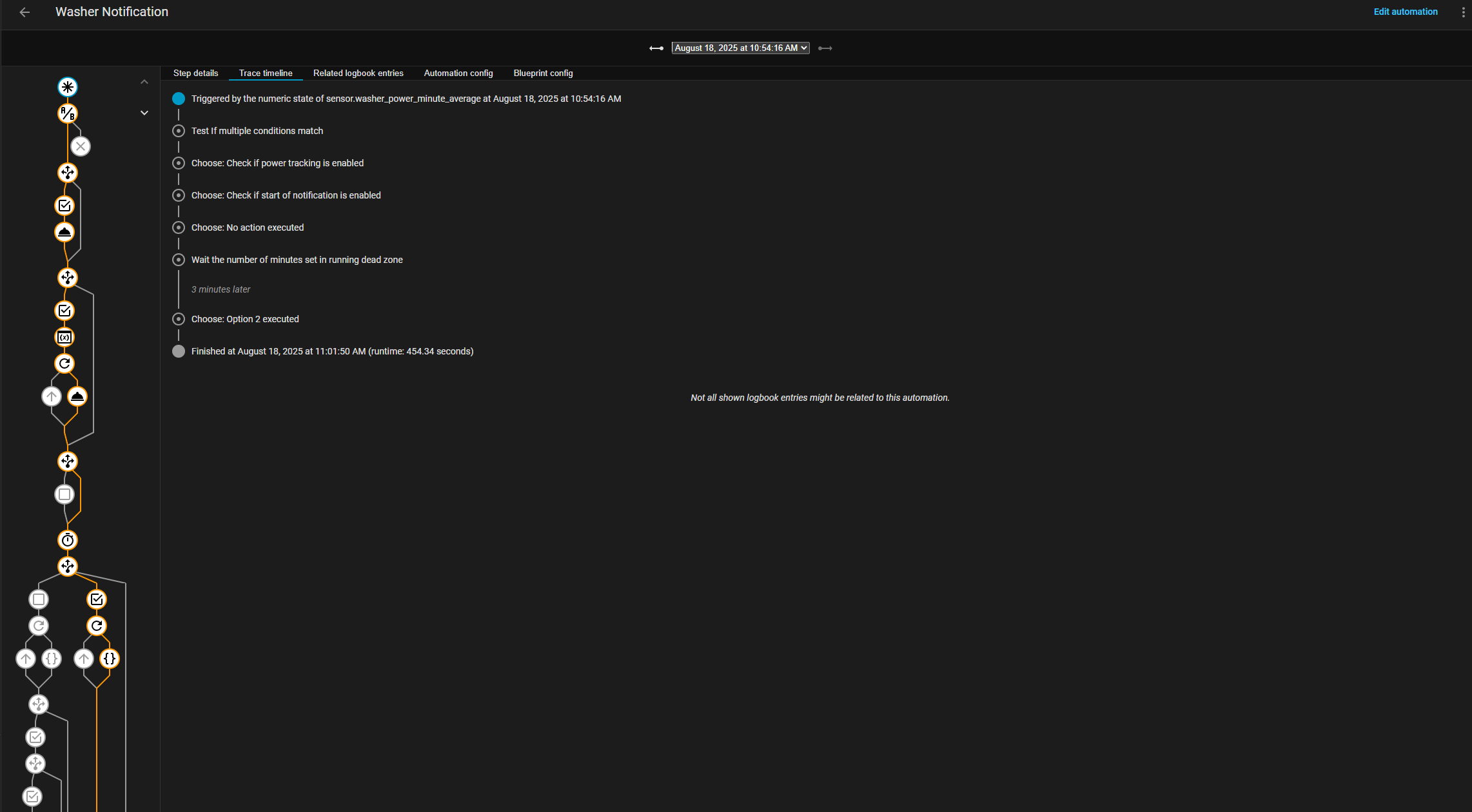

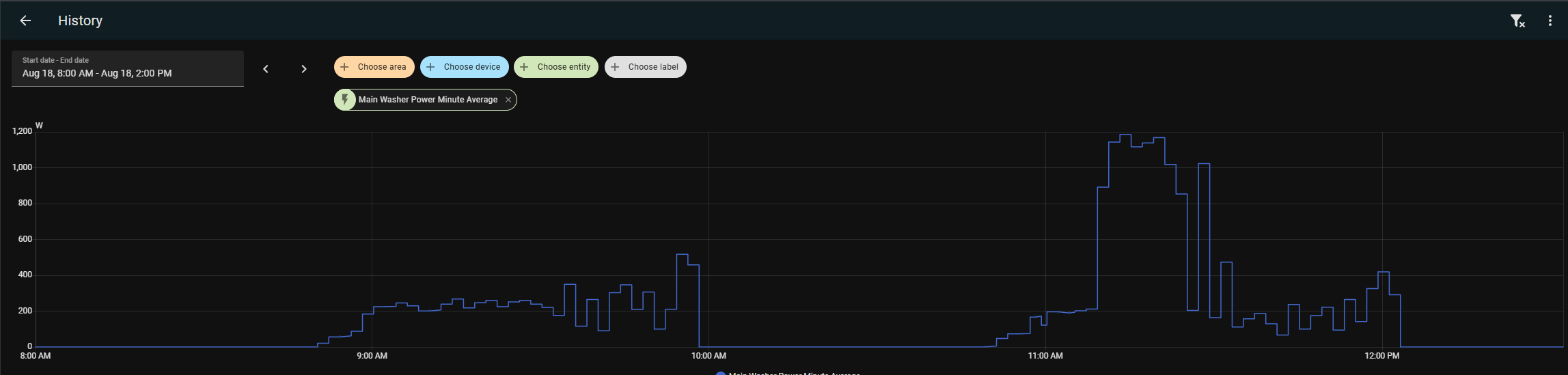

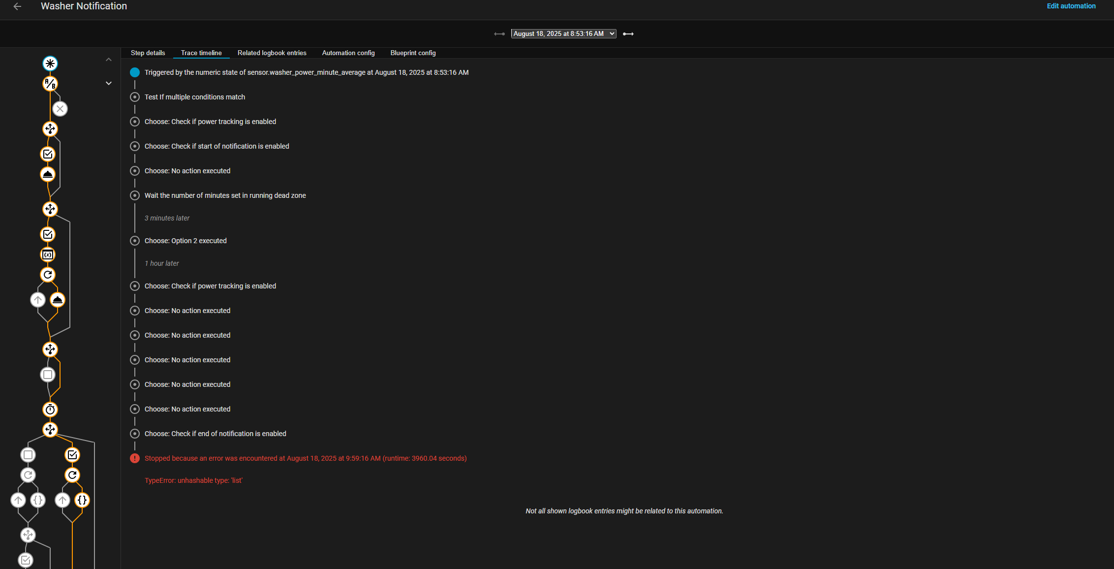

Hey,
Thanks for the quick replies. I figured out that my dishwasher and washer sensors were plugged in wrong. I have that part sorted now… so the pictures above are all out of whack. So basically we are starting over. I will provide the most current error image, the yaml as well and then the graph for the time the automation happened.
I am not sure how this will format but… I uploaded two screenshots from the trace (see time stamp at top) the first one got to the end and then error at sending the notification for end. The second load got all the way through but i never received a notification for it to end. Also not sure why the process ended early. The graph shows both laundry loads and their power draw.
Yaml as requested
alias: Washer Notification
description: Notify when washer is turned on, and off with consumption
use_blueprint:
  path: Blackshome/appliance-notifications.yaml
  input:
    power_sensor: sensor.washer_power_minute_average
    start_appliance_power: 50
    running_dead_zone: 3
    include_start_notify: enable_start_notify_options
    start_notify_device:
      - 7f7f8236f7086f27dafba109a9220e43
    include_end_notify: enable_end_notify_options
    include_power_tracking: enable_power_tracking
    power_consumption_sensor: sensor.dishwasher_energy_today
    end_notify_device:
    end_notify_icon: mdi:washing-machine-off
    end_notify_data:
      - icon
    start_notify_data:
      - icon
@henson_kraj
Your so close. The reason why you are not receiving a notification at the end is because in Energy Tracking you have enabled Enable - End Notify with Energy Used (kWh) but you haven’t selected your 3 input helpers. This FAQ shows you how to create the helpers click here. Once you created the helpers and selected them in the blueprint inputs it should work.
Blacky :grinning:

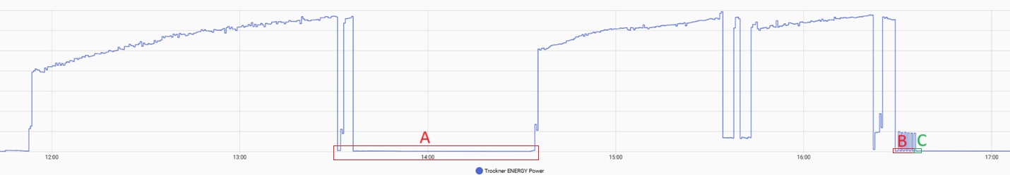

@sdholden28
Thanks for your YAML.
Lets go through a few things.
  1. In you power settings you have a running dead zone of 20 min. If you dryer completes before then you wont be notified because the End - Appliance Power Setpoint has to go from above 10 watts to below 10 watts after 20 min. Lets try and remove the running dead zone for now.
  2. End notify looks good!
  3. Time restrictions, you only be notified between 6am to 10pm. All looks good.
  4. Duration Tracking, looks good.
  5. Cycle Counter, looks good.
  6. Watchdog, looks good. I added the same notification tag and updated the message for a clothes dryer. You can remove the tag if you like…
  7. Device Tracker. looks good must be at home (in HA to get it). I am going to disable this for now just to test it then once it is working just enable it again.
  8. Start Notify, is disabled… lets enable it to start with for testing so you know it starts then just disable it once it is working.
  9. Custom actions look ok.
Try this YAML, copy and paste it in.

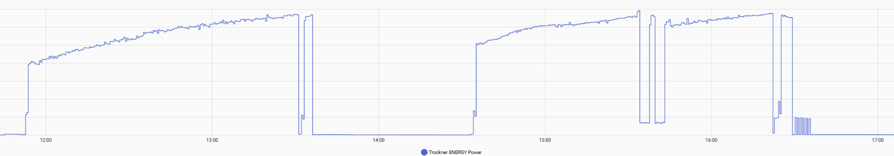

Hi, I am struggling to detect the end of my clothes dryer. The problem is, that its not an fixed cycles as it detects if the clothes are still wet. And then there also this anti-crease feature at the end of the cycle which turns the clothes every few minutes. At the picture you can see two cycles which are looking completely different. So the start is detected reliable.
At the end of the 2nd cycle you can see this anti-crease feature. Any hints how to solve this?
@smoki3
We need to look at the lowest reading in detail.
  1. What is the lowest reading at point A and for how long. Does point A happen every time?
  2. What is the lowest reading at point B and for how long.
  3. What is the lowest reading at point C.
Once I know that I can help.
Blacky :grinning:

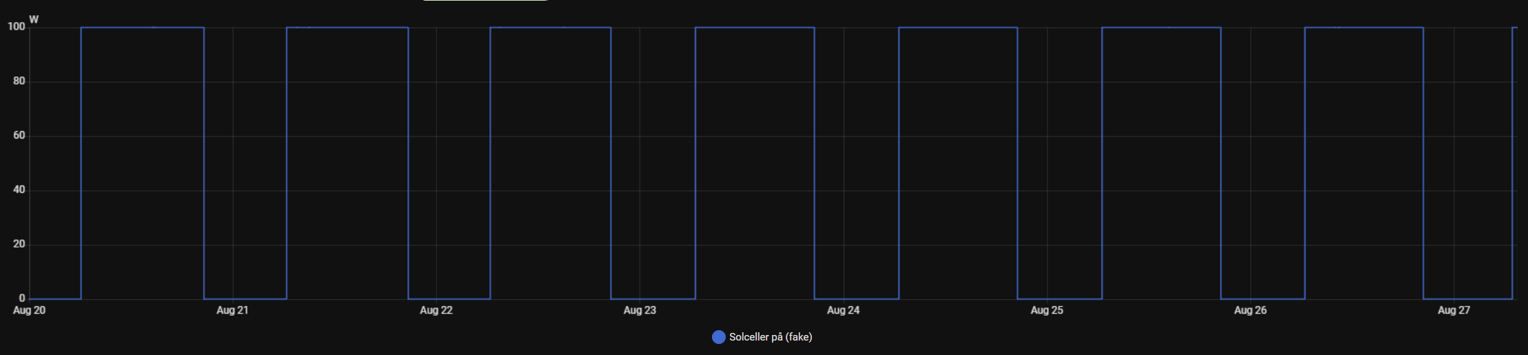

alias: Solceller (appliance)
description: ""
use_blueprint:
  input:
    power_sensor: sensor.solceller_pa_fake

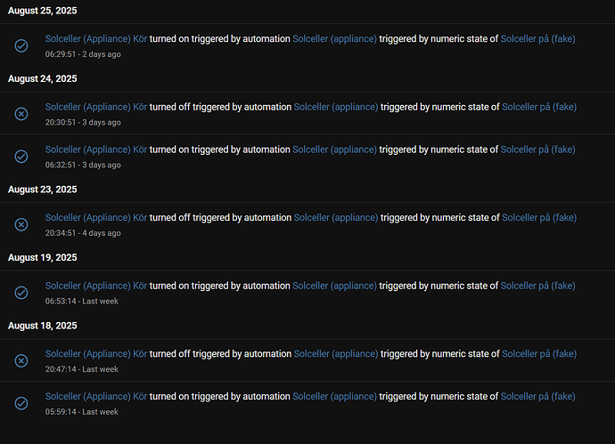

Hi @Blacky ! I try pasting again, hope it goes well and help you.
The fake value works:
But the blueprint doesn’t get trigged byt it, below output from the logbook
Ideas?
@michael.miz.ziegler
We finally go there. Your YAML looks good… most of it is custom actions.
Your Power Sensor is wrong unless this is a custom template to then run some actions every day… this seams odd. You can do this with my :round_pushpin: State Notifications & Actions blueprint. This blueprint is really designed to look a an actual power sensor that fluctuates as it goes through a cycle.
Have you selected the correct power sensor?
Blacky :grinning:
