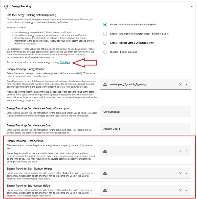

@bemo47
In Energy Tracking you missing your number helpers.
Once you add them in it will work. See the more information link.
Blacky :grinning:
Oh thanks, I will add this, but my issue is just the end message that doesn’t show, it is based on the power entity only, apparently no link with the energy entities, are you sure there is a link ?
@bemo47
In the image I provided above the arrow shows you the link that will take you to the FAQ. Here it is for you click here.
You need to add the number helpers into the inputs shown in the image above that has the red box around it. They are
  • Energy Tracking - Cost per kWh
  • Energy Tracking - Start Number Helper
  • Energy Tracking - End Number Helper
Blacky :grinning:

Ok i did it and it works now ! Excellent.
But, the need of these 3 number helpers was there because i checked the energy tracking option i guess ?
If i hadn’t checked this option, then the end message should have shown i think.
But anyway it works fine !

@bemo47
Yes.
That’s correct but I thought you wanted it because you enabled it. You can disable it and remove / delete the helpers if you like and it will work.
Blacky :grinning:
Ok, ok, my question was just to understand fully, energy info is nice too, thanks a lot !
