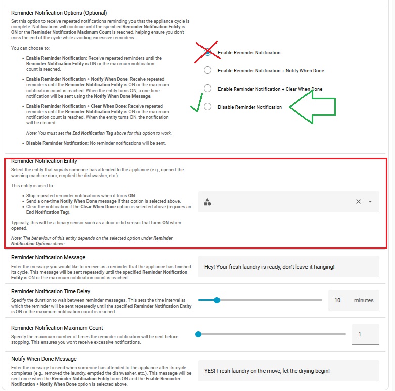

@hplar11111
Welcome to the community.
Looking at your YAML you have selected to get a Reminder Notification but you haven’t entered in a Reminder Notification Entity. I don’t think you meant to select this option because in your Run Status you haven’t added your End Reminder Status & the End - Attended Status. If this is correct then disable your Reminder Notification.
If you would like a Reminder Notification then you will have to add a Reminder Notification Entity and also add into the Run Status a End Reminder Status & the End - Attended Status.
Tip For Next Time: When posting code in this forum, use the </> button. Paste your code into the box that appears… this preserves formatting and makes it easy for everyone to read and use.
