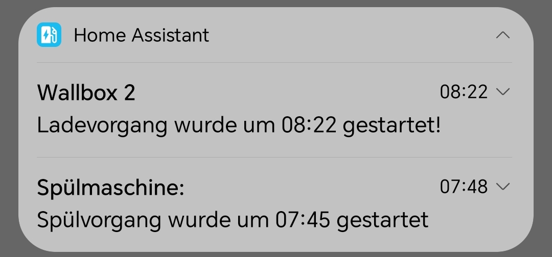

Hi, I’m a fan of your Blueprints and have a request. Would it be possible to place the icons for individual device messages at the beginning of the message instead of using them as a group icon? Currently, the icon from the last message is always used as the group icon. Thanks for your great work. Regards,
Mike
@Mike.Hellracer
It must be the way your phone and Home Assistant handle it. I don’t think this is something I can change.
Blacky :grinning:

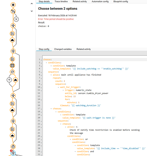

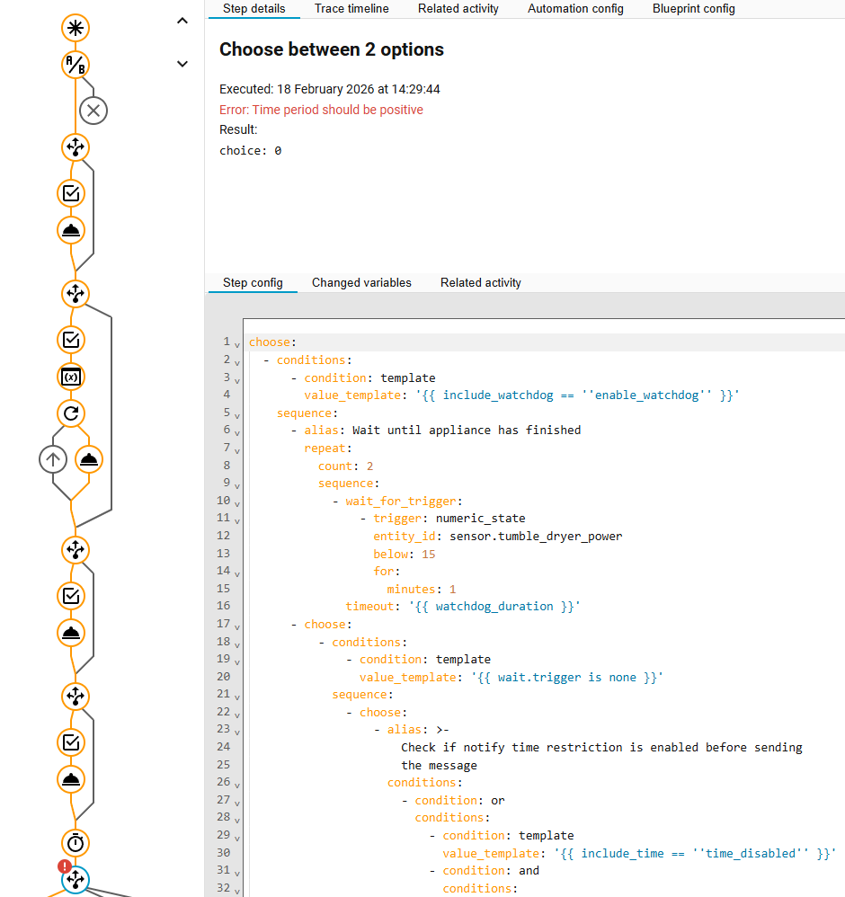

Hi Blacky,
Many thanks for your wonderful Blueprints.
I’m having a bit of trouble getting this to work with my Bosch Tumble Dryer.
It always fails at this point.
I’m not entirely sure what I’ve done wrong.
Also, a quick question.
When the Dryer reaches the end of the cycle, it will pause for 2 minutes, then change direction and tumble for a minute or so, pause for 2 mins, change direction etc (end cycle) until we switch it off.
Can your blueprint account for this?
Is that what the End - Repeat Count is for?
I’m hoping to be able to use the Blueprint to send a notification when the main cycle finishes, if no one has attended to unload, turn off the power after the dryer has completed 5 end cycles.
I was using the WashData Integration before, but was getting very sporadic results and then I came across your Blueprint.
