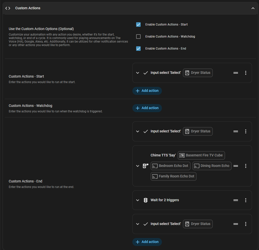

How would I go about adding a reminder state if say the washing machine hasn’t been unloaded? I have a zigbee plug I’m using to trigger the running and end state via the power output on both the washer and the dryer. I have a zigbee contact sensor on the dryer door.
Do I add a custom action before the end action to wait ā€œXā€ time and then select the ā€œreminderā€ state in my dropdown? I’ll also add a TTS reminder before the end state to broadcast it to my Amazon echo devices. Is this the best way, or should I do something else?
Can I change the color of the icon in the dashboard to change based on the state/status of the washer?

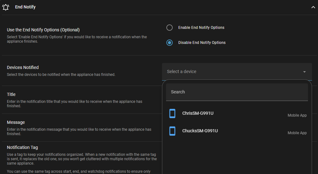

@cwyman1
This is already built into it. Look in End Notify and the Reminder Notification Options. Select the option you would like to use and add your zigbee contact sensor on the dryer door to the Reminder Notification Entity. Below that set the following 4 inputs below.
Blacky :grinning:

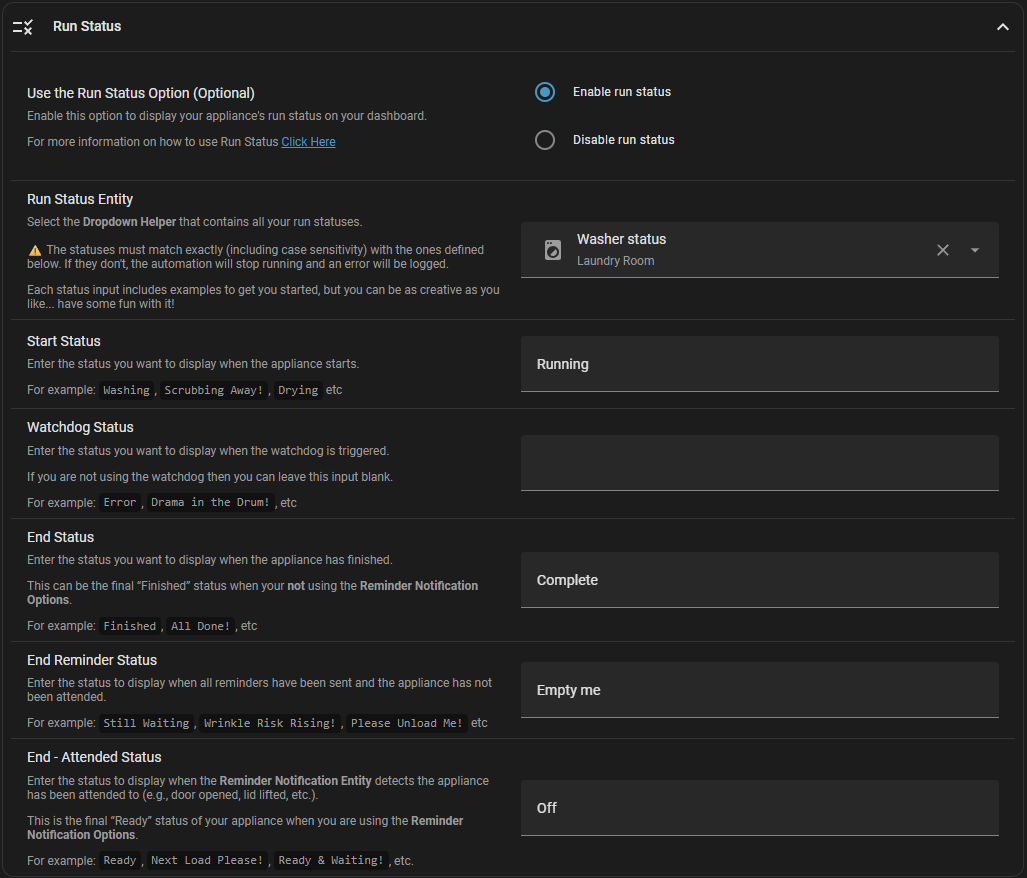

@Blacky
I tried this and it appears to only work on sending the notification to a phone. Unless I’m missing something.
I’m trying to just change the dropdown status so that it shows up as a reminder on my dashboards and my TTS announcements made over my Echo speakers. It does this now based on the the ā€œend run statusā€ for ā€œrunning, complete, and offā€ but I can’t figure out how to change it to utilize the ā€œend reminder statusā€. I hope that makes sense.
@cwyman1
When you use the run status it must match exactly the same so
Empty me can’t be Empty Me and Off cant be off, please see the FAQ click here

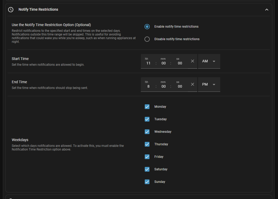

@Blacky
I’m having a issue where I’m getting alerts broadcast to my Echo devices based on my custom actions when they’re outside of the Notify Time Restrictions. This morning at 9am it broadcast to my Echo devices even though it’s outside of the time restrictions and woke up my daughter. Do I need to add something in my custom actions to restrict the time?
