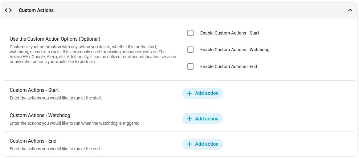

Yes, your custom actions will run. You can add a condition before your action. I want your custom action to be what you would like with no restrictions. What you can do is add a choose action then set your condition being the time, then add your action to the choose.

I think what people are doing when wanting this is to use the custom actions. Then you can tailor it to your needs.

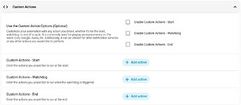

This blueprint has a custom action section for start, end, and/or watchdog events.
Blacky :grinning:

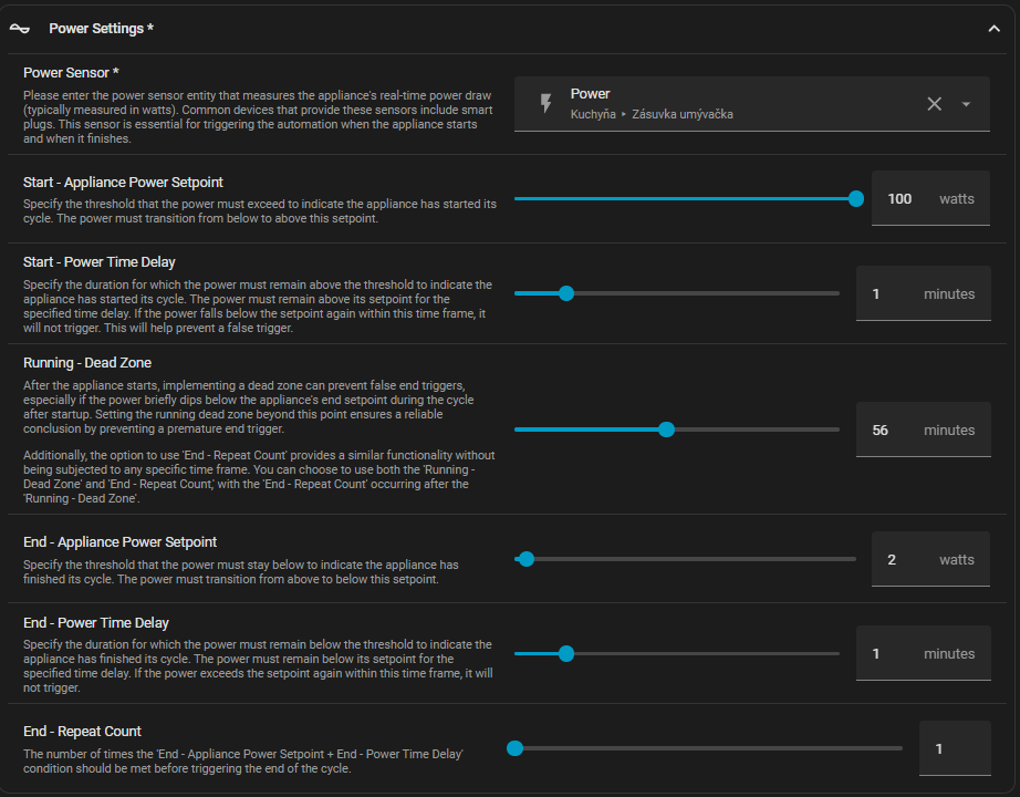

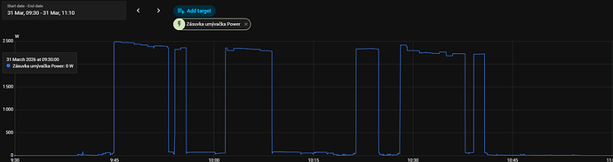

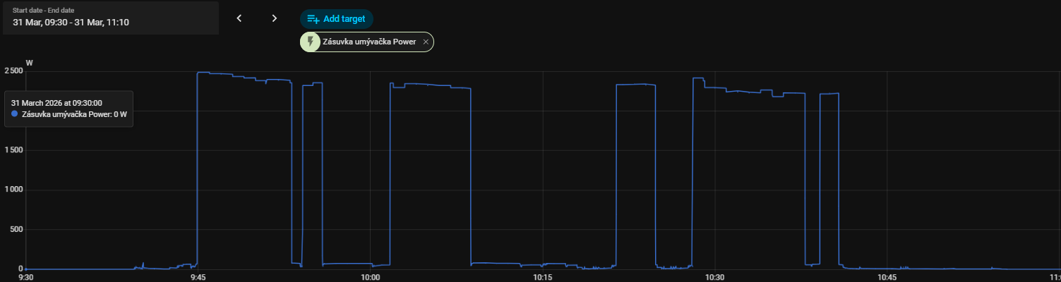

thanks for your effort and blueprints! Much appreciated. I am now testing this blueprint on my 13y old Bosch dishwasher, but I am struggling to make it work properly. I tried so many options but I still get multiple ā€œStartā€ notifications and no ā€œEndā€ notifications. Attached my settings + history chart from the Shelly Smart plug. The lowest value from the history.csv is 2.9W, it never dropped below that. Of course when it ends, it drops to 0W. Any idea what I am doing wrong?
@embeathome
You get the start working perfectly so lets just look at the end.
This is a key point along with the your graph. You currently have a Running Dead Zone of 56 minutes. Try setting this to 0 minutes.
The issue may be that the appliance drops to 0 W (below 2 W) indicating the end, but this happens inside the running dead zone. When that occurs, the automation wont detect the change because the dead zone ignores power readings within it’s set time.
For the end trigger to work correctly, it must detect the power changing from above 2 W to below 2 W (as per your end setpoint). If this happens during the dead zone, it will be missed and the end trigger will not fire.
Note: If the power never drops below 2.9 W during the cycle, then you don’t need a Running Dead Zone, so it’s best to set it to 0 minutes and just use your end setpoint of 2 watts.
Let us know how you go and let’s make those old dumb appliances smarter than the new ones!
Blacky :grinning:

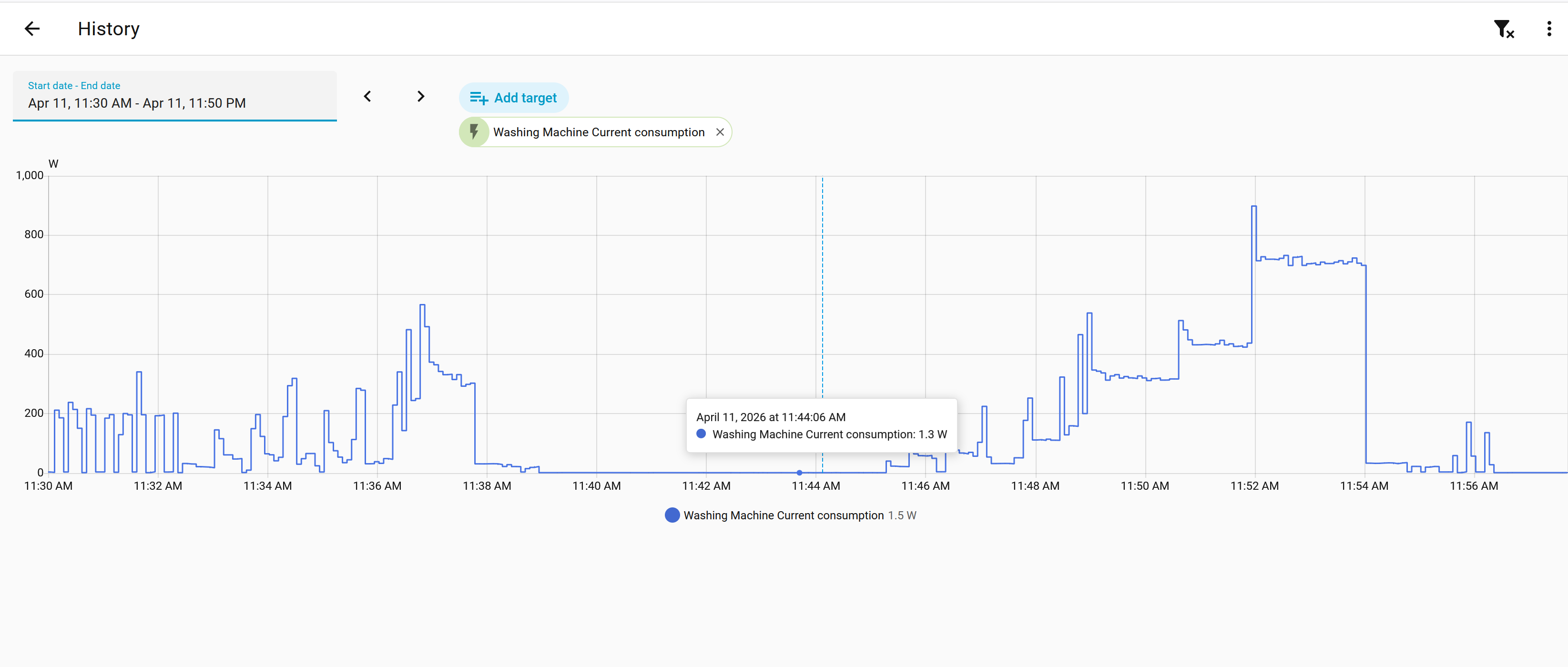

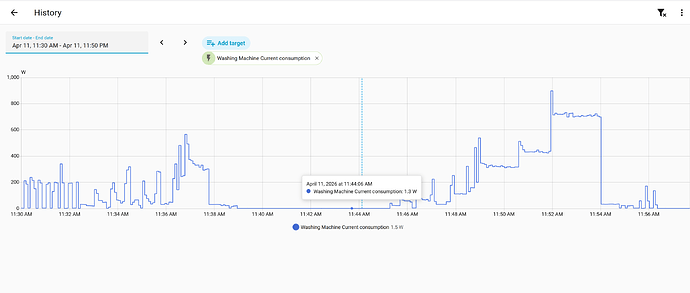

this is the graph showin that I left it ā€˜off’ with the low consumption for 5 mins to wait for the notification that never arrives
BTW - unable to post my other settings as I’m set to ā€˜new user’ to only one image allowed.
Start - Appliance Power Setpoint 4 watts
Start - Power Time Delay 1 min
Running - Dead Zone 0
End - Appliance Power Setpoint 5 watts
End - Power Time Delay 1 min
End - Repeat Count 1

TY Blacky! I had not much time lately, but let me test it now! I will let you know if this works. The machine has more programs, but we use only ECO and we set 1/2 of the usual time. That was suggested by the technician, when the machine required repair. I will let u know if it works.
My settings was based on much much earlier settings of the others, suggested by you - especially the dead zone, based on the graphs of the others :slight_smile: But these suggestions are very old, probably from the beginning of this thread.
Edit 1: some 15-20min from start and already 3 Start notifications :frowning:
Edit 2: so some 4-5 start notifications but no end notification :frowning:

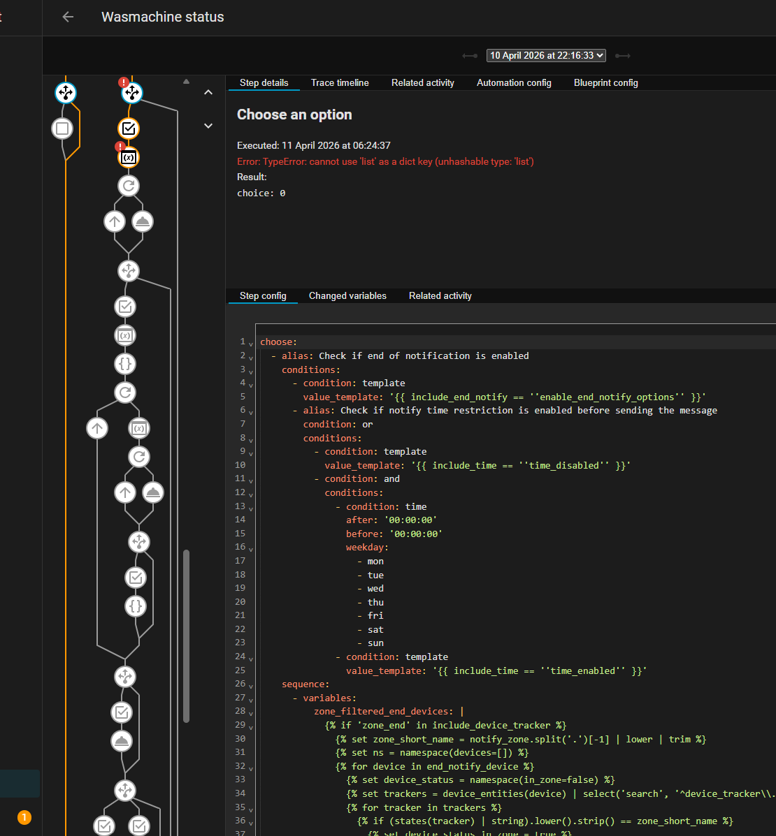

first of all, thank you for this Blueprint.

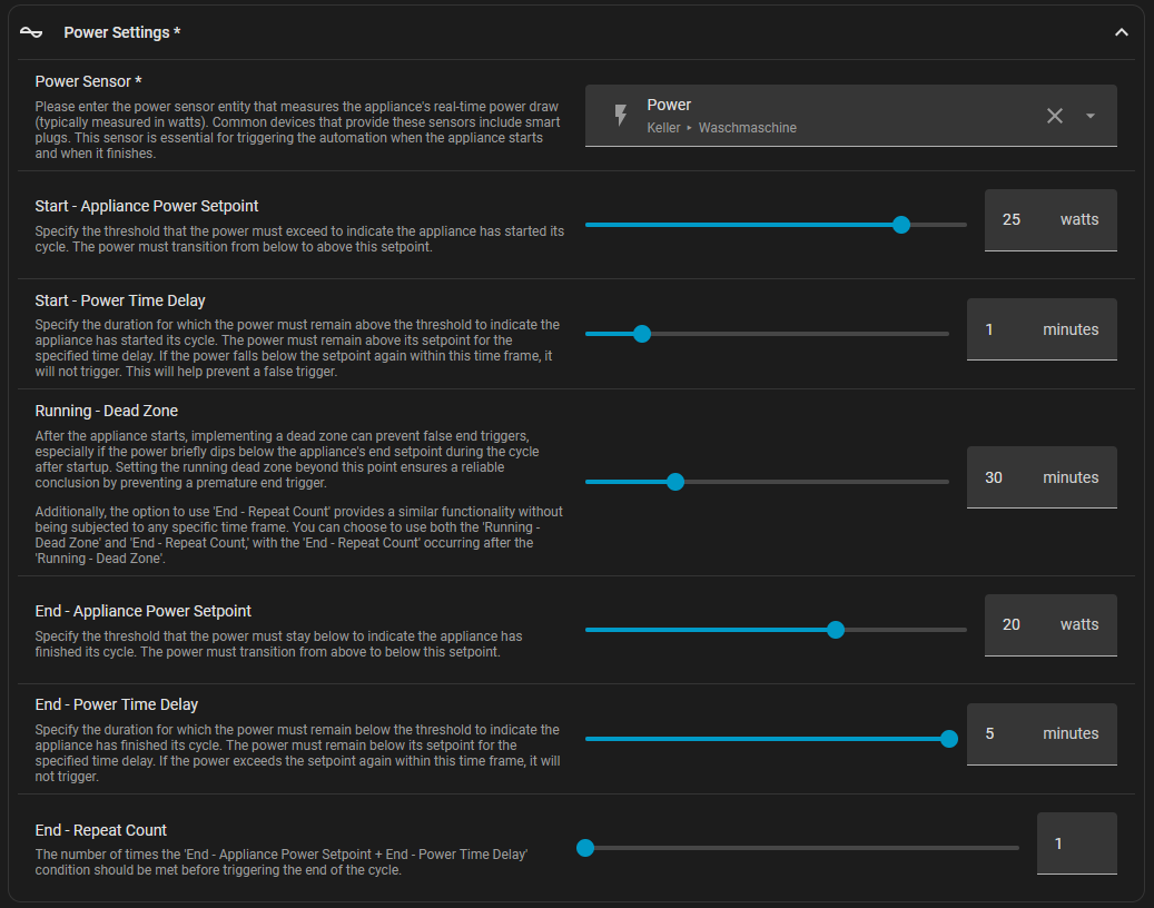

Same error: I get a start notification, but no end notification. See screenshot:
The parallel action updating the status helper runs perfectly.
Thanks for having a look at this.

  2. There are already custom actions for Start, Watchdog, and End. Would it be possible to also add a custom action for Reminders, so that, for example, you could make a light blink each time a Reminder Notification is sent?
