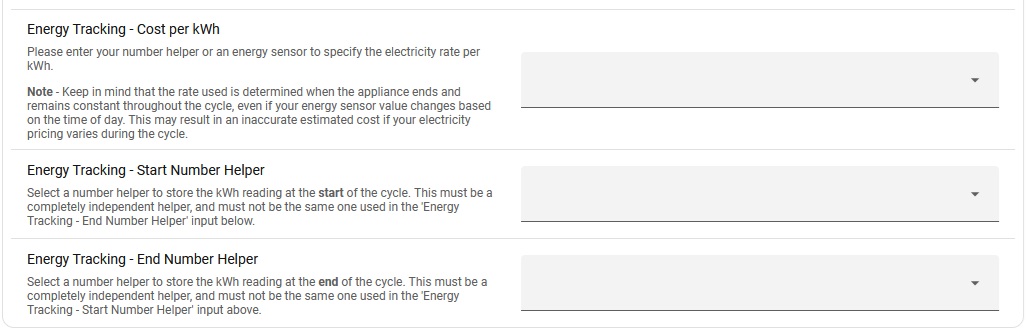

First, providing your YAML of your setting really helps me as I can see exactly what you have and it helps me help you... thanks.
This error normally means your missing an input in the blueprint.
The three (3) inputs your missing are in Energy Tracking;
You can disable this option or add the inputs. In that section there is a link for more information and it shows you how to do the inputs.
Blacky :grinning_face:
Works like a charm now - Thank You! Very useful information that this error means missing input.
@ulih
Your welcome.
Blacky :smiley:

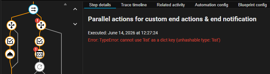

Hello @Blacky ,
first of all thank you for the enormous work done and sharing it with us :slight_smile:
But I need some help. I'm getting an error:
Error: TypeError: cannot use 'list' as a dict key (unhashable type: 'list')
Did I miss something in configuration?
Here is my yaml for this section:
Summary

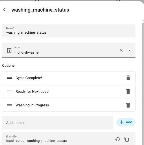

@hansolu
Could you please provide us your YAML of the automation? This YAML code are the settings you have selected in the automation so I can help. To do this go into your automation, top right 3 dots, Edit in YAML, copy all the code, come back to the forum and in your reply at the top tool bar click on β€œ</>” and paste code in there.
Maybe also a screen shot of your Dropdown Helper
Blacky :smiley:
Hi
here is the yaml
alias: test_wash
description: ""
use_blueprint:
  path: Blackshome/appliance-notifications.yaml
  input:
    power_sensor: sensor.shelly1pmg4_acebe6e52808_power
    include_run_status: run_status_enabled
    run_status_entity: input_select.washing_machine_status
    run_status_start: Washing in Progress
    run_status_end: Cycle Complete!
    run_status_end_reminder: Cycle Complete!
    run_status_end_attended: Ready for Next Load
    start_appliance_power: 9
for the helper, i dont know how to see the yaml for it, therefore i added a screenshot.
