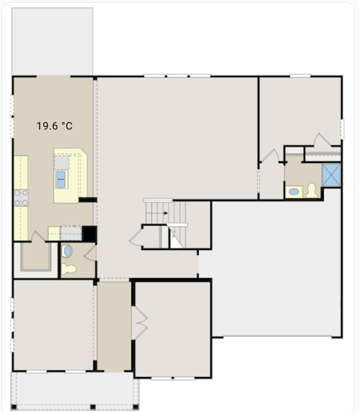

Hi All,
I tried a few things (including card_mod) but with no luck.
Here’s a snippet of my code (and test picture):
type: picture-elements
elements:
  - type: state-label
    entity: sensor.sensore_bagno_vasca_temperature
    style:
      left: 15%
      top: 30%
image: https://demo.home-assistant.io/stub_config/floorplan.png
I’d like the temperature label (in this case 19.6 C) to get a color. E.g.:
Green if between 18 and 22
Red if above 22
Blue if below 18
Any idea?
Thank you
Stefano

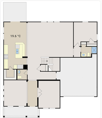

I checked the examples and adapted my code. Nevertheless the color does not change and remains black…
elements:
  - type: state-badge
    entity: sensor.sync_box
    style:
      top: 32%
      left: 40%
  - type: state-label
    style:
      left: 21%
      top: 31%
    card_mod:
      style: |
        :host {
          color:
              {% set temp = ('sensor.sensore_bagno_vasca_temperature.state')|float(29) %}
              {% if temp > 20}
                #FF0000
              {% elif temp > 18}
                #00FF00
              {% elif temp < 18}
                #FF0000
              {% else %}
                #0000FF
              {% endif %}
