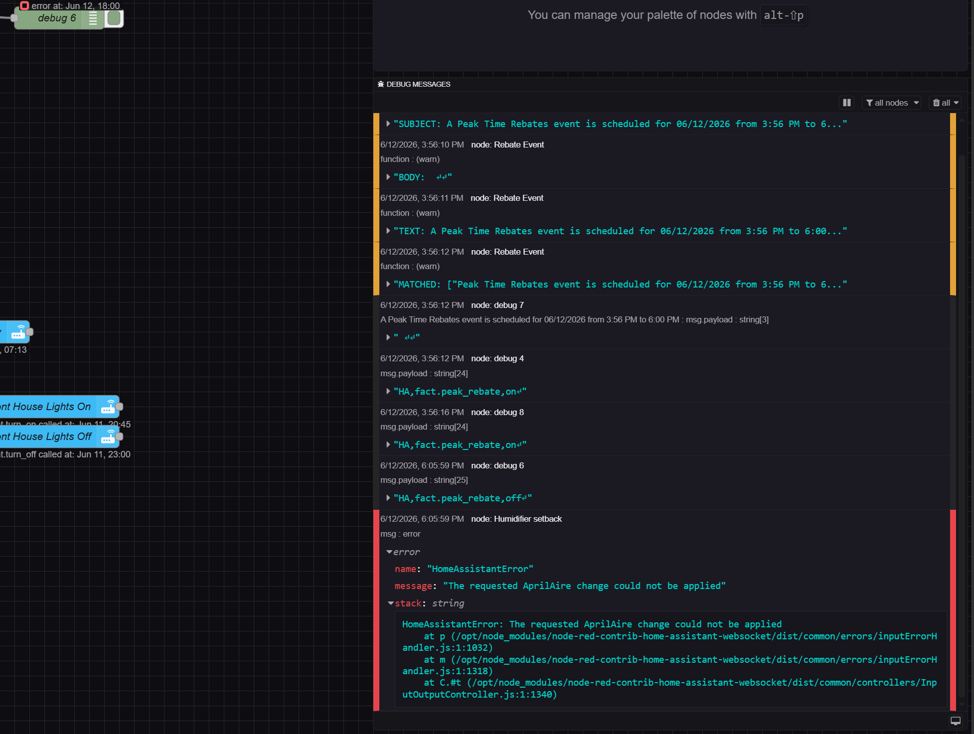

Thanks for sharing, this is great! I set it up today and plan to use it for a few things. Monitoring on dashboard etc. and for peak rebate events from power company in case it is in the middle of a long run it will set back a few % until after the event. It worked great but did spit out an error at the end of the event (though it did actually take the command). I tested it manually after and it worked fine with no errors so maybe a fluke.
