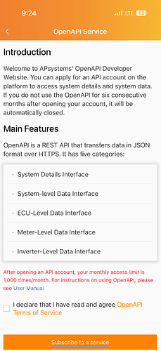

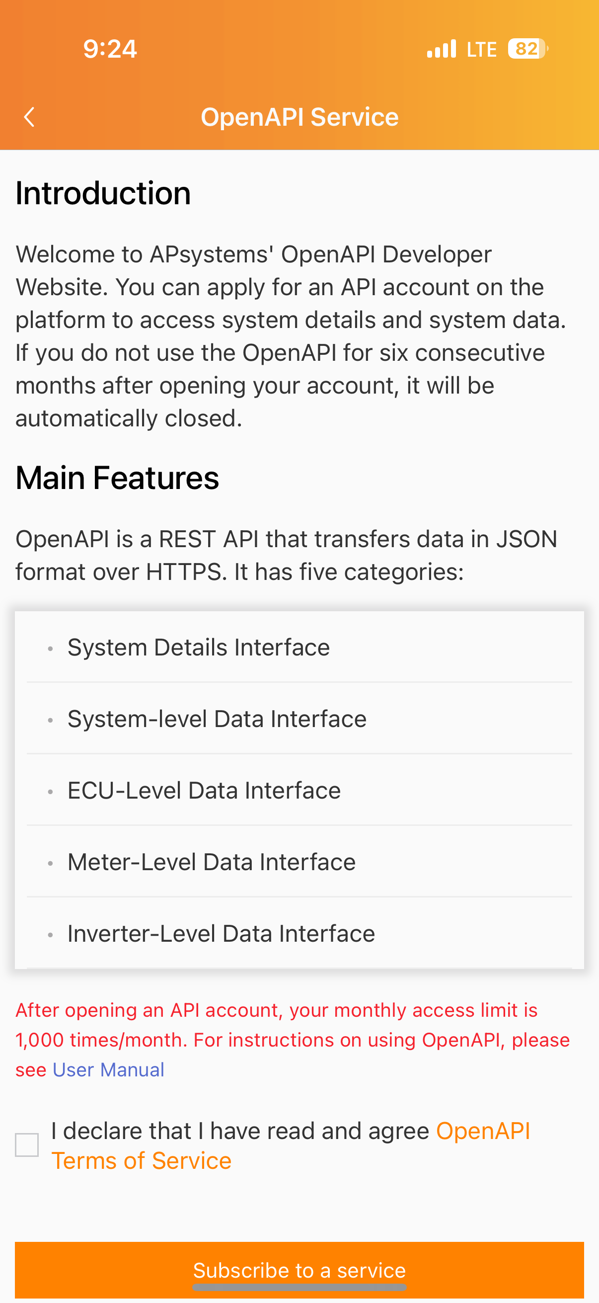

Hi everyone, I just got an update to my iOS app for AP Systems and noticed that they are implementing an official API program, anyone else got this? I believe this is great if it allow us to have a proper path to the data.
Interesting, still i would not want to be dependent on their website. (and i expect them to make it a subscription when they have enougth users on the api)
Today proven once again when evohome from honeywell had interruptions. Could not control my own thermostate because of it, (had to walk to the radiator and use the turn knob :stuck_out_tongue_winking_eye:)
If they would implement the same api on the ECU, i would be very pleased.
Just saw that as well. I am quite disappointed as it seems to be cloud-dependent, and what is this 1,000 times a month limit? If I can’t get more than 1,000 data poll a month, it’s quite useless. Finally, this “Subscribe to a service” button is a bit scary.
Why couldn’t they have a local JSON table available to poll like many other boxes…
