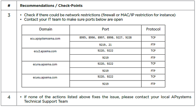

Issue is not resolved with a different VPN. It’s more stable, but just got the above error again. I guess I have to enable debugging to see what is going on.
I can make the error message better understandable but what it means is that there was no data received from the inverters. But you mention the VPN provider. Is it a remote site on which you monitor the ECU?
Ah ok. I didn’t understand what the message ment.
No, the ECU is only on a different Vlan. But HomeAssistant has access to that Vlan and specifically the ip address of the ECU.
I think the VPN blocked some traffic from the ECU to EMA, causing the ECU to get slow. But that is just a guess, as the ECU was not able to reach EMA and the data did not come through.
When switching the VPN, the data was send to EMA and I got less errors in HA about getting the data.
You do indeed need to give the ECU free access to the internet for the specified ports otherwise you will get unwanted effects. The ECU also does some checks with the EMA site.
