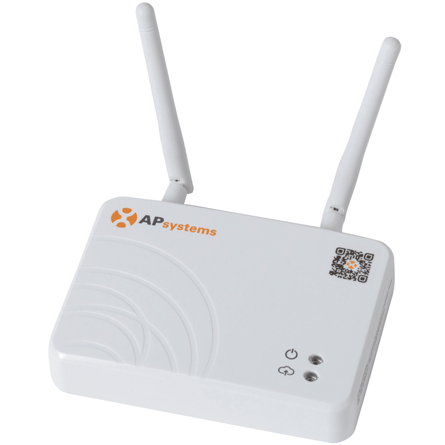

@checking12 @TexTown You can assume that all suppliers have stopped selling the old ECU-R models (out of stock). So if you buy an ECU-R check the box if the ID starts with 2162xxxxxxx. Then you are good.

Some explanation about the origin of the ECU-R-Pro naming: At some point APsystems released a new version of the ECU-R. Instead of ECU-ID 2160xxxxxxx these new ECU-R models have ECU-ID 2162xxxxxxx. These new models have firmware version: ECU_R_PRO_2.1.23 and that’s how the name ECU-R-Pro came about.

I have been looking for an ECU with serial starting with 2162. I finally manage to get one and the software is working excellent. I can control the inverters now.
I have been in contact with some suppliers and one told me that they had 3 ecu’s starting with the number 2163xxxxxxx. So, it seems there is an even newer version available. Not sure what firmware it runs. But perhaps something to keep an eye out for. :slight_smile:
Type number 2163x is an ECU-B, as far as I know.
Yes, that’s the ECU-B - this model only supports max four panels. If you plan to add panels in the future, you’d better buy an ECU-R or ECU-C (3-phase).

B definitly not.
R newer version you will be able to control yourself.
C can do more on its own by using clamps (2nd hand around 200 Eur i’ve seen), still thinking if i like that more then new R type and do it myself

I’m testing the “APsystems ECU Reader” integration with my ECU-R 2160 (firmware V1.3.18) and I’ve run into an issue: I can’t add the ECU to my Home Assistant monitoring.
The ECU is connected via Wi-Fi to my local network with a fixed IP address. I can successfully “ping” it and even execute the command APS1100160001END, receiving the expected response on line 4 as per the integration’s website.
However, when I try to add the integration in Home Assistant using the ECU’s IP, even after waiting more than 10 minutes, I get the message: “No ECU found at this IP-address or ECU is recovering from restart”.
Currently, I don’t have any microinverters installed, and consequently, there’s no production data in the EMA App. I also haven’t created an EMA account. I’ve only borrowed this ECU-R from a friend initially to see if I could integrate it with Home Assistant for monitoring purposes using your (HAEdwin- APsystems ECU Reader) integration. My main question is whether the absence of data or a registered EMA account could be causing this error.

Any chance for adding the functionality of the code from GitHub - PlanetSmasher/APSystems-ECU-proxy-for-cloudless-operation: APSystems ECU proxy for cloudless operation into this plugin as an all-in-one solution?
This will prevent the ECU from shutting down when it doesn’t find a cloud/internet connection. I don’t like little Chinese blackboxes in my home network that call home with me not having control over it. And when you deny internet access to the ECU unit, it stops working after 2 or 3 days.
This proxy works around that, you just need to set a few custom DNS rules in your router or pihole instance for example
That’s indeed my first implementation of this proxy method. However, a few weeks ago, I discovered that the data is now encrypted (which is better, of course), so this method was discarded. I’ve already hidden my own repositories for that reason. If you’d like to test the proxy method again, let me know, and I’ll temporarily open the repository of the final implementation.
I’m currently experimenting with full Modbus integration but am running into incompatibility issues. For example, the ability to switch off individual inverters via Modbus isn’t implemented. The firmware still needs significant improvements to become fully functional.
Oh interesting. Your old method still seems to work fine on a ECU-B-EU box. I threw that proxy up on a local device with the correct DNS entries and the ECU-B-EU started responding/working again with the cloud LED back on.
