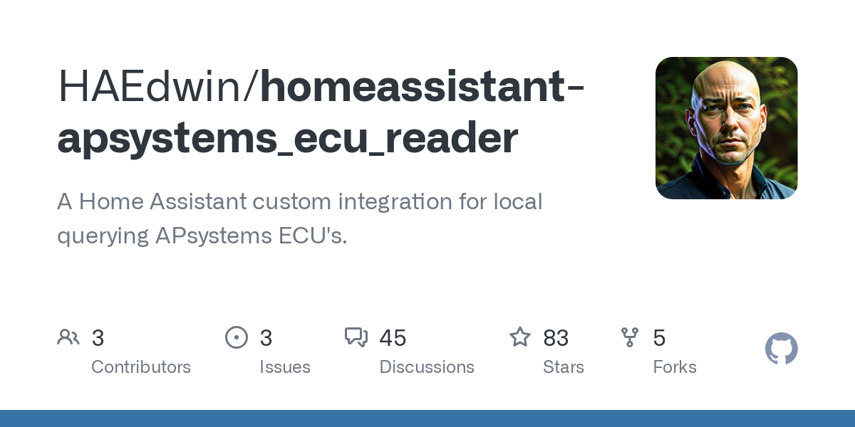

I recently got my Solar Panels installed from an installer and am trying to integrate my ECU-R (2160 series with DS3 inverters) with my Home Assistant. I’ve assigned the ECU-R a static IP address on my network, but I’m having trouble connecting to it locally.
When I ping the IP, I get consistent ~8ms responses for a short time, followed by 30 seconds of timeouts. Running nc -v [ip] 8899 returns “Connection refused.”
Does my ECU-R have to be connected wirelessly? (reading GitHub - HAEdwin/homeassistant-apsystems_ecu_reader: A Home Assistant custom integration for local querying APsystems ECU's.).
When I connect my phone to the ECU-R AP and login with local access, it doesn’t show any devices using the EMA app (Works fine with the login that my installer provisioned for me).
When I try to login using local access with the EMA Manager app, it’s showing no details. Getting WLAN and LAN settings also fails under Workspace
This is all new to me, so I’d appreciate any guidance on troubleshooting or next steps. Thanks!
Make sure the ECU is well placed so that it receives both Zigbee and WiFi signals. Are you sure you assigned the fixed IP-Address to the right node? Timeouts when doing ping -t to the ECU of 30 seconds marks a bad WiFi connection and yes unfortunately the 2160 ECU-R needs to be connected wireless when using 8899 because this port is not available when you use a wired connection. When pressing the AP button on the ECU you should first connect your phone’s wifi to the AP and then start the ECU Manager app and choose local access. Than make sure you also assign a fixed IP to the ECU. It’s hard to tell what exactly is going wrong but I think is the assignment of the IP-address.
