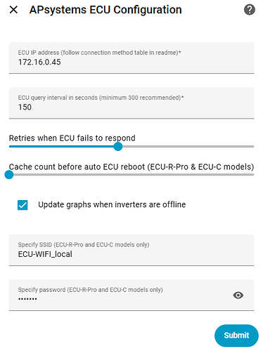

No the integration will not try another port. Just the ip-address is being asked for i.e:

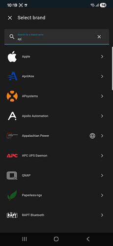

Here is the integration that I am using / trying to setu up and some screens about the process, the first window that I get is the one with IP and Port, cant get over it.
@hotsauce Yep, it’s the wrong one - this one is a so called embedded (built-in) integration (officially supported and maintained as part of Home Assistant itself). And it is for the APsystems EZ series of WiFi based microinverters only.
Mine is a custom integration, community-made that you install separately and Home Assistant doesn’t officially support. It supports the APsystems ECU models (and therefor the Zigbee based microinverters).
For installation read this:

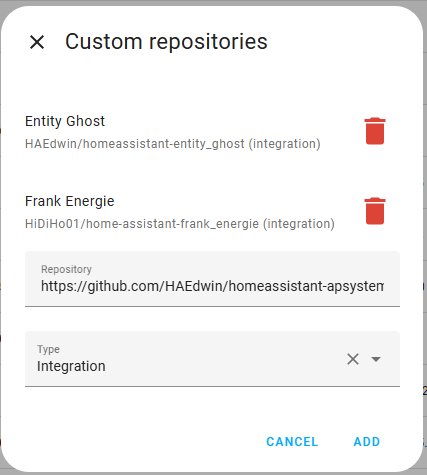

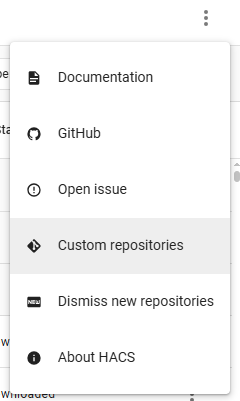

When in HACS in the upper right corner select Custom repositories
Paste the URL:
GitHub - HAEdwin/homeassistant-apsystems_ecu_reader: APsystems ECU Local Query Integration for Home Assistant
and choose type: Integration
Next choose ADD

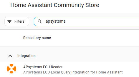

Then it’s added to the store and if you now look for apsystems:
Click on it and at the lower right (scroll down) you’ll find the download button. Download the integration and restart HA.

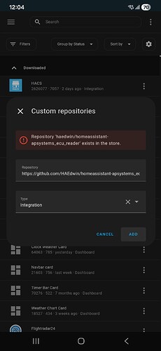

Hi
How can I pass this error?

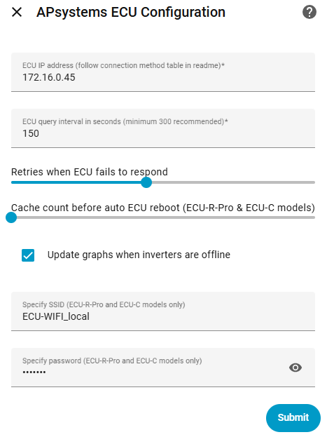

ok, you have succesfully downloaded the integration - next step is to install it in Home Assistant. On the left pane go to Settings > Devices & Services > (on the right bottom) +Add integration > (search for a brand name) APsystems > Choose “APsystems ECU reader”
Now the correct setup screen as shown earlier will appear. From here you should be fine.
When you’re new in HA some things might look a challenge but you get used to it. Remember the two steps: downloading and installing after restart.
Hi
I didn’t notice that I should’ve tried search inside the HAVS repository, I was trying to add and go to devices to add is as an integration, sorry for the mess, now its working, great job…
