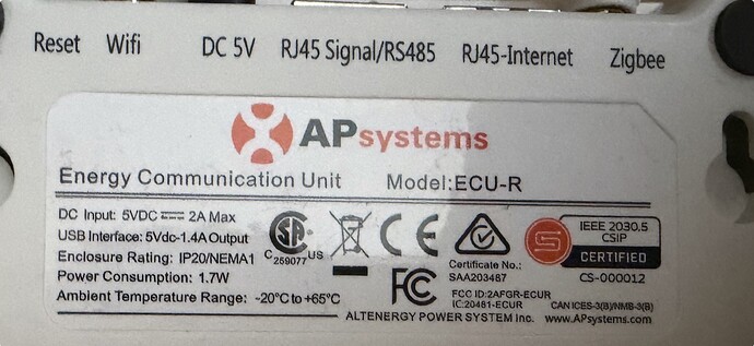

The first 4 digits are 2160. That was the first problem, I didn’t realize the model wasn’t a standalone number so I was missing it when searching for it on the bottom of the unit. I had assumed it was the 2162 since it was new, that was incorrect. According to the connection table it will not work via a wired connection. So that answers that question. This afternoon I’ll set it up via wireless on that VLAN and I’m sure it’ll be fine from there.

Question… I don’t have access to EMA Manager. Only EMA app. Is there a way to monitor my ECU?
You don’t really need the EMA manager, the ECU app is also still fine. After configuring the ECU you should be able to use this integration for Home Assistant to monitor the ECU.
Thanks. I just figured it out. I was trying to connect the device and it wouldn’t connect. It’s called Altenergy Power and is hard wired which wouldn’t work. Then I found the esp on my network connected to WiFi and that connected. Thanks!
