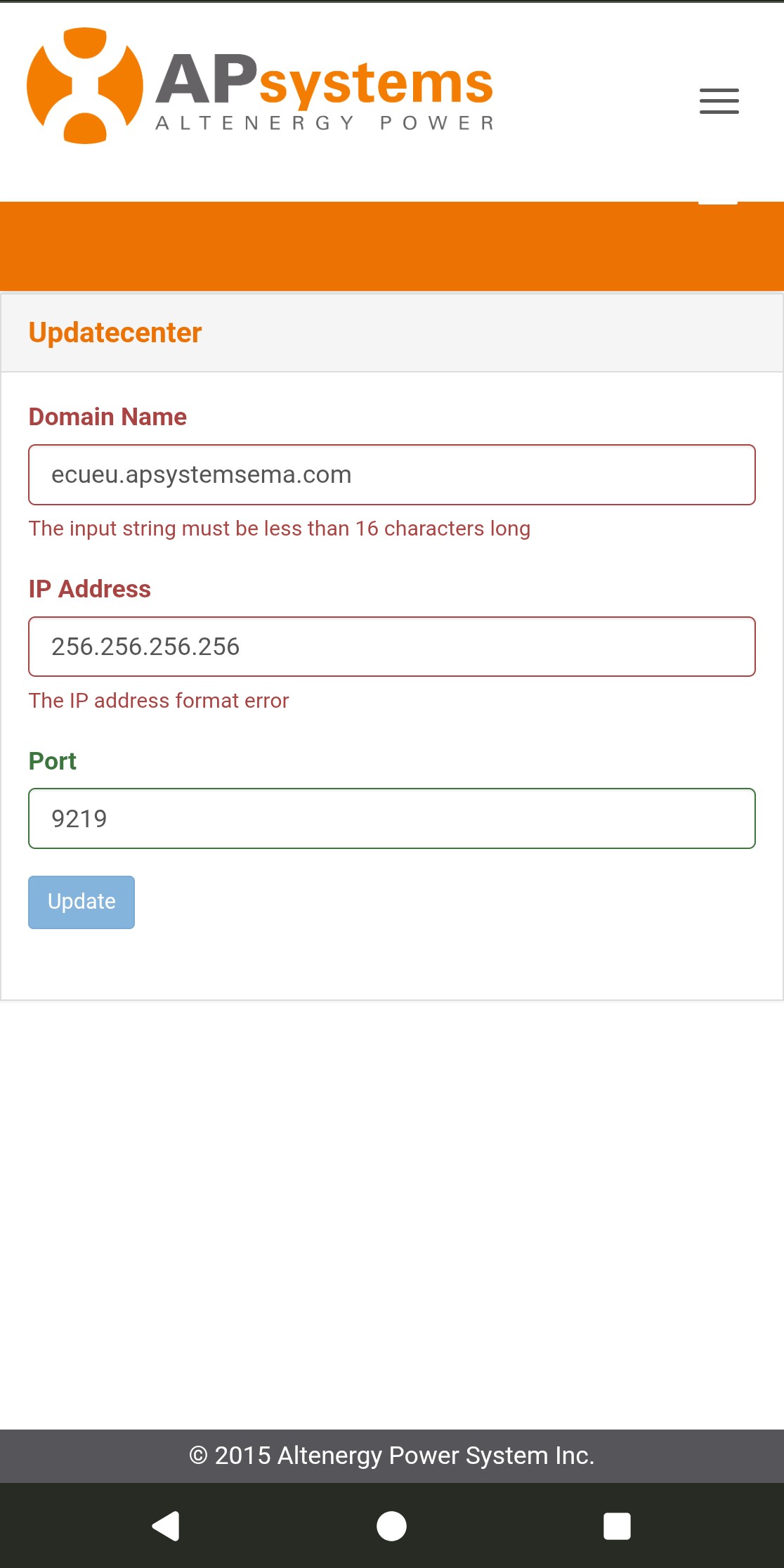

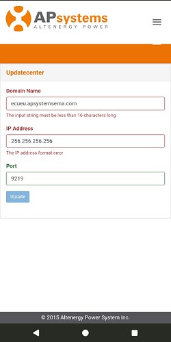

Think I've found the culprit:
Could someone tell me what this is supposed to be?
On the ECU-C it is like:
Solved, my Ecu r had the wrong (ecu-c) firmware. Updated now to the correct ecu r 1262.
