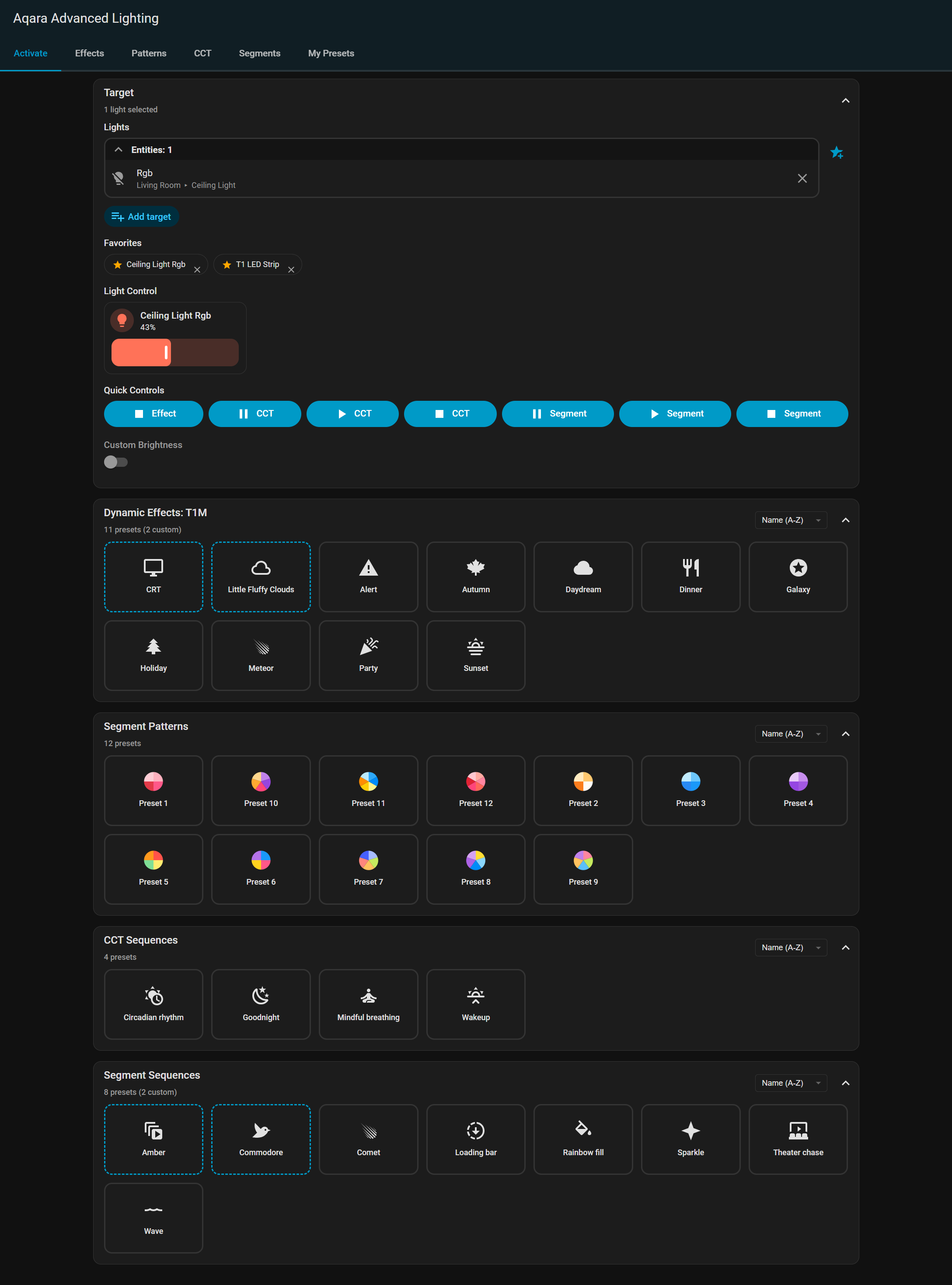

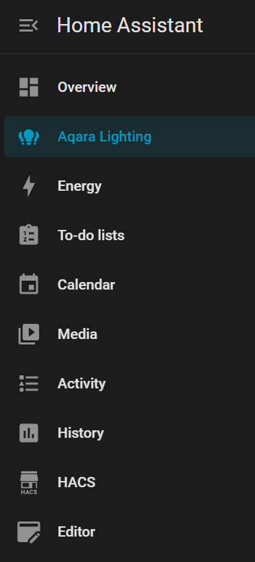

New in v.0.4.0
Frontend Panel
A new UI panel has been added to the Home Assistant sidebar for easy access to presets:
  • Sidebar Integration - Access the “Aqara Lighting” panel directly from the Home Assistant sidebar
  • UI Buttons - Interface for managing lights, effects, and sequences
  • Preset Buttons - Access to all effect and sequence presets
  • Built with Lit - Modern, lightweight web component framework for optimal performance
  • More features to be added soon
The panel provides a centralized location for controlling Aqara lights without needing to use the Developer Tools or create automations.

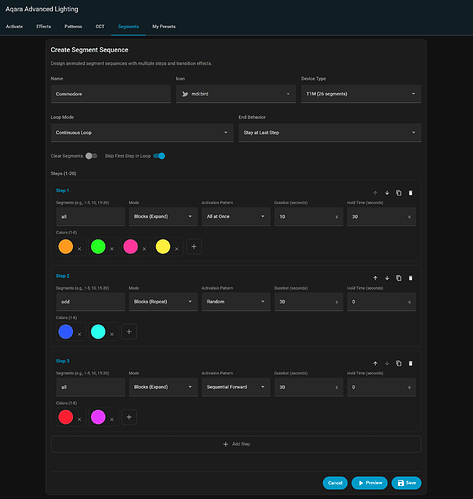

RGB Segment Sequences
Create animated segment patterns with the segment sequence feature:
Key Features:
  • Up to 20 Customizable Steps - Build multi-step sequences
  • Multiple Activation Patterns:
    • Sequential forward/reverse - Segments activate one by one
    • Random - Segments activate in random order
    • Simultaneous - All segments activate at once
  • Pattern Modes:
    • Gradient - Smooth color transitions across segments
    • Blocks (repeat/expand) - Evenly spaced color blocks
    • Individual - Custom color per segment
  • Timing Control:
    • Duration - Time to complete the activation pattern
    • Hold - Time to hold after activation completes
  • Loop Options:
    • Run once, loop X times, or continuous loop
    • Choose to maintain state or turn off when complete
  • Pause and Resume - Control sequence playback mid-execution

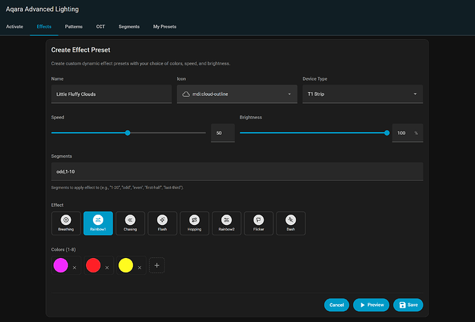

Pleased to announce v0.5.0, a major feature release that brings frontend visual effect and pattern editors, and a preset management system. This release focuses on enhancing the frontend user experience with intuitive creation tools while maintaining full backend compatibility. Update via HACS, and be sure to hard refresh the browser to clear any cached previous version.
Enhanced Panel UI with Visual Editors
The sidebar panel now includes interactive visual editors for creating custom effects, patterns, and sequences:
  • Effect Editor - Create custom dynamic RGB effects
    • Effect type selector
    • Up to 8 color pickers for effect colors
    • Speed and brightness sliders
    • Segment selector for T1 Strip effects
    • Live preview of effect settings
    • Save as custom preset

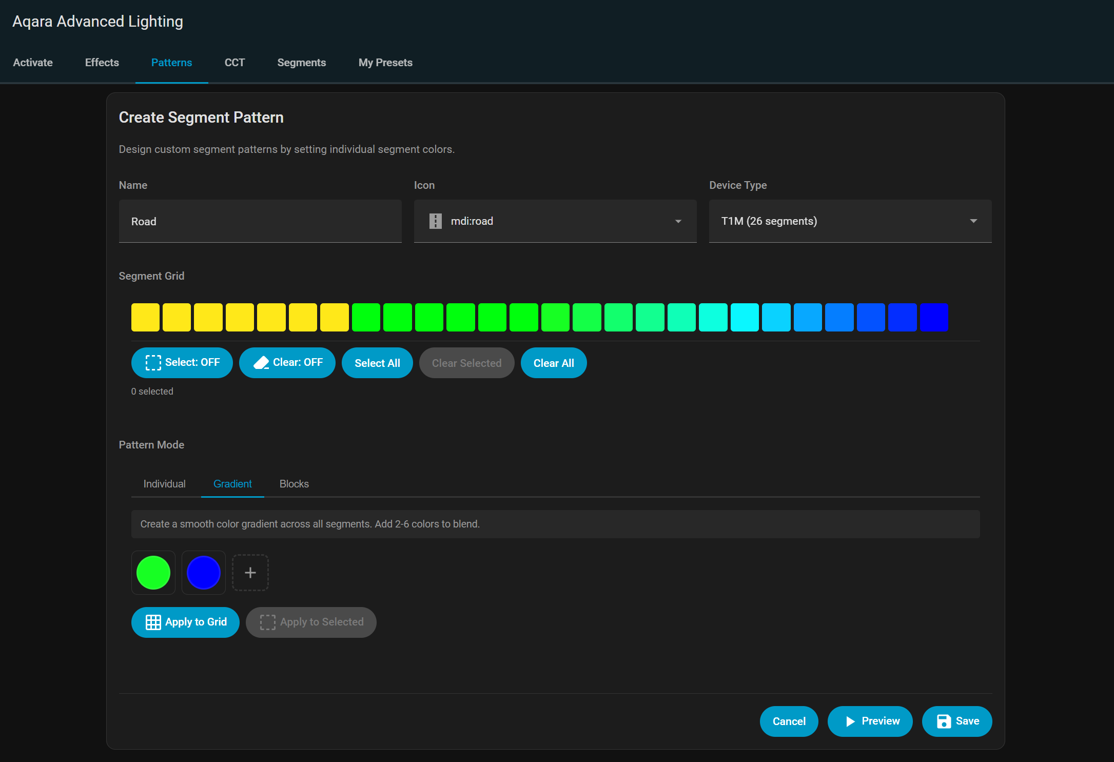

  • Segment Pattern Editor - Design custom segment color patterns
    • Visual segment selector showing all available segments
    • Color picker for each segment or range
    • Gradient and block pattern generators
    • Turn off unspecified segments option

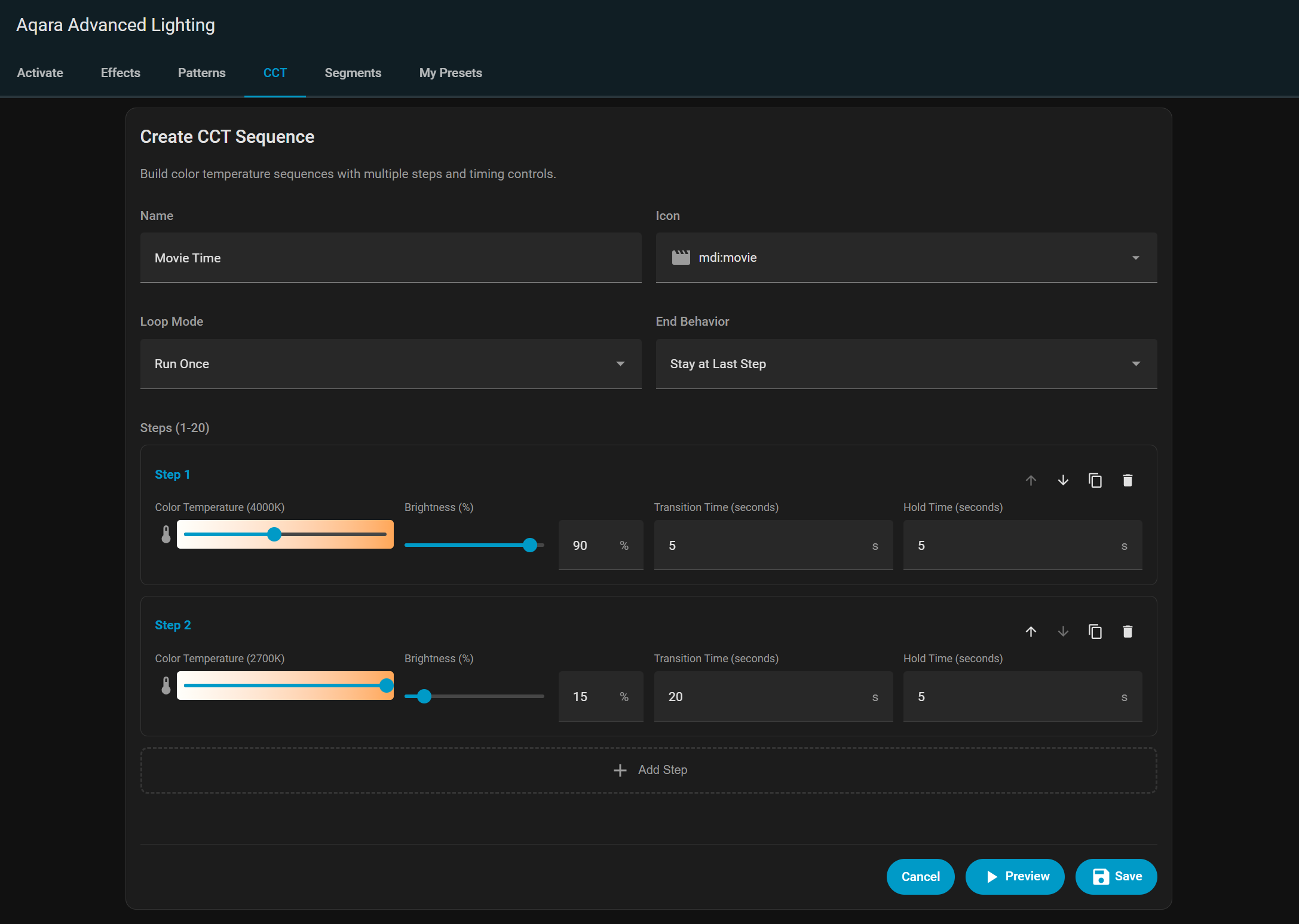

  • CCT Sequence Editor - Build multi-step CCT sequences
    • Up to 20 steps with visual timeline
    • Color temperature and brightness sliders for each step
    • Transition and hold duration controls
    • Loop mode and end behavior settings
    • Live step preview
  • RGB Segment Sequence Editor - Create animated segment sequences
    • Up to 20 steps with animation patterns
    • Multiple color modes (gradient, blocks, individual)
    • Activation pattern selector with 8 options (all at once, sequential forward/reverse, random, ping pong, centre out, edges in, paired)
    • Duration and hold controls
    • Loop settings with skip first step option
    • Clear segments before starting option

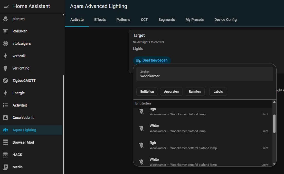

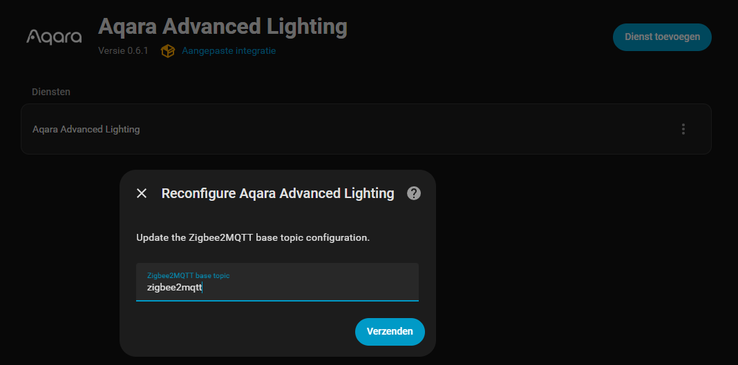

This looks awesome, but I cannot seem to get it to work with using a MQTT broker thats running in a different docker container. Is it only usable for HASOS perhaps? where MQTT is running as an addon?
My setup is using Home Assistant inside a docker container, with zigbee2MQTT inside another container. both are communicating with MQTT running in another container. everything inside home assistant works (can control all my 65 zigbee devices and I see 2 T1M lights with 2.7.2 added segmentation exposed for these lights). the base topic is configured as zigbee2mqtt, but I dont see them popup in the HACS integration.
It should work fine, I’m running HA in a Docker container and have MQTT in a separate LXC and Zigbee2MQTT in another separate LXC. What errors are you seeing in logs?

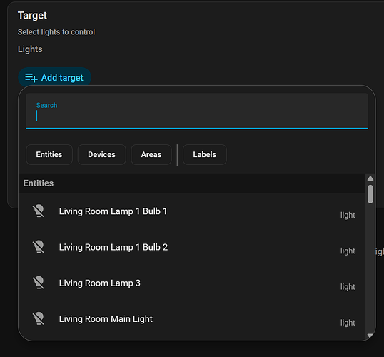

In the integration, is the entity selector empty when you click the “Add target” button? You access the integration using “Aqara Lighting” in the HA sidebar menu.
I completely missed the part where a Aqara Lighting dashboard appeared where I need to select devices… haha. I thought I would see the aqara lights beneath the integration.
Thanks for the screenshot!
Great! I’ll update the readme on Github with better clarification on accessing the integration.
