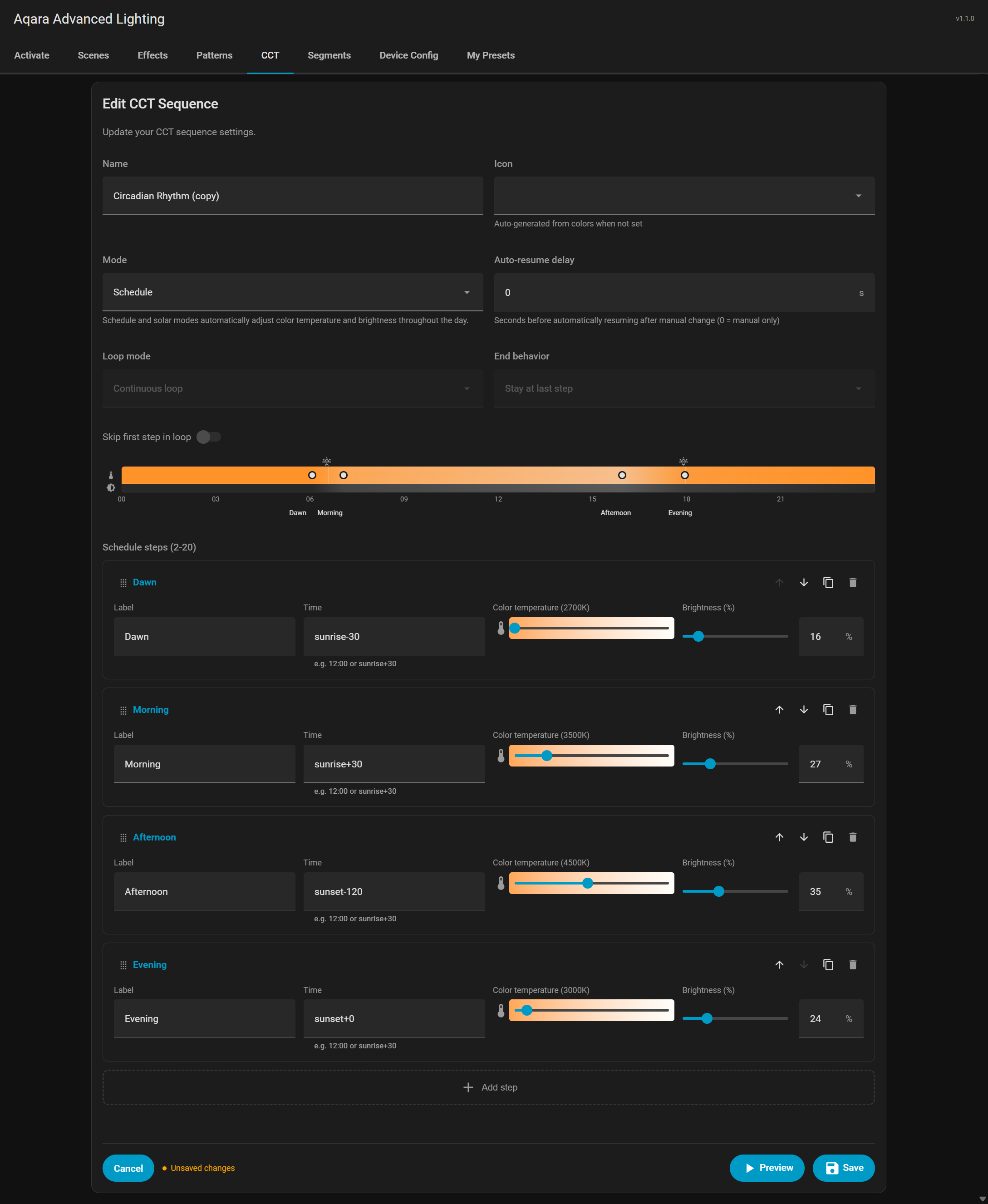

Version 1.1.0 adds solar and schedule-based adaptive circadian CCT sequences, capability-aware light adaptation for any Home Assistant light, and a new more comprehensive override detection system.
Circadian Adaptive CCT Sequences
  • Schedule steps use fixed times (12:00) or sun-relative times (sunrise+30, sunset-60)
  • Solar timeline maps elevation to time using sinusoidal sun trajectory with real sunrise/sunset positions
  • Automatic interpolation between steps on a 24-hour cycle
  • Dual-track timeline preview showing color temperature and brightness with step markers

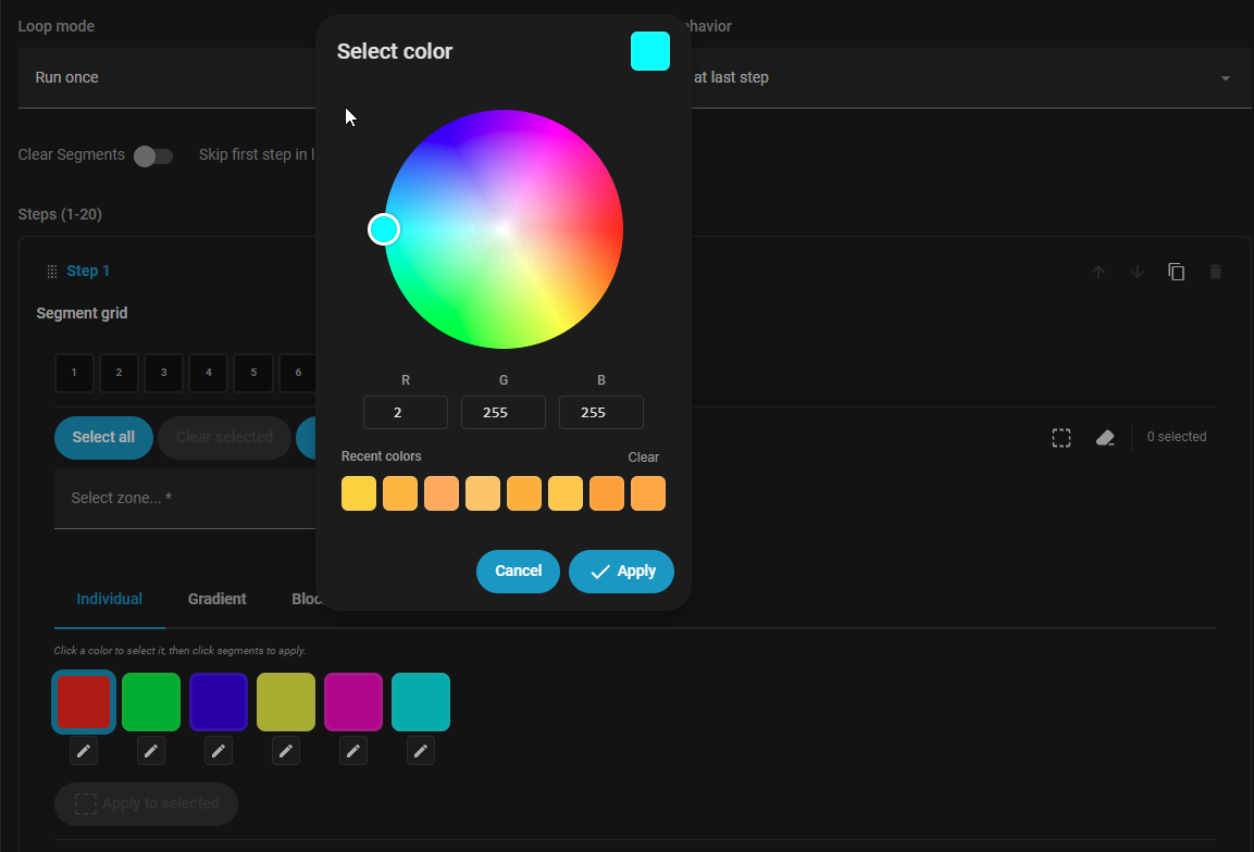

Hi, thank you for this integration. Recently I’ve switched my T1 LED strip from aqara m2 hub to HA via ZHA to use this integration.
First versions were quite bugy, now I am using the latest 1.1.0 version which seems to be much better.
I would like to create some segment sequence but struggling to set any white color (color temperature), there are only RGB.
Is it even possible to do so?
Thanks, the T1 Strip doesn’t support segment addressing on the CCT LEDs, only the RGB LEDs, it’s a hardware limitation. I guess I could expand the colour picker to make RGB versions of CCT temperatures, I’ll put it on the todo list. In the mean time you could use a tool like this to make conversions and enter the RGB values into the text input fields.

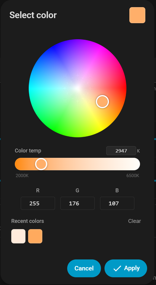

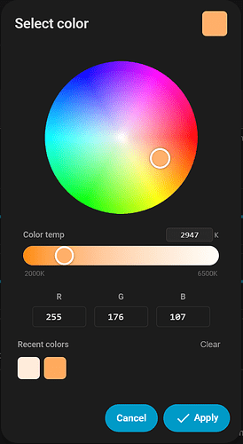

I’ve added a color temp slider to the picker modal. There should hopefully be a new beta release with it in by the weekend.
Thanks. It’s a pity that it doesn’t support also dedicated white LEDs for segments which is my main color preset. I wanted to created something like 7 minutes timer so each minute 1 segment would change the color but the rest of the segments stay on the same white color.
I was trying to use the RGB values field and I am not sure if it is bug but when I want to manualy put e.g. these numbers 255 167 88, 255 is OK, 167 will automatically change to 156 and 88 change to 89. Then clicking on the arrows for B color to adjust it, it changes the number for G colors as well at the same time :slight_smile:
