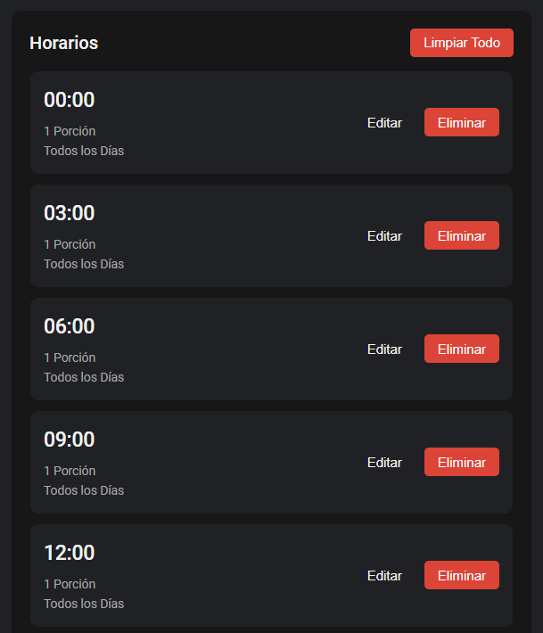

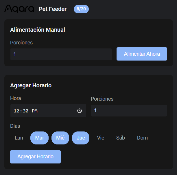

Hi, everybody.
I’ve acquired an Aqara C1 Pet Feeder and connected it via Zigbee2MQTT, but noticed that there was a limit in the amount of automatic feeding schedules to a maximum of 4 entries. I learned this is because of the inherent 255-character limit of the entity that governs the schedule.
So, I’ve decided to create my own script, with an automation and a lovelace card that would automate a feeding schedule for my cat with up to 20 entries (I thought 20 was a decent number).
Maybe, someone out there could find it useful for their own dashboard. I’ve been using it for quite some time and it seems to work fine. But do let me know if you have any trouble.
Oh, by the way. Script UI elements are in Spanish but you can easily change these to your liking. All the code, instructions, etc. are in English so it should be fairly simple to translate.

  updateScheduleList() {
    const scheduleListContainer = this.shadowRoot.querySelector('#schedule-list-container');
    if (!scheduleListContainer) return;
    const sortedSchedules = [...this.schedules].sort((a, b) => {
      if (a.time !== b.time) return a.time.localeCompare(b.time);
      return a.days.join(',').localeCompare(b.days.join(','));
    scheduleListContainer.innerHTML = `
      <div class="section-title">
        Horarios
        ${this.schedules.length > 0 ? `
          <button class="btn-danger btn-small" style="float: right;" onclick="this.getRootNode().host.clearAllSchedules()">
            Limpiar Todo
          </button>
      </div>
      ${sortedSchedules.length === 0 ? `
        <div class="empty-state">
          No hay horarios configurados. Agrega tu primer horario de alimentación arriba.
        </div>
        <div class="schedule-list">
          ${sortedSchedules.map((schedule) => {
            // Find the ACTUAL index in the unsorted array
            const actualIndex = this.schedules.findIndex(s =>
              s === schedule
            return `
              <div class="schedule-item">
                <div class="schedule-info">
                  <div class="schedule-time">${schedule.time}</div>
                  <div class="schedule-details">
                    ${schedule.portions} porción${schedule.portions > 1 ? 'es' : ''} • ${this.formatDays(schedule.days)}
                  </div>
                </div>
                <div class="schedule-actions">
                  <button class="btn-secondary btn-small" onclick="this.getRootNode().host.editSchedule(${actualIndex})">
                    Editar
                  </button>
                  <button class="btn-danger btn-small" onclick="this.getRootNode().host.deleteSchedule(${actualIndex})">
                    Eliminar
                  </button>
                </div>
              </div>
          }).join('')}
        </div>

      <ha-card>
        <div class="header">
          <div class="title">
            <img src="https://www.aqara.com/wp-content/uploads/2023/05/aqara-logo.png" class="logo" alt="Aqara">
            Pet Feeder
            <span class="count-badge">${this.schedules.length}/20</span>
          </div>
        </div>
        <div class="section">
          <div class="section-title">Alimentación Manual</div>
          <div class="manual-feed">
            <div class="form-group">
              <label>Porciones</label>
              <input type="number" id="manual-portions" min="1" max="10" value="1">
            </div>
            <button class="btn-primary" onclick="this.getRootNode().host.manualFeed()">
              Alimentar Ahora
            </button>
          </div>
        </div>
          <div class="section-title">${this.editingIndex >= 0 ? 'Editar Horario' : 'Agregar Horario'}</div>
          <div class="form-row">
              <label>Hora</label>
              <input type="time" id="schedule-time">
            </div>
              <input type="number" id="schedule-portions" min="1" max="10" value="1">
            </div>
          </div>
            <label>Días</label>
            <div class="days-selector">
              ${['mon', 'tue', 'wed', 'thu', 'fri', 'sat', 'sun'].map(day => {
                const dayNames = {mon: 'Lun', tue: 'Mar', wed: 'Mié', thu: 'Jue', fri: 'Vie', sat: 'Sáb', sun: 'Dom'};
                return `
                <label class="day-checkbox-label">
                  <input type="checkbox" class="day-checkbox" value="${day}">
                  ${dayNames[day]}
                </label>
              `}).join('')}
            </div>
          </div>
          <div class="button-row">
            <button id="add-schedule-btn" class="btn-primary" onclick="this.getRootNode().host.addSchedule()">
              Agregar Horario
            </button>
            <button id="cancel-edit-btn" class="btn-secondary" onclick="this.getRootNode().host.cancelEdit()">
              Cancelar
            </button>
          </div>
        </div>
        <div class="section" id="schedule-list-container">
            Horarios
                Limpiar Todo
              </button>
          </div>
            </div>
                  s.time === schedule.time &&
                  s.portions === schedule.portions &&
                  JSON.stringify(s.days) === JSON.stringify(schedule.days)
                return `
                        ${schedule.portions} Porci${schedule.portions > 1 ? 'ones' : 'ón'}<br>
                      </div>
                    </div>
                        Editar
                      </button>
                        Eliminar
                      </button>
                    </div>
                  </div>
              }).join('')}
            </div>
        </div>

Add the card to your dashboard by looking for the new Pet Feeder Card and then completing the name of your Zigbee Pet Feeder. Use the YAML code below (my feeder’s name is ‘Aqara Pet Feeder’):
type: custom:pet-feeder-card
entity: sensor.pet_feeder_schedule_tracker
device_name: Aqara Pet Feeder
Some screenshots. Again, my UI is in Spanish but it’s easily editable.
