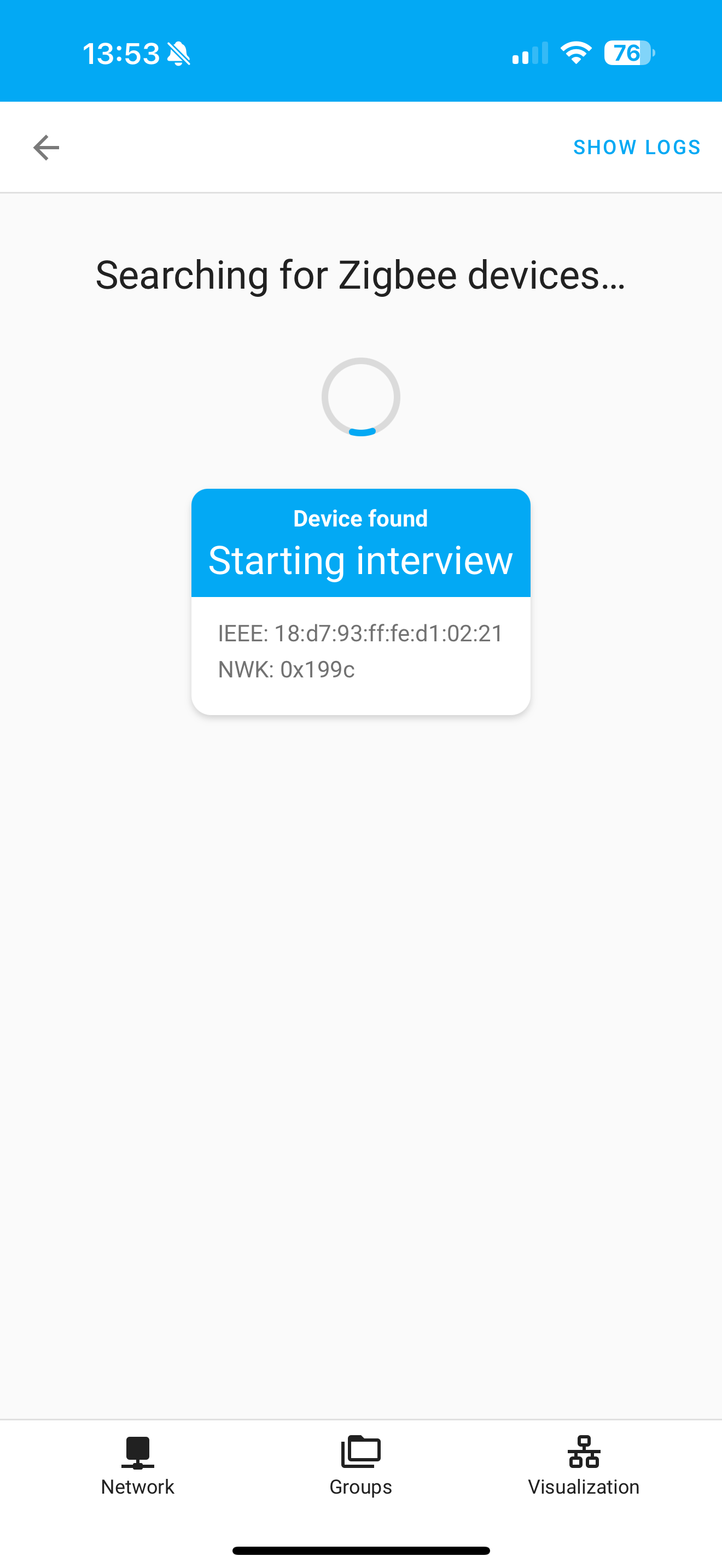

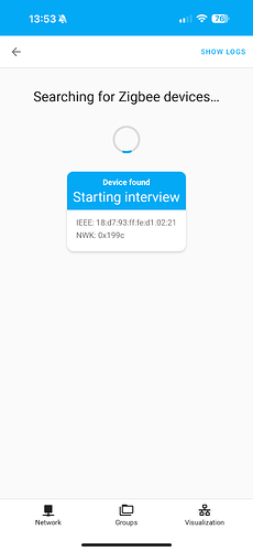

I recently got a C1, when I turn it on, ZHA seems to find it (at least it’s finding something…) and gets stuck in the interviewing stage… after about 30 seconds the LED goes out and all buttons are non-functional (i.e the manual feed button, and holding down reset doesn’t do anything unless I recycle the power).
Is this normal behaviour and I’m doing something wrong? Or did I get a dud?
A few things…
It only stays in pairing mode for 30 seconds.
You can try keeping the pairing alive by pressing the pairing button (or you might need to hold the pairing button down again until it beeps).
It should show up in the logs as aqara.feeder.acn001
. You can also search the logs for the NWK and IEEE to see what information it is providing to the coordinator during pairing.
You could try pairing it through a specific router device.
Occasionally when I have a device that doesn’t seem to finish the interview and configuration while on this screen, but it does finish after a while. I just go back to the device list screen and check on it in a few minutes. I’ve found devices that I thought failed interview and configuration there.
Turns out it was a dud USB A plug connector
