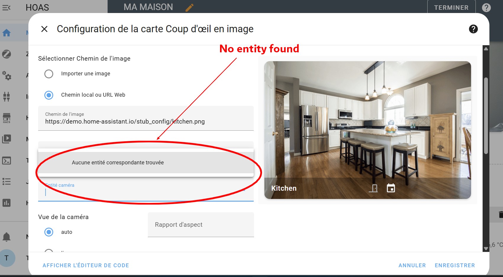

I installed the AqaraPOST addon which created 83 entities. The entities work well and I have access to PTZ actions. What I didn’t understand is how to display the camera feed in the dashboard. Because the AqaraPost addon didn’t create an entity that allows me to retrieve the feed. For the moment I’m using the Go2rtc module which gives me the RTSP feed and WebRTC (HACS) source to add the card that will be able to display the video of this feed in the dashboard. But I wanted to use the “Picture Glance” card to display the feed from my camera. Except that it’s impossible without the camera entity that returns the feed to me.

my addon does not handle video. i use go2rtc with webrtc, you can add PTZ controls in the webrtc card by creating scripts tied to the PTZ button and add them above the video by adding the settings you find in my repository.
AqaraPOST-Homeassistant/webrtc_ptz_setting at main · sdavides/AqaraPOST-Homeassistant · GitHub

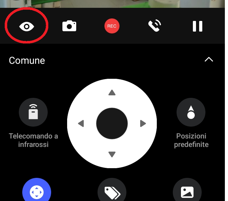

In any case “video active” should replicate the button with the image of the eye:

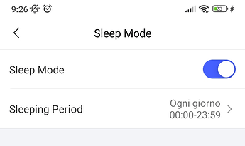

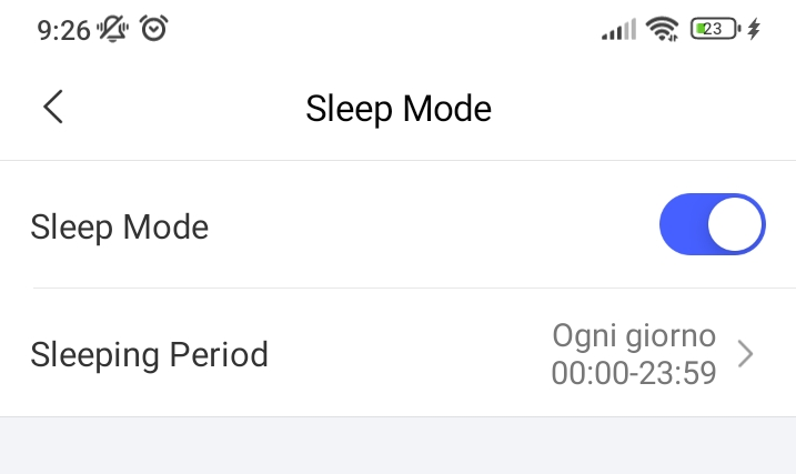

I added the “Sleep Mode” button:
Does it behave the same way from the official app?
