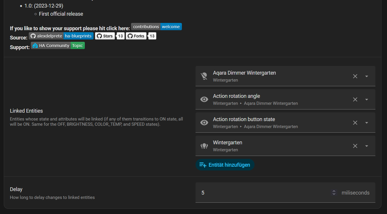

Last week I bought the Aqara Dimmer Switch H2 EU. The device works fine to control non smart lights as it just works as a normal dimmer. It’s visible in HA as a light so you can easily control it that way. But what i would like to do is to use the dial on the switch to dim zigbee lights. I think that should be possible with an automation but I can’t seem to find how to achieve this. When you rotate the dial it changes the brightness of light entity in HA. So i would like link the brightness of the switch to other lights.
I found a blueprint that did the job!

If the device is in ‘decoupled’ mode you should see ‘action rotation’ sensors. And these sensors are used in an automation for the dimming.
What automation are you using? The blueprint appears to need brightness which is not available for me as the brightness of the physical dimmer needs to be set to full to provide power to the smart light. I have the dimmer in decoupled mode.
What I forgot to mention is that I only connected the dimmer to power. I bypass the actual relay because that doesn’t work because I use Zigbee lights and they need direct power instead of ‘switched’ power.
So for my own clarification as english is not my first language. You are connecting the switch via zigbee to home assistant. Then put the switch in decoupling mode (How did you achieve that?). Then in HA you have a entity for the dimmer? Which controls your smart bulbs with an automation?
Am I right with that?
For me it’s working like that. You don’t need to link every action.

For anyone who wants to dimm in detached mode, this is my (far from perfect) solution: Aqara knob / Dimmer Switch H2 EU detached mode brightness control
