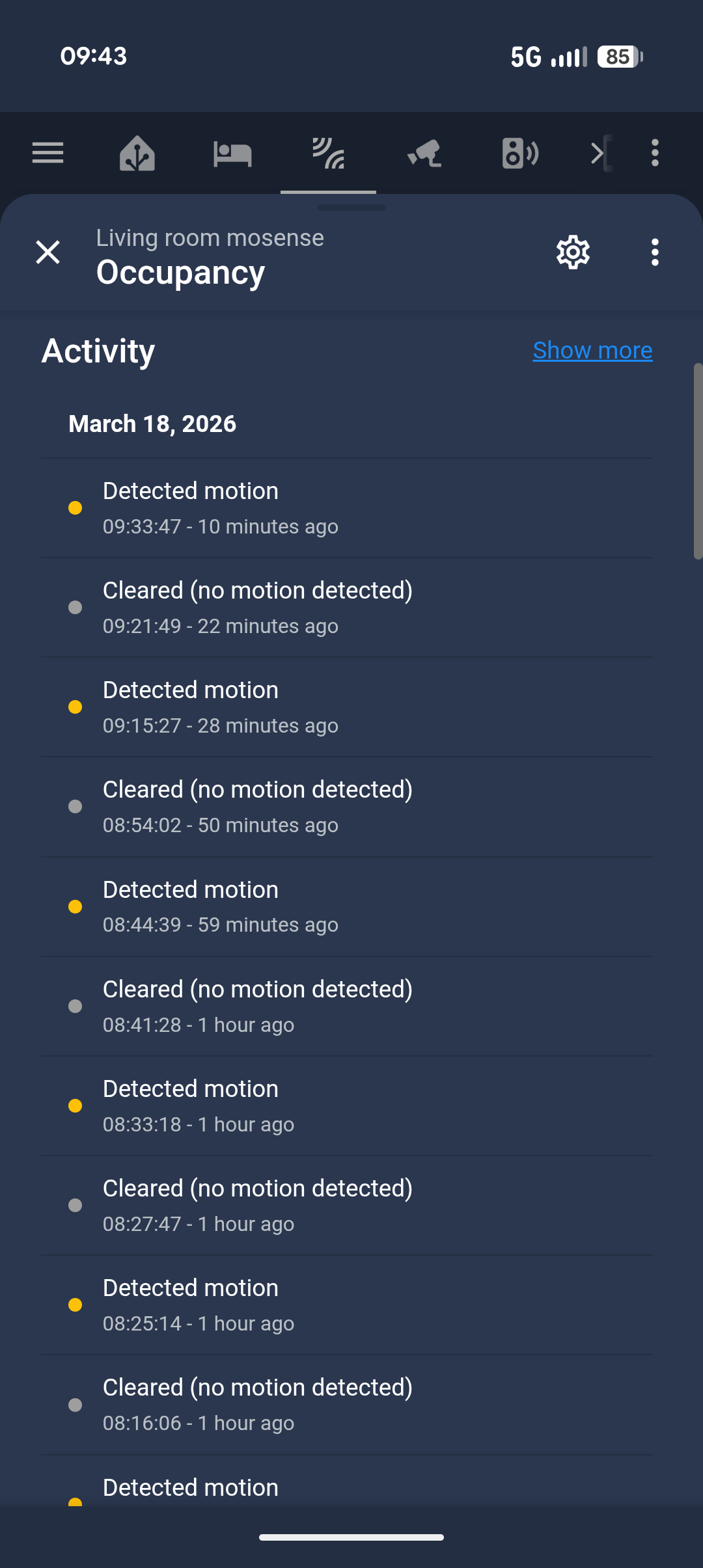

I’ve had the same problem. Received mine a couple of weeks ago and set it up in my living room, where I already had an Aqara P1 motion and a powered Tuya presence sensor. I have this set up in several other areas of my home, including the kitchen, dining room, family room, bathrooms etc. I switched the firmware to Zigbee using the Aqara app and added it to HA via z2m.
Unfortunately, my experience has been atrocious. I’ve enabled the AI Interference Source Self identification and AI Sensitivity Adaptive settings, and have ran the AI Spatial learning several times. I’ve also set the motion sensitivity to low (which I’m not sure maybe any difference given that the sensitivity is supposed to be adaptive). I have the presence setting to both.

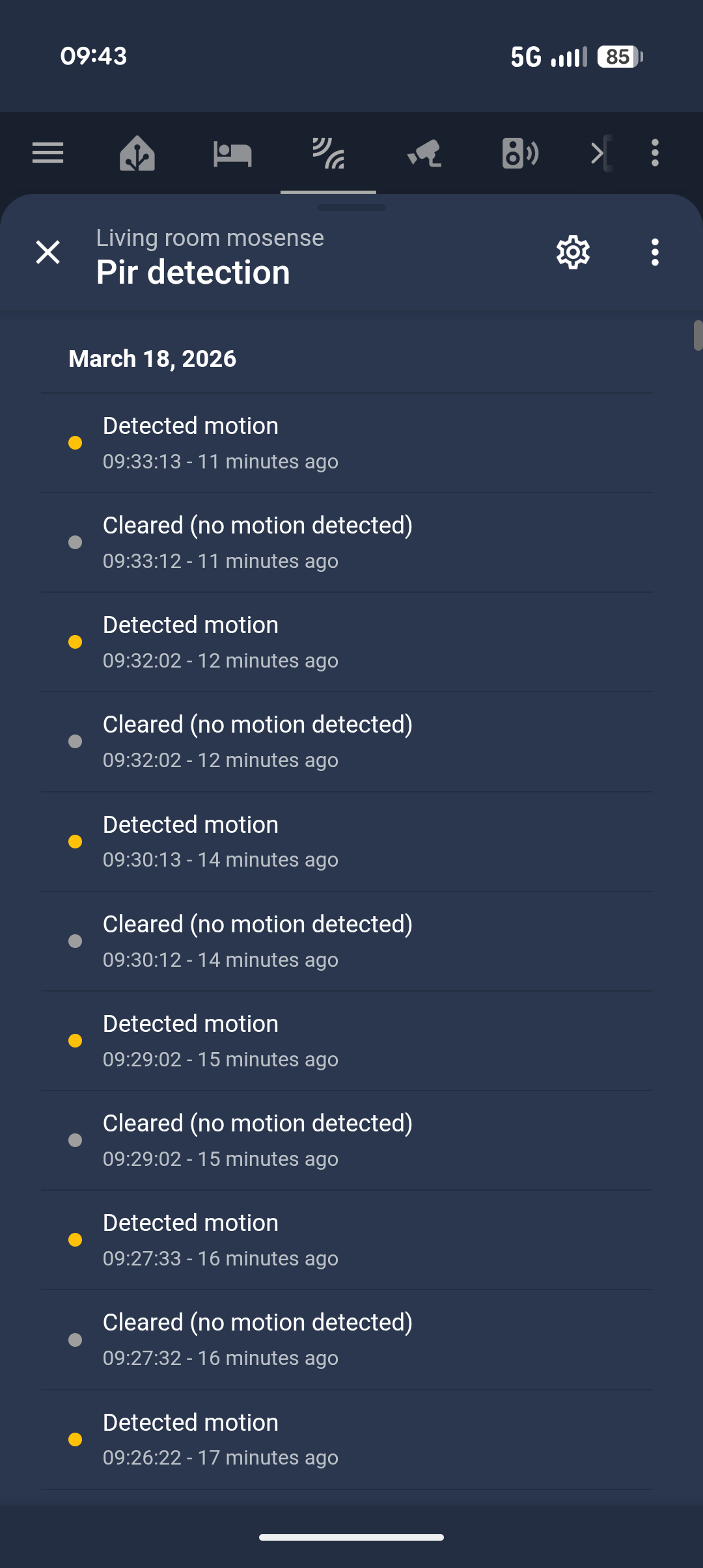

The PIR sensor seems to fire constantly, like literally all the time, even if no one’s in the room. See attached screenshot. I’m not sure that this will do to the battery, but I assume this will cause undue drain since the PIR is the one supposed to turn on the mmWave sensor. The presence seems to perform a bit better, so perhaps the AI is discerning between real movement and interference, but it doesn’t change nearly fast enough to trigger my automations as the Aqara P1 does. The FP300 is not pointing at any heat sources, and the Aqara P1 experiences no issues.

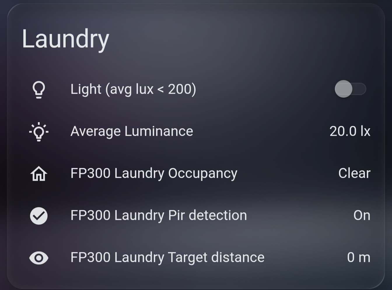

I’ve got the same issue with my new FP300 on the latest firmware. The PIR is almost always on and it’s in the same laundry area where I had a normal Aqara PIR motion sensor prior without any false triggers. Also, I have the detection method to both (hybrid mode), and according to the resources I’ve read, my result below should not be possible e.g. The presence can’t possibly be ‘clear’ when the PIR is ‘on’. Something is very wrong.
[UPDATE] Just sparked up my 2nd unit and the PIR on this one seems to be operating normally sitting right beside the ‘bad’ one.

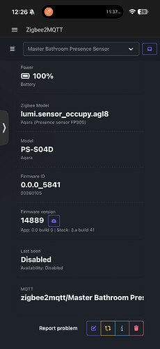

Here's my z2m config for one of them:

Sensitivity is set to High on all of them and interference self-id is on (with adaptive off). I went through the process of resetting them, then using the aqara app to switch to thread and then back to zigbee in order to force the update. Once updated I also used the Reconfigure button in Z2M for each of them
My config matches yours, apart from the High sensitivity. Might have to reset & re-pair - did the firmware update via Z2M without having to switch protocols, so that's the only difference I'm seeing.
