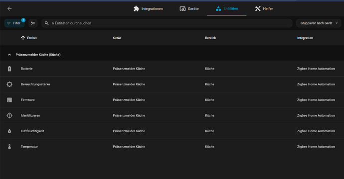

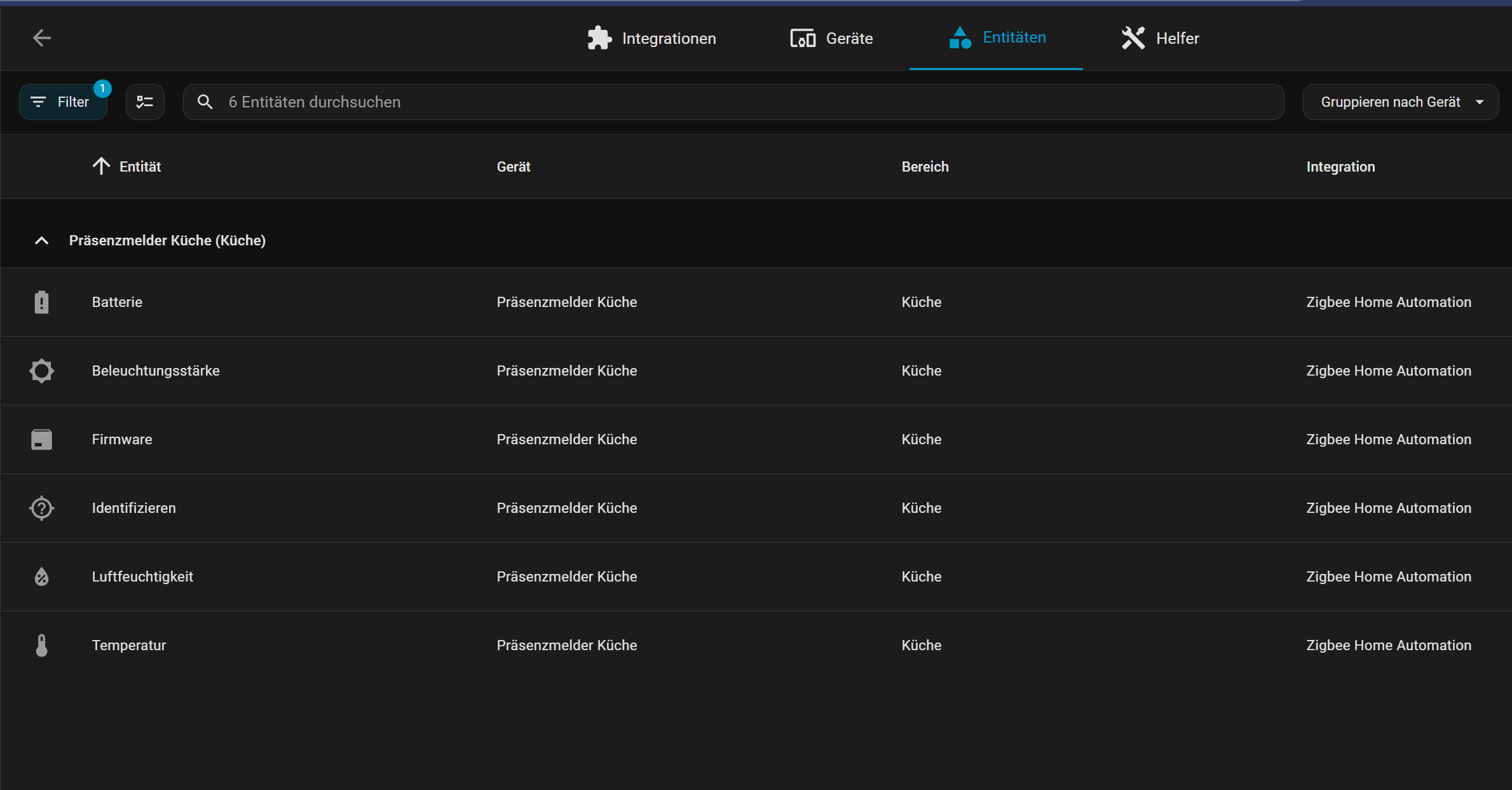

I bought the Aqara FP300 but I struggle to connect it to HA. I have the Sonoff Zigbee 3.0 USB Dongle with other Aqara devices connected and that works fine.

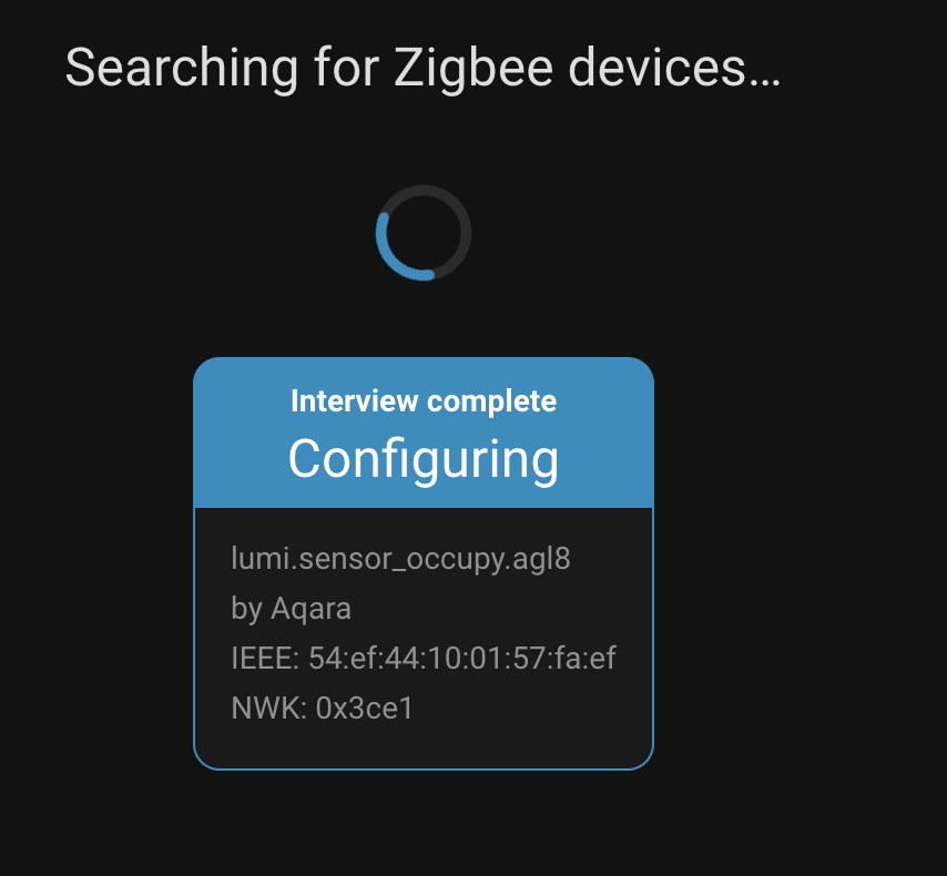

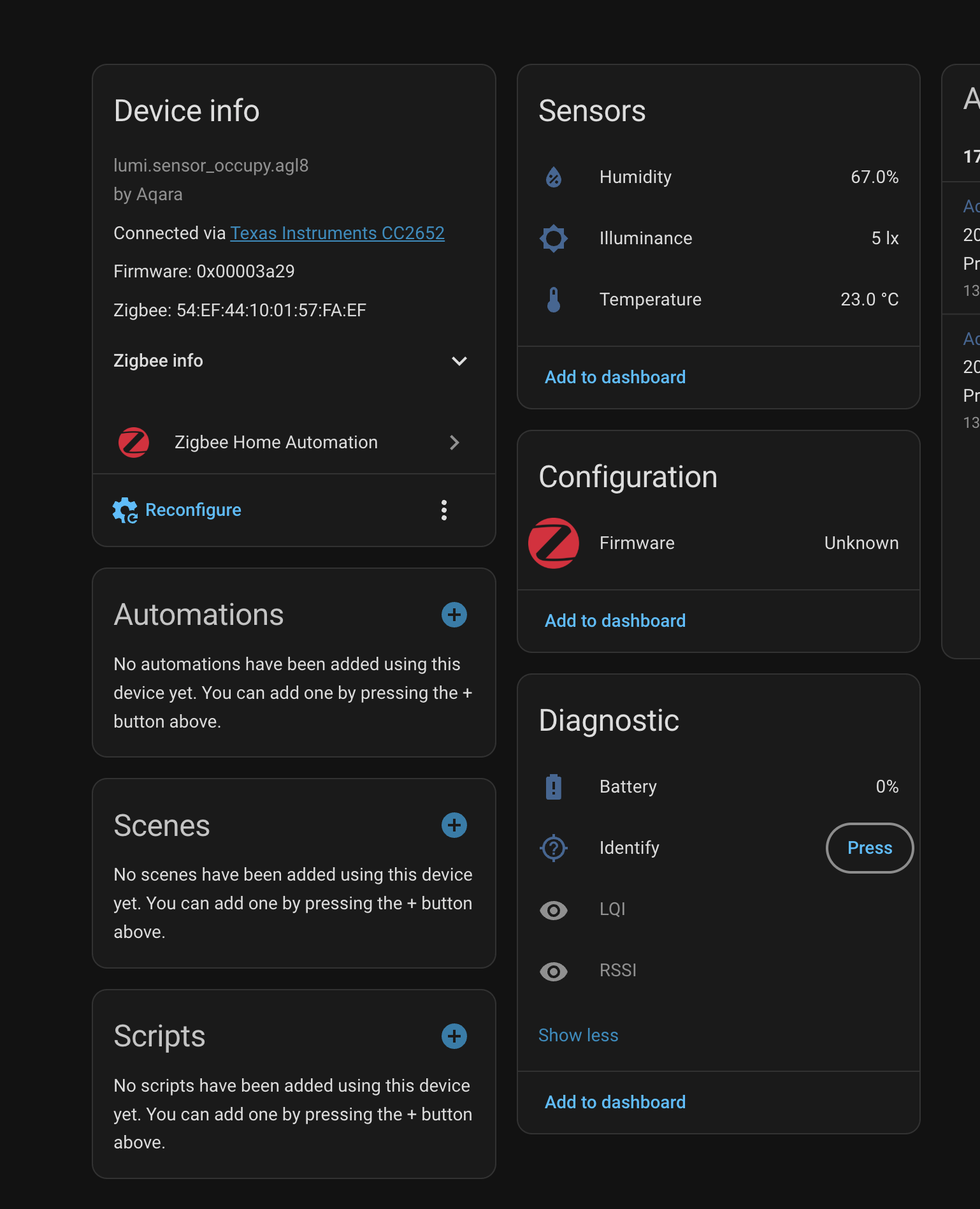

When I pair the FP300 via Zigbee, it sometimes stays stuck at “Configuring” and sometimes it completes sucessfully. In both cases, the configured device does not show any “presence” entity thought.

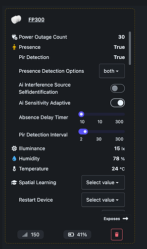

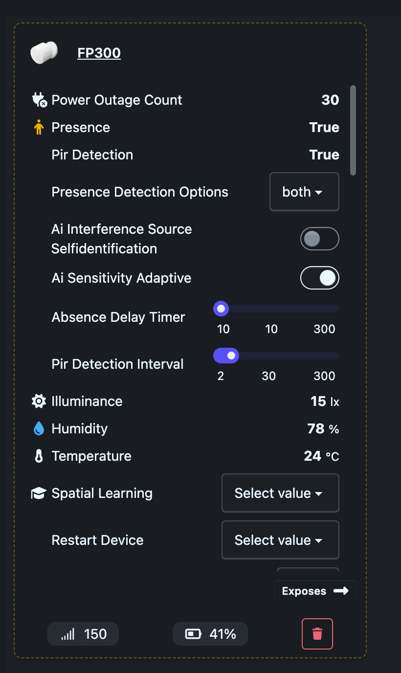

I tried adding it directly Zigbee2MQTT and the device seems detected correctly there. I don’t use Zigbee2MQTT in HA though.

I ended up using only Zigbee2MQTT and removed compeltely the Zigbee HA integration

If zha works fine with 12 device, stay on. and buy new coordinator and setup Z2M. Support more device and exposes. for FP300 you need to use Z2M, zha not support much.

i have 3 FP300 and works very well

You can only use one zigbe device at one place, so you cant have device in zha and z2m at same time. Remove it from zha and pair it like new in z2m. FP300 will you get more sensor in z2m, best option is z2m for fp300
