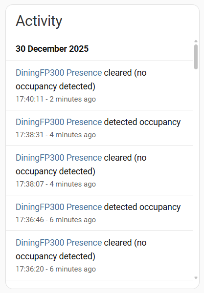

the FP300 works in 80% correctly, but in the last 20% I have no presence detection…
I can stand in front of the sensor and wave my hand, no presence will be deteceted…

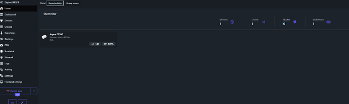

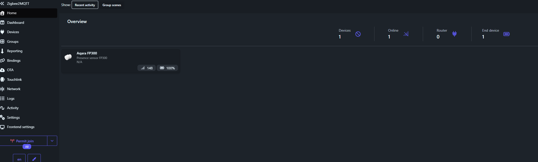

Added one FP300 with Z2M. Everything seems fine. It did not work with ZHA.
But it does not show availability. It says N/A.
I’m new to HA and Z2M so i do not know if this is normal.
Also in the device overview page LQI does not seem to update. I have different value if i go to Network Map. ~135 in an apartment. Hope that is fine.

You need to enable availability in the Z2M settings > Availability in order to get availability reporting for all your devices.
It’ll be fine as long as the device works. Don’t worry too much about it

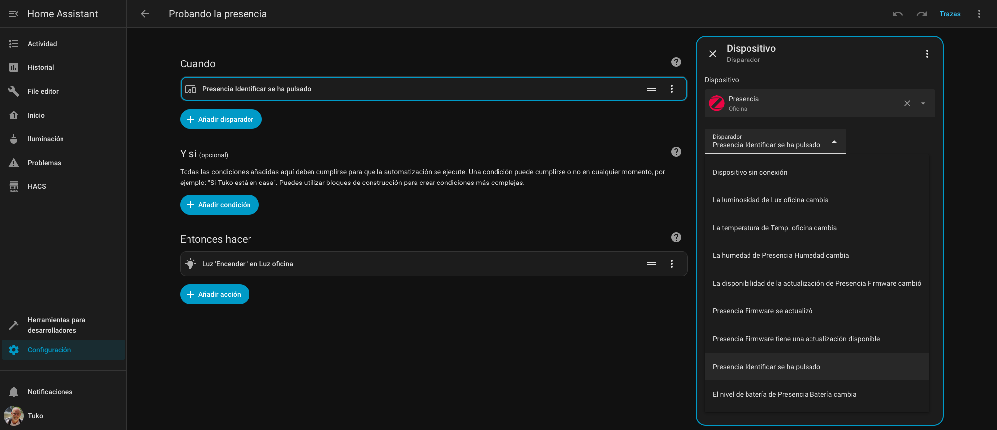

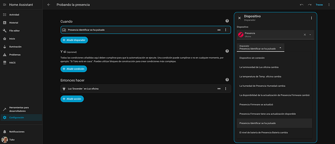

I have update 2025.12 and the sensor is integrated in ZHA. The presence sensor still doesn’t work for me. Also the battery shows Unknown. I tried to detect a movement with a simple automation, but it doesn’t appear in the configuration UI.
Anyone can help with this?

Availability is already enabled
I think that is actually the last seen status.
Last Seen is disabled by default (read here). You can turn it on in Z2M > Settings > Settings > Advanced
