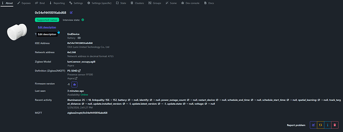

Good afternoon everyone. I just received my first FP300 and I am really struggling to get it working properly with Z2MQTT. It pairs perfectly fine. Just to confirm the initial steps taken -
  1. Used the Aqara app to switch from Thread to Zigbee.
  2. Added to Z2MQTT
  3. Verified that all of the settings are exposed and they are.
Just as an FYI, I am using ZHA and Z2MQTT. I have two conbee III adapters. They are on different channels so this should not be a problem.

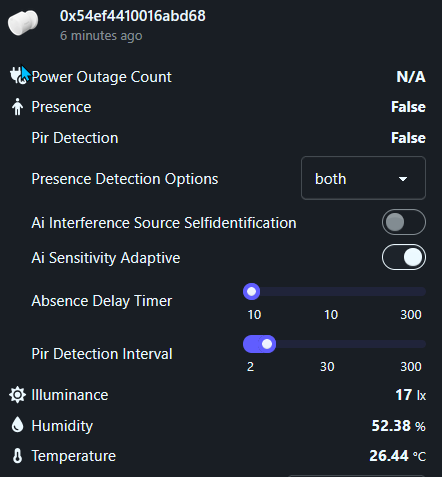

So now to the issue. Just starting at the top level. I have the FP300 sitting right in front of me. My LQI strength is 180 so the connection is very strong. Availability shows "Online" (i enabled it in settings). The problem is the device NEVER detects Presence OR PIR detection. The FP300 has been joined to Z2MQTT for 5 or 6 hours and it has NOT changed from False.
I have not made any changes to the setting of the device in M2MQTT.
If I watch the logs the ONLY the only thing that ever shows up is this -

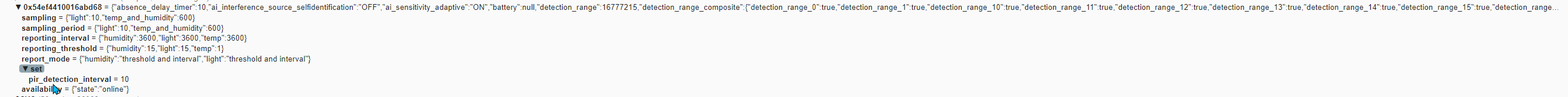

This screenshot if from MQTT Explorer

Press the button on it & check if it reports presence. If it doesn't, press it again & click Restart Device in the Z2M exposes tab.
I also suggest you press the button & click Spatial AI in Z2M so it "learns" about the room. You'll need to get out of the room before starting, otherwise it'll assume you're a piece of furniture
Thanks for the suggestion @ShadowFist. Unfortunately that did not change anything. I am pretty confident the Spatial AI ran as I see this in the Z2MQTT logs -
[5/29/2026, 3:43:36 PM] frontend:api: Sending {"topic":"0x54ef4410016abd68/set","payload":{"spatial_learning":"Start Learning"}}
I am assuming the device is restarting when I push the "restart button" but im not exactly sure how to tell as the LED never comes on or anything after a restart.

Well, I ordered a second FP300 and it just just showed up. Used the Aqara app to switch to Zigbee. Connected to Z2MQTT and this one is not working right either. Its pretty funny. The original one is showing "False" for Presense and Pir Detection, the new one is showing True yet I have it covered with a towel. This is FRUSTRATING!! So it is obviously something with my setup.
It didn't restart. If it had, Power Outage count in your screenshot would be 1 (or higher) instead of N/A.
Are you pressing the button on the device to wake it up just before pressing restart device in Z2M?
