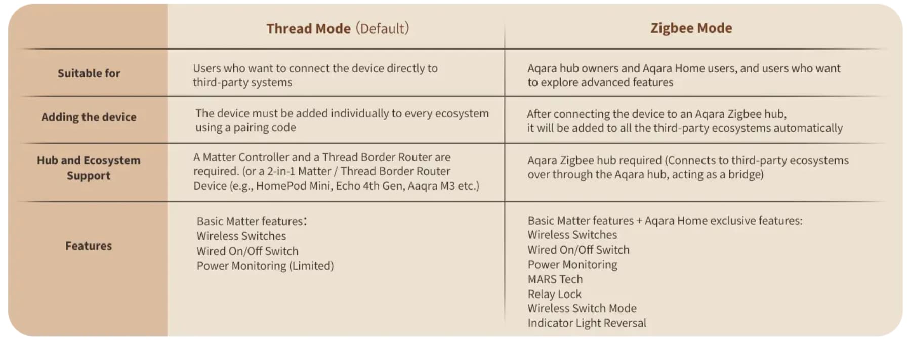

Chances are your switch is still in matter mode. You need to switch it to zigbee mode. Read this and scroll down to the “Changing Communication Protocol” section.

I could be wrong, but perhaps the lower switch actions are not exposed to Home Assistant in Matter. I’m using Zigbee2MQTT and they are exposed.
According to the product page, Matter has no support for Wireless switch mode (double press & hold). You need to switch to zigbee to get them

Those refer to the features under Aqara app. I’ve connected all the switches via zigbee to the M3 and then I connected the M3 via matter to Home Assistant.
I can see the double press under the Aqara app, but not in Home assistant.
It seems that who connected the switches via a 3rd party zigbee controller has more functions in home assistant :sweat_smile:

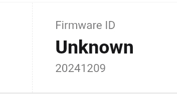

I’ve not seen any. In fact all my H2 switches (single and double) show this in Zigbee2MQTT

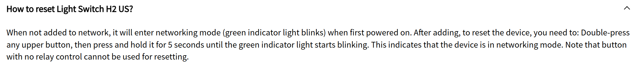

I had such high hopes for this switch but… have the morons really put the leave network/reset command so that it triggers half the time I’m trying to use the “hold” actions? Has this been updated in FW I haven’t got or is it really this monumentally stupid?
Weird. It should only reset the network if you do double press + hold for 5s. Got this from the H2EU product page (ignore the “US” in the title)
I agree. And it even says “top button”. I definately do not hold the top buttons as it does nothing. I mean it’s possible I double press and then hold the bottom button but that should be a fully valid use case… I have another switch I will check as well and update FW.
