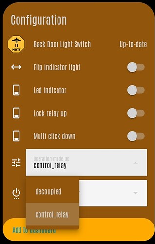

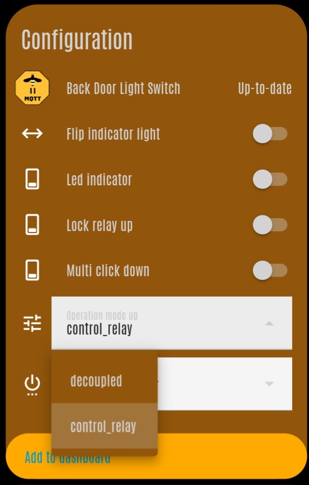

Hey there - would be keen to hear how you managed to decouple the top button from the relay.
Did you have to go through the aqara app through the hub or did you manage to do everything without relying on the hub ?
I am redoing the house and planning on installing a bunch of those h2 switches everywhere but I’m not 100% clear yet on the integration with HA.
I know I can always get the hub and then link the hub to HA (a-la Hue light) but would love to avoid having to do that.
The configuration to decouple the relay is available in Zigbee2MQTT, no additional hub required.

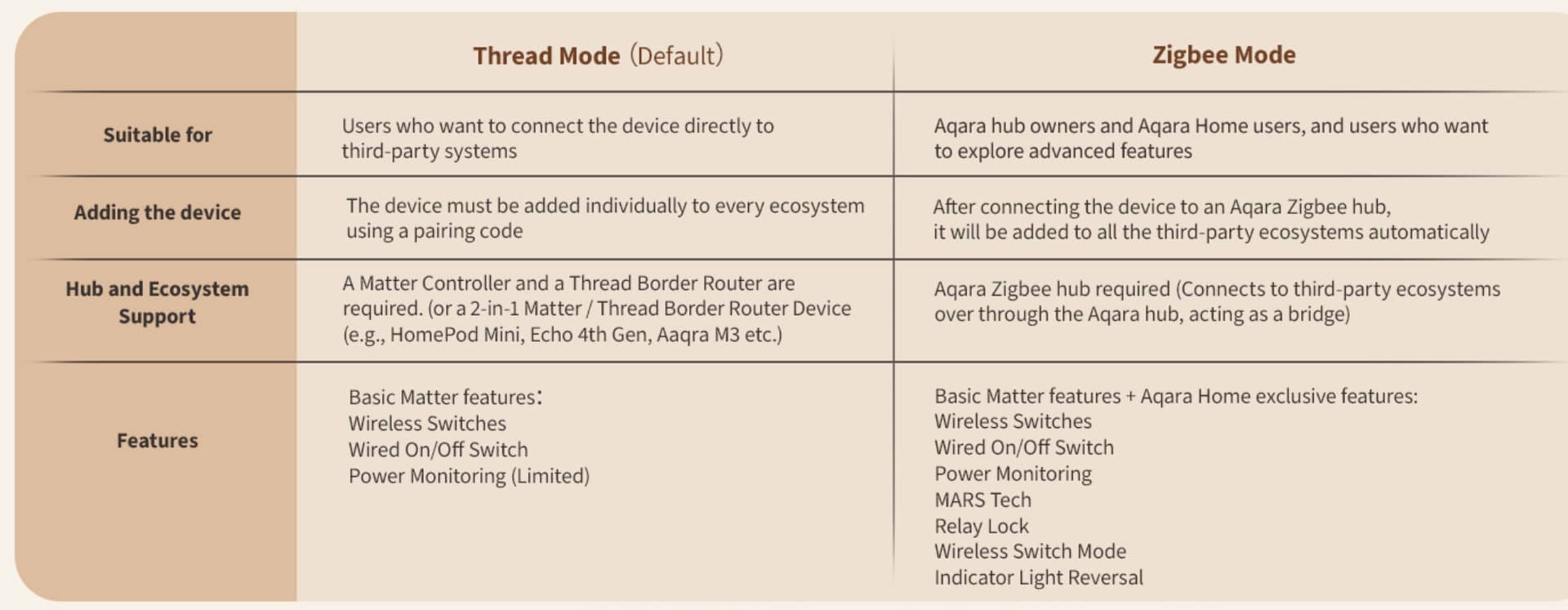

When I connect something over Thread, do I need then a specific integration for that device. For example, the Aqara H2 EU. Say I connect it to HA over thread, how do I get the different actions/entities etc that I would get using Zigbee2MQTT ?
Also - did you have to jump through any hoops to connect them over zigbee ? The package really only advertises Thread.
You can’t use Thread with Z2M. You have to change the H2 to use Zigbee using the Aqara app.
EDIT: You definitely have to switch to Zigbee if you want decoupled mode (Wireless Switch Mode) anyway. Thread implementation for these is missing a bunch of features compared to Zigbee
Thanks for taking the time.
Everything is clear now. Zigbee + Z2M + aqara app it is.
Welcome. In case I wasn’t clear enough in my earlier post: You do NOT need an Aqara hub for the switches (despite what their marketing material from my screenshot says). All you need is a Z2M supported adapter - the app is only used once to switch from thread to zigbee and does not require their hub.
