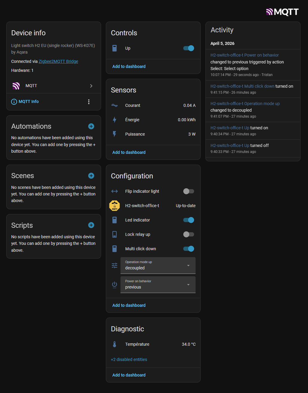

I have decoupled it and i see the events flying in when I use the top and bottom buttons.
What I’m confused by is how to then link those events to stuff happening to the lights.

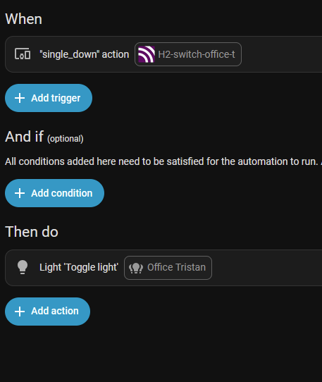

@ShadowFist

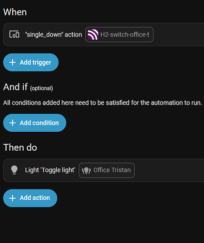

I have tried this automation:
But no luck and I don’t know how to debug it really… Any pointers would be greatly appreciated !

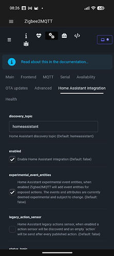

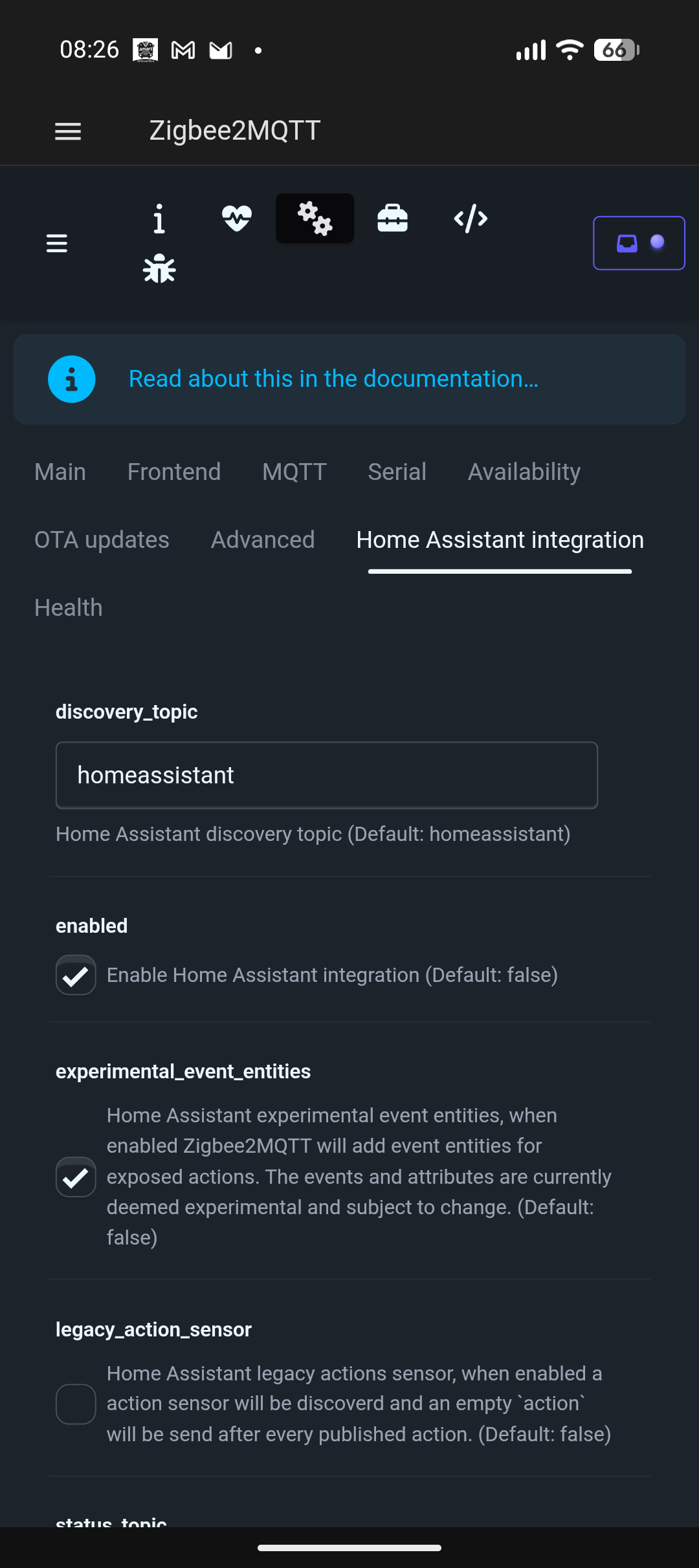

Those blueprints are meant to be used with Z2M 2.0+ and you have to enable experimental_event_entities in Z2M settings
Hey thks for taking the time.

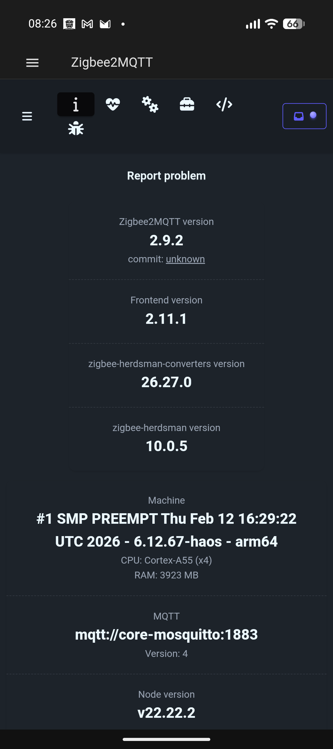

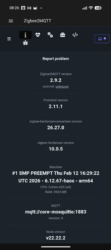

I think I’m good on both fronts?
Anything else I should look out for? I even restarted fully HA after activating the event option.
