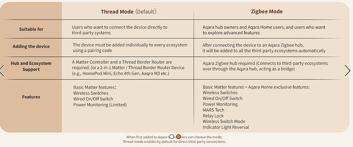

I’m using the switch in the bathroom, to control the light, when it is beyond the thresholds for the presence sensor. In the manual of the switch you can read in a table what is possible in matter mode and what in zigbee mode. So if you had read the manual you were not quit disappointed. If this behavior is some time changed by an update, nobody knows.

I have the latest manual (PDF) from Aqara webpage and there is no such table in it. Where did you find it?
I actually don’t find the manual… but on the seller pics it’s also documented. Here an example of the Amazon page:
This does not say anything about Home Assistant and zigbee2mqtt. It only says about features avaliable with Aqara hubs (zigbee/thread). Anyway, I reverted back to zigbee, as it has much more options in that mode avaliable via Home Assistant.
