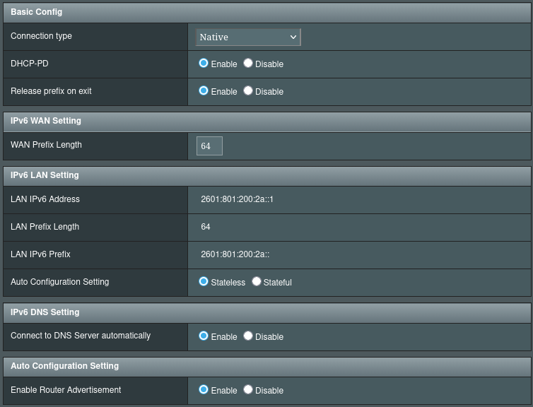

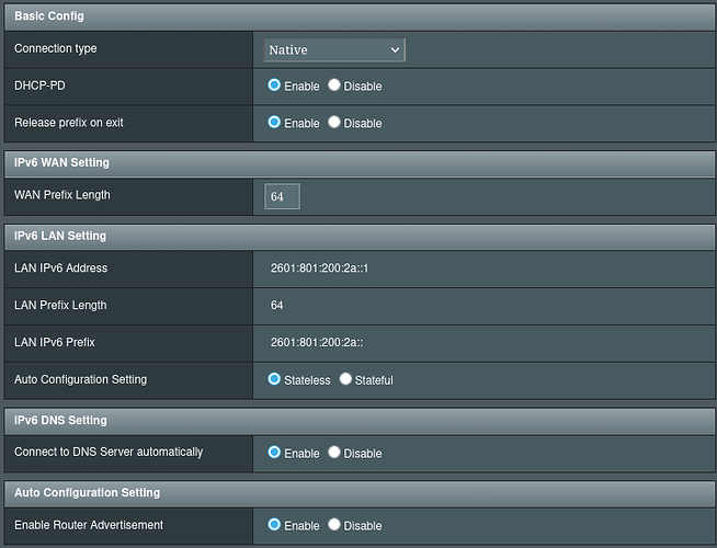

Are you able to share how you have configured IPv6 in your router? If you have DHCPv6 enabled, it is possible that the Aqara hub doesn’t support it (and only supports SLAAC-based IPv6 configuration). I don’t have an ASUS router to test on, so sharing the screenshots from there would be good.
If your network is using SLAAC, can you share the output of ip neigh - check this list to see if the MAC address of your Aqara hub is visible (there should be at least an IPv4 address visible; hopefully an IPv6 one too)
I believe I am running a SLAAC network. This is my current ipv6 config page:
I’ve also tried re-configuring to Stateful, but the results are the same.

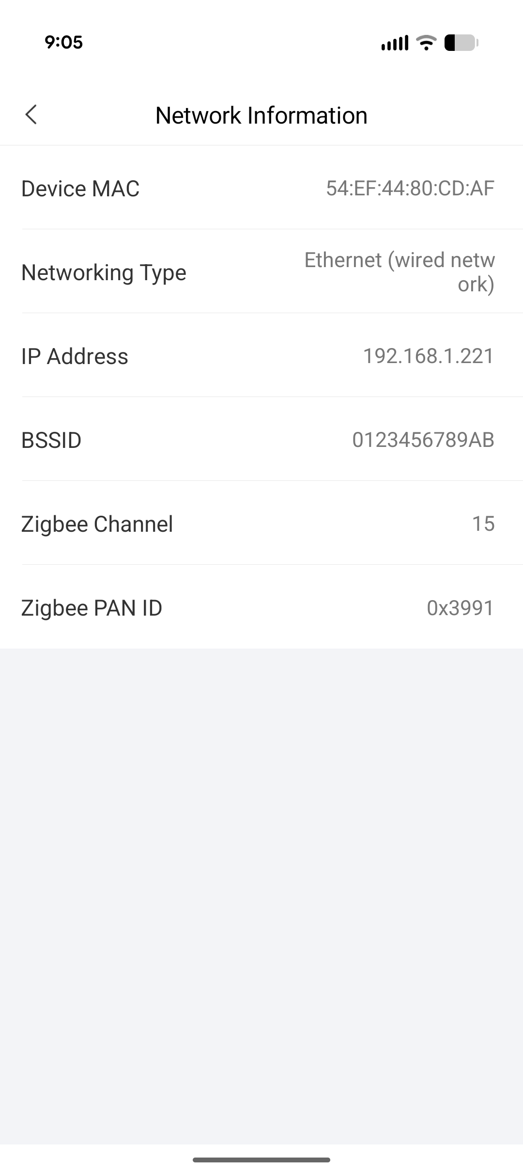

Probably a really silly suggestion, but have you connected to the hub with whatever Aqara’s app is and confirmed that IPv6 isn’t explicitly disabled in its network settings?
I think you are generally on the right track with this being an IPv6 issue, as it is required by the matter spec.

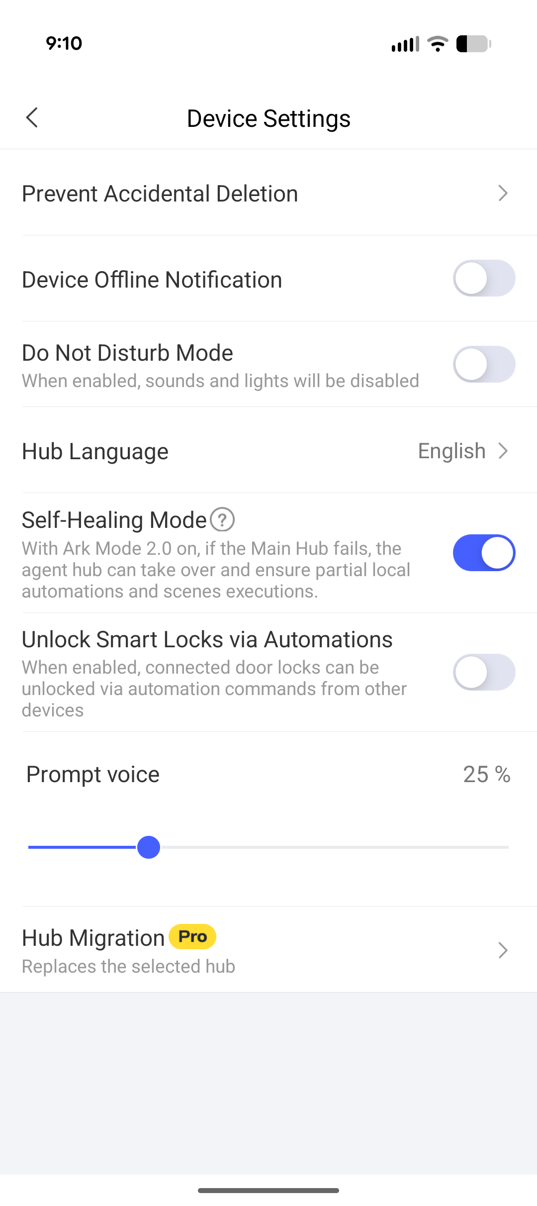

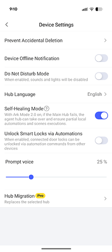

I can’t see anywhere in the device settings to turn on or off ipv6 (or really have any control over the networking):
