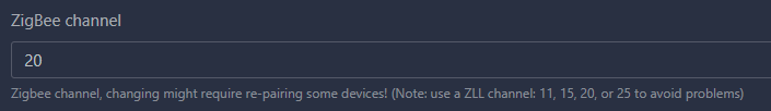

I moved to channel 20 in the Settings - Advanced screen in Z2M in order to avoid these issues:
I had to re-pair all my devices but it’s been working fine since.
