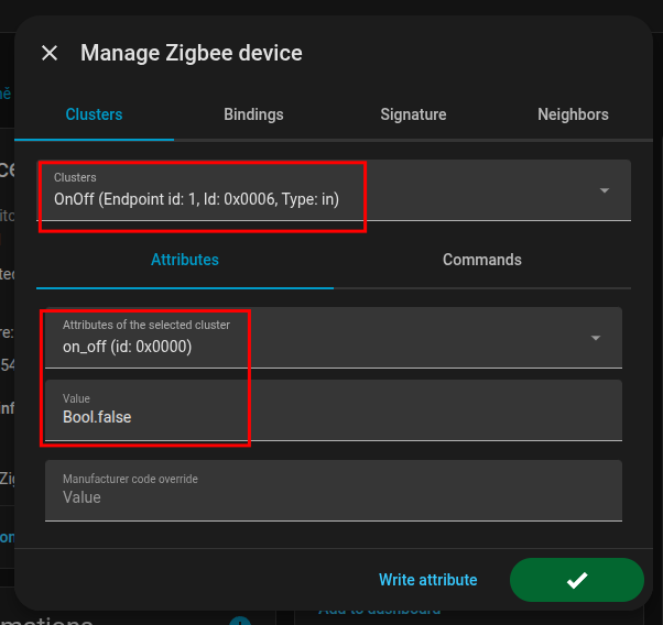

I have Aqara T1 switch and after I’ve turn off/on electricity for testing reasons, that Aqara is still OFF after power is up again.
I’ve this configuration in HA for this device:
and startup is ON.. but.. it fails somehow..
When I want to “rewrite” that values, it still uses same factory values.

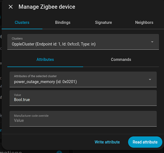

Here is the startup configuration:
As a workaround, I’m using some automation trigger to check state of that device each 15minutes if it’s up or not when electricity is up and running.

I've solved my issue "power_outage_memory" in "OppleCluster" is that option to be "true" if you want to device fully operational after electricity is up again
