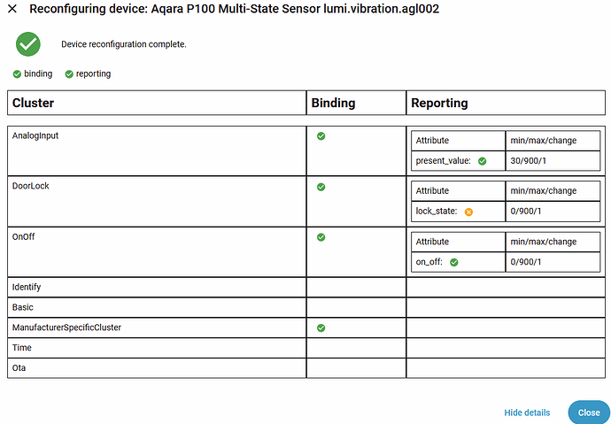

The P100 also has some strange values.
You need to install the custom quirk from Github. There is a PR for it to be added to HA but it hasn't been merged yet.
The P100 was only launched last month. It might take a while for someone to come up with a custom quirk for it to get it fully working in ZHA.
