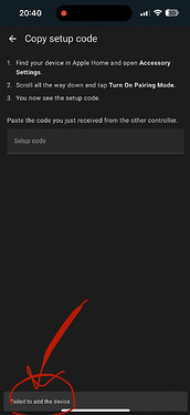

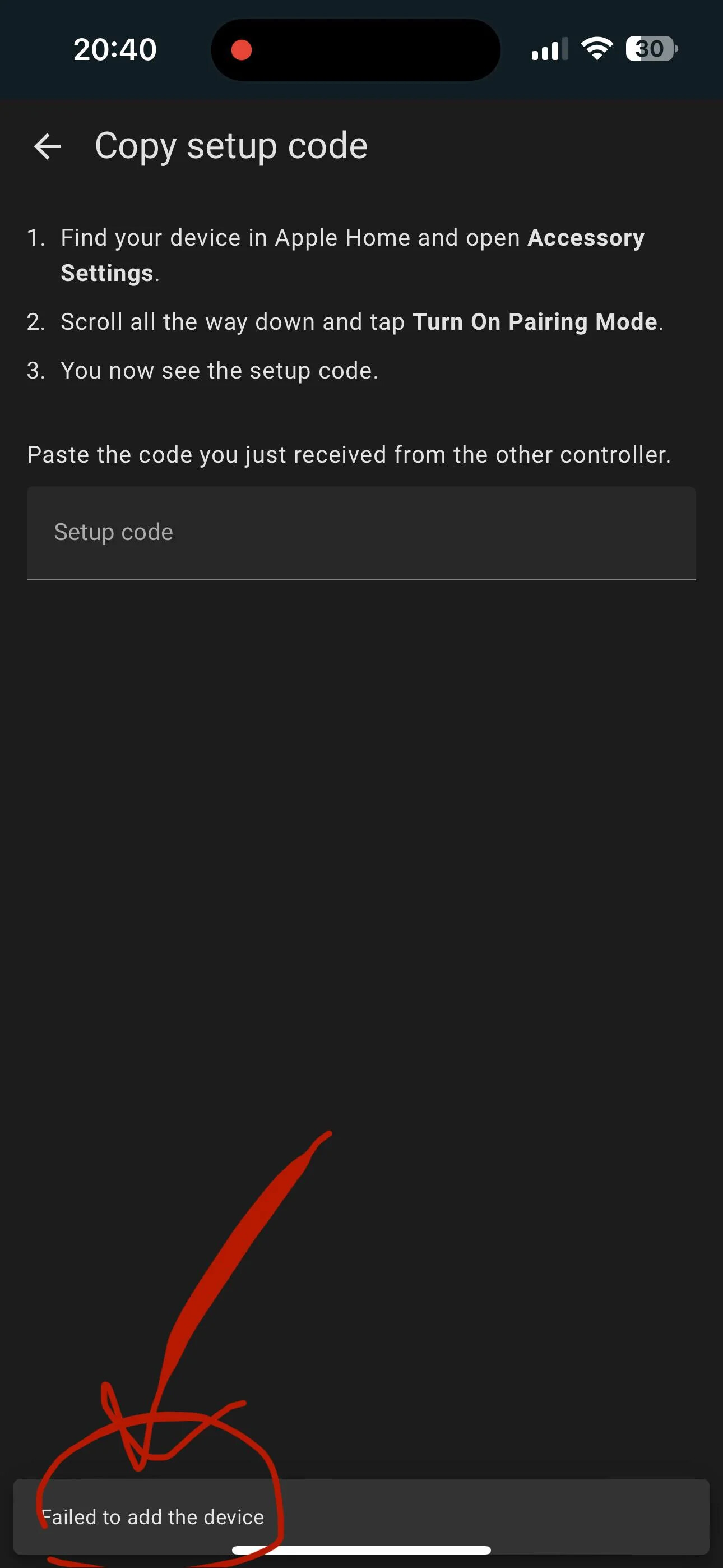

I did that but when i go to add the u200 i pick add an already paired matter device, put the pairing code, yet it never adds it, even though i added the m3 hub to my ha and have set it as the default thead network provider and sent the credentials to the phone. Did you do anything differently?
Had exactly the same problem for weeks with adding U200 to HA from Homekit.
Fixed by turning on IPv6 in Home Asssistant.
Same here, enabling ipv6 solved my resolved my issue after been chasing it for several days.

I finally got it to work after enabling IPV6, even though my apple tv is running wireless.
