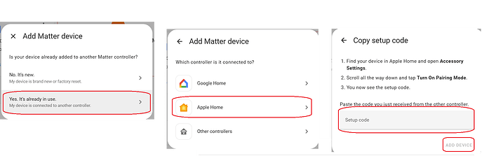

hi @macguy81,
I first added the lock to Apple Home
In Home assistant I simply enabled ipv6 as shown here:
Prior to that, I have configured Thread, where I selected my GoogleNest router as the preferred border router, because my AppleTVs are not powered on all the time.
Then I added a Matter device that already is in use, chose Apple Home, activated pairing mode in Apple home, copied the setup code, and connected successfully
Please let me know if you still need any further details.
/Ghassan

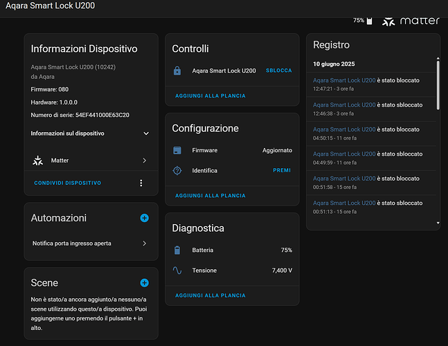

I can manage all features and states, wondering if there’s any way to read in HA the entire log of the u200 (actually does not, maybe matter limitation?)
Ciao Marco, could you specify what you mean by all features. I connected the lock through an Apple HomePod mini as TBR and I see only basic state log and battery info. No settings are available in HA.
Thanks!
Ciao Luca, this is what i can manage:
The u200 logs also show you who unlocked or locked the door if you set up fingerprints or codes for each person using it, but here inside HA/matter does not.
